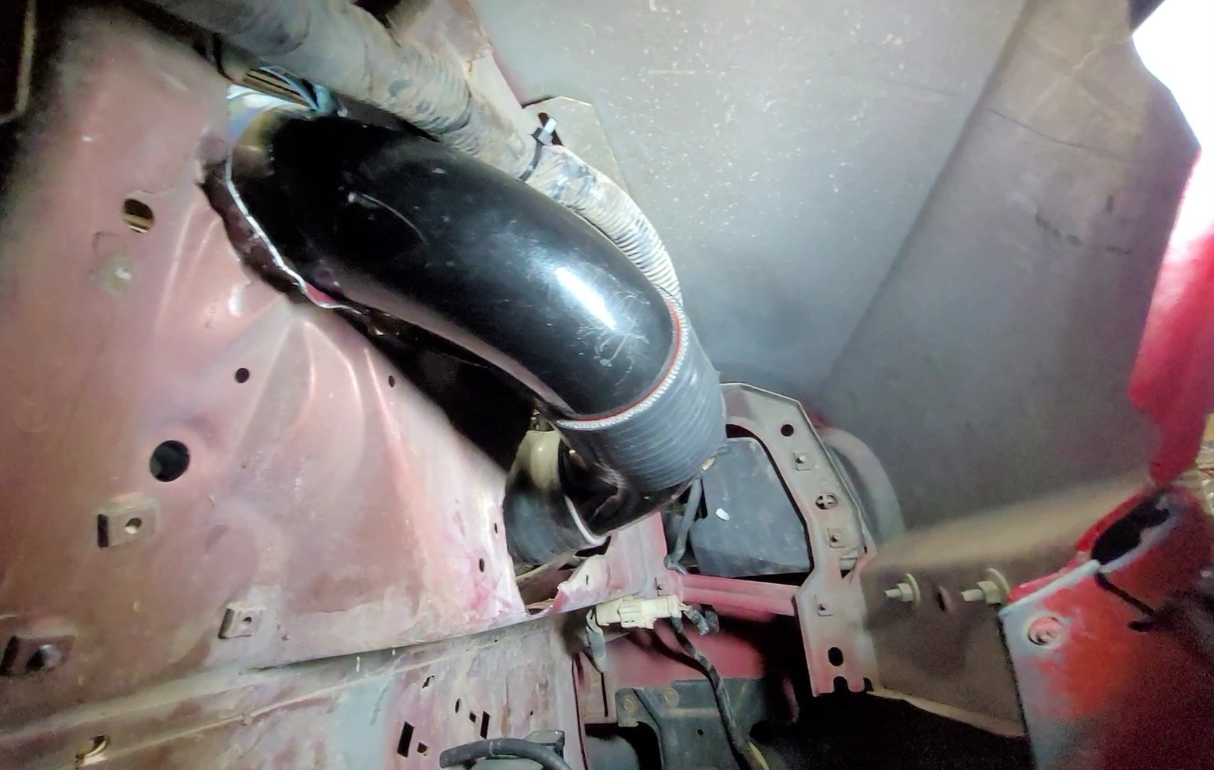

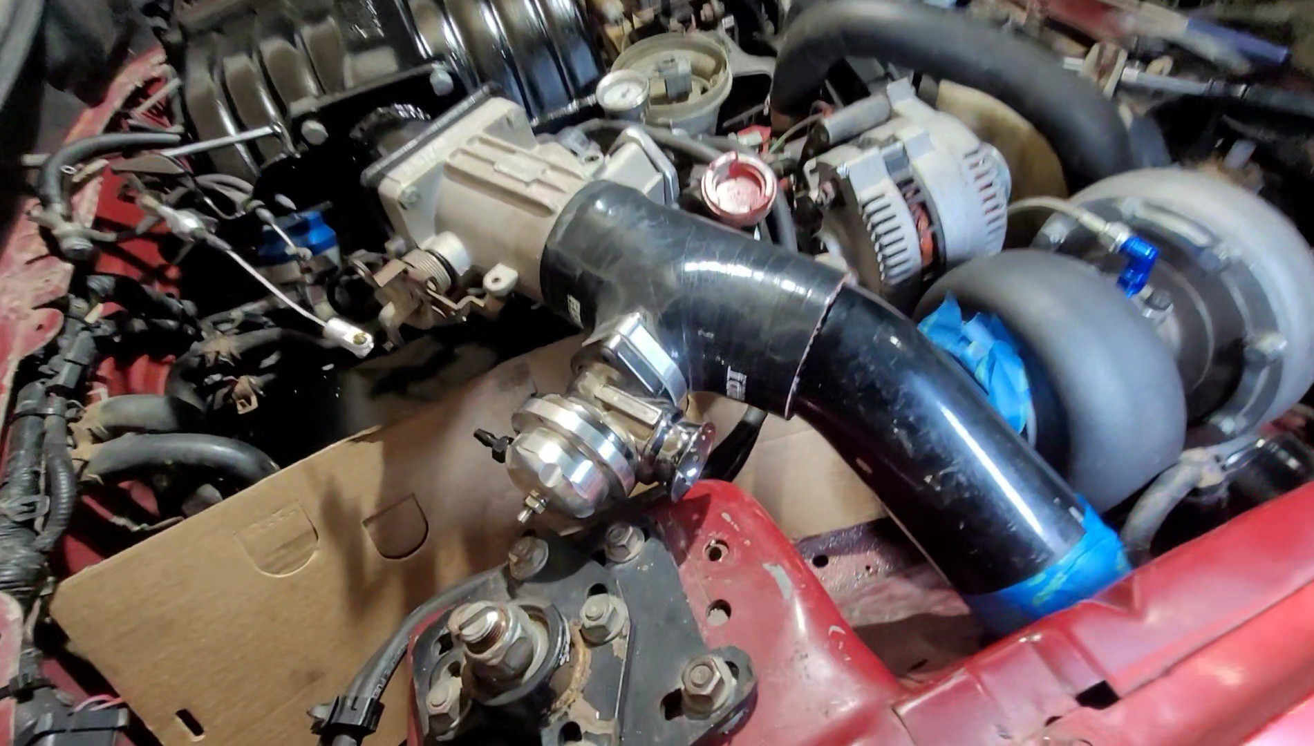

I think I have the intake piping sorta figured out. It might need a little more finagling but it's basically what I want. You might be wondering why I went through the trouble to go out the fender and then back in. I did it so we could more easily add an intercooler later. The holes are all cut, so we would just have to change the pipe routing a bit.

Found some more silicone elbows and pipe so I improved the charge pipe. I am much happier with this version.
This car has been a constant, do something, wait a day, and then change it.
