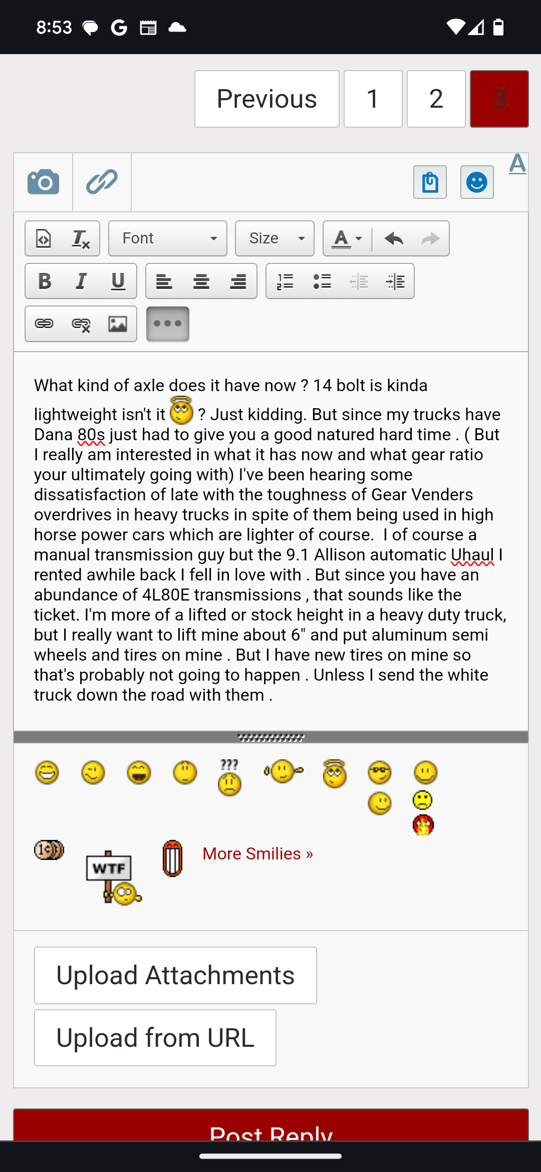

    Originally posted by Dan Barlow View Post
    ( screen shot of what I typed , then got an error code and it wouldn't post )
    first.... it's a Dana 70HD - and it's failing, so stop talking to me about the fail that seems to be Dana. I mean, you can spend a lot of money to have them fail less but if this issue was on a 14 bolt, I'd pull the pinion, reshim it and call it a day.
    ratios. I don't know, but I did notice that there is a speedo conversion on the transmission - so it's been changed guess, 4.56s
    the transmission dilemma. I do have an abundance of 4l80es - but - they require a computer to operate. Had I bought a 91, it would have come with a 4l80e (a junk one but that's a simple 'bolt in a newer, updated one' fix). So that leaves my options as
    1) 4L80e and a stand alone computer (or borrow the Meqasquirt stand alone I have for the Buick wagon - then put a terminator x in the Buick). Lowest cost ... probably. But it's cost would be a Terminator X - $1300 with all the frills.
    2) steal the 4L80e out of the motorhome - for all intents and purposes the motorhome is dead, right now it's just a tiny house but this would probably be the lowest cost because of the P30 chassis wiring. The trans works great, the motor is TBI - so that would leave 'dash' issues - and that could be solved with a Dakota Digital dash.... at $1300.
    3) Buy a gear vendor. They have a lifetime warranty - so I'm not sure about the bitching.... there is one available nearish for $1700
    the biggest problem with #1 is I have no idea which (if any) of my 4L80e transmissions are good. The 4x4 one from the H1 probably is good but it's a 4wd so would require making it 2 wd. I have the 2wd version in the Buick but I've never run it so have no idea if it works or not. The 2wd version I bought has a ear broken off - which I could ignore, but not sure I trust that it works (seems to be fine, but the guy selling it was the definition of sketchy).
    Or I just wait for my wife to hate the TR4060 in her Jeep then put that in my truck....
