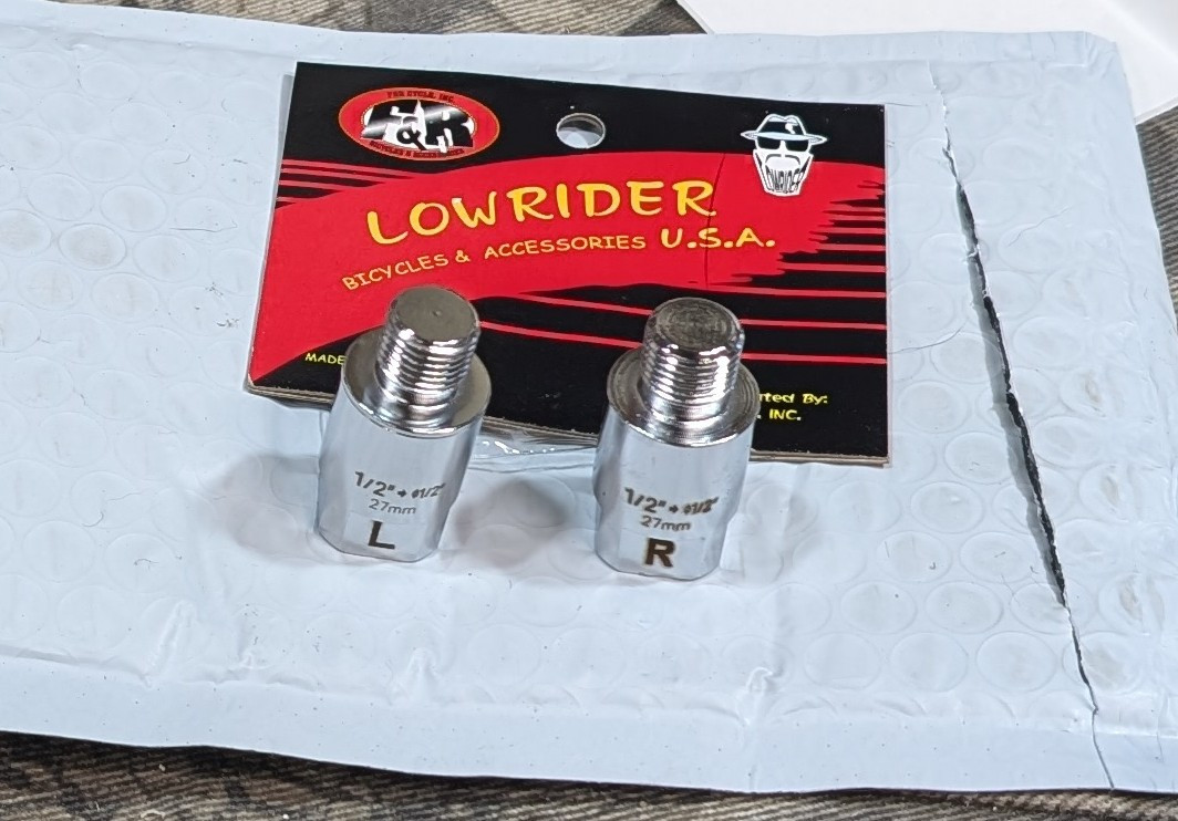

              Project Update ::::.....
              The solution for the pedals arrived a week ago.
              So today after Plowing out for 2 hours, I put the Pedal Extenders on, and then the pedals.
              Looks Good for a Engine Break Down back up plan!!

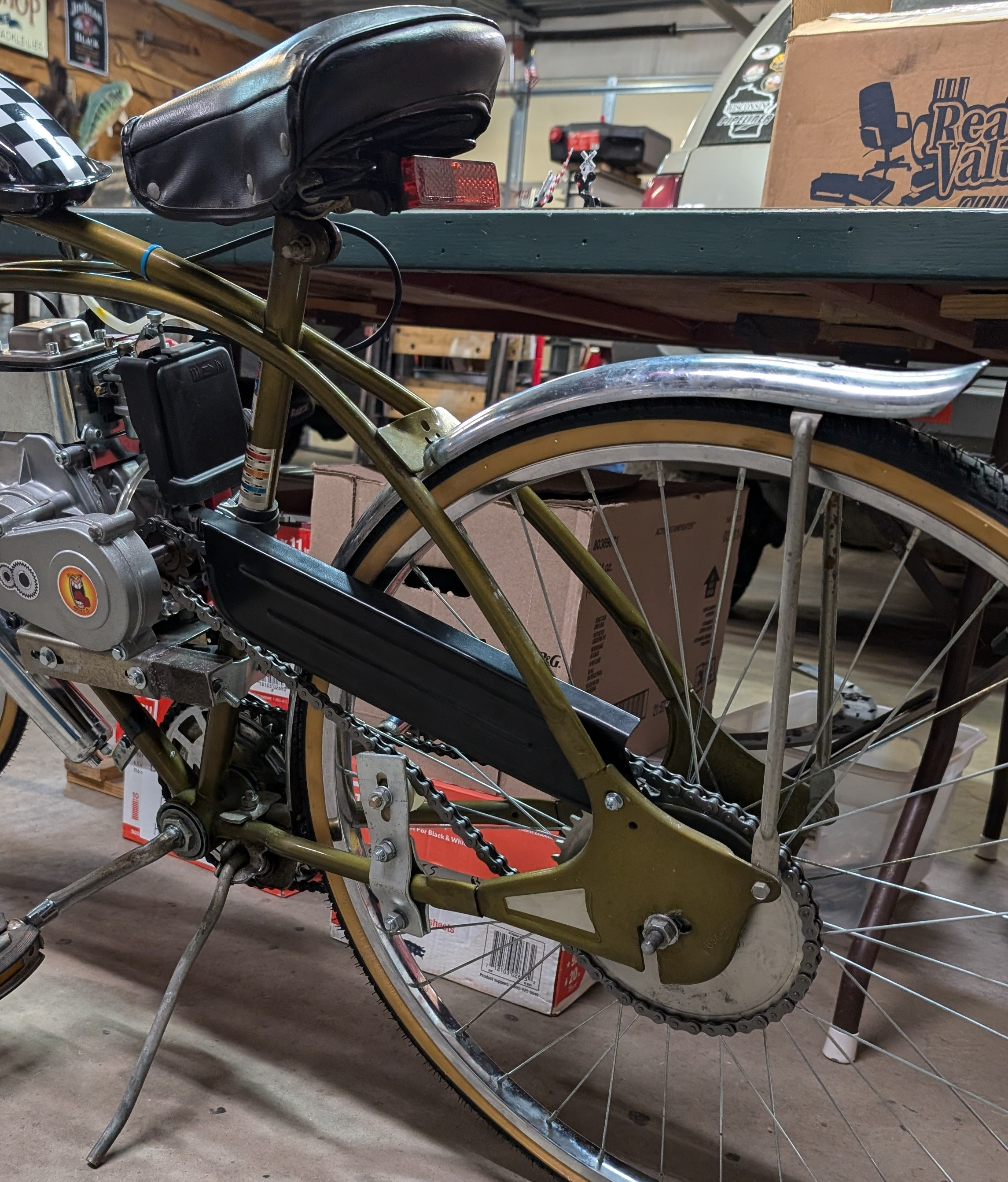

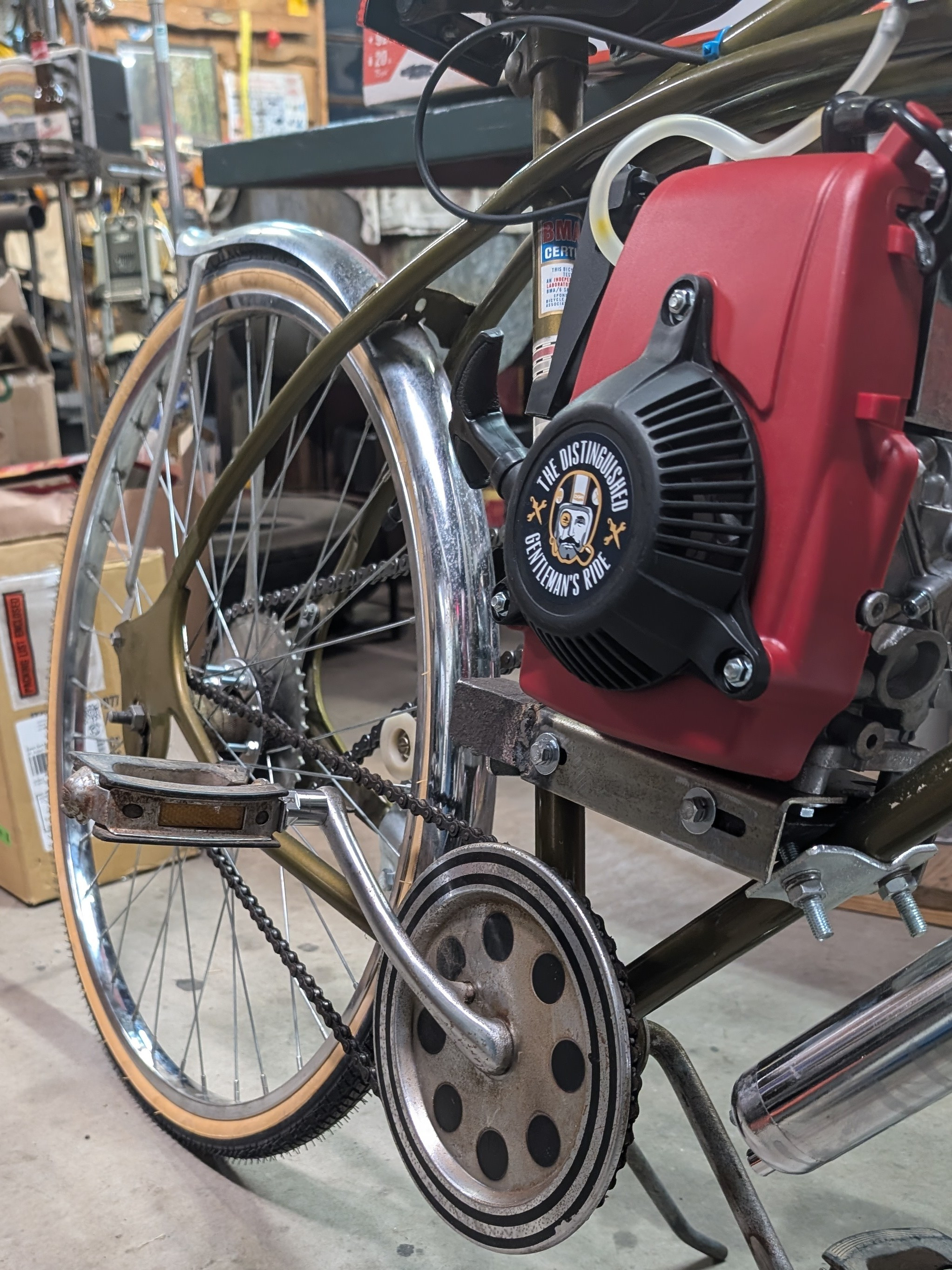

              Next was to put the Engine Drive Chain Guard on. The coaster brake, (that thingy that gave the modern bicycle the name - Safety Bikes) attachment screw was replaced with a longer one, for the rear, and in the Coffee Can NOS Parts supply, found a rubber coated clamp to attach the front to the Down Tube.

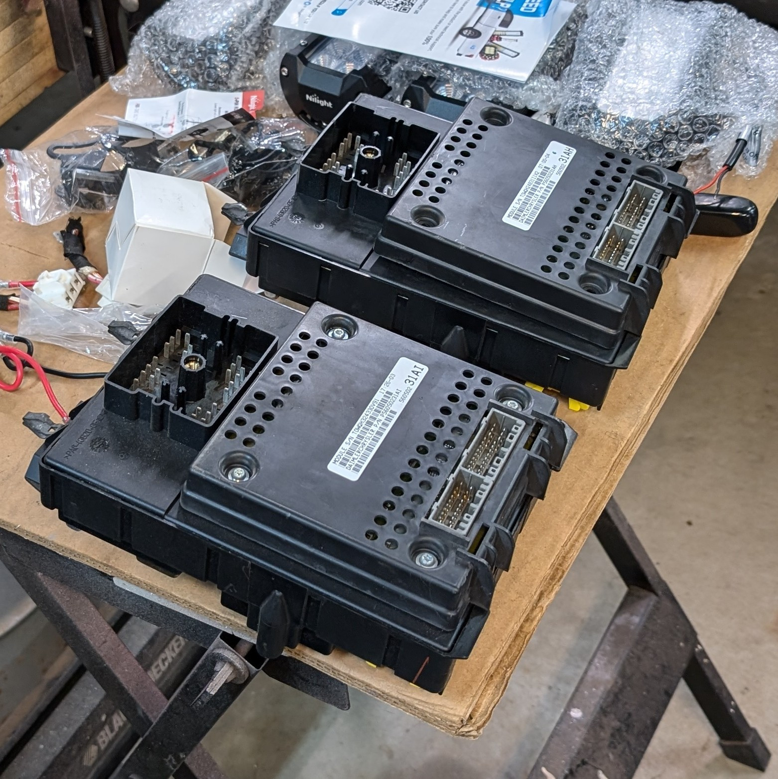

                              On the Grand Cherokee, the intermittent wipers are erratic, and won't park in any selection.
                              Per Interwebs sites, this is caused by the Body Control Module. So went and got one from a Pick A Part Yard. Check it out prior to removal. The replacement is on the Left.
                              You can just swap the Module that is attached to the back of the fuse box.
                              We decided to swap the entire unit just in case it is something in the rest of the assembly.
                              Click image for larger version  Name:	PXL_20241226_212336870~2.jpg Views:	0 Size:	668.7 KB ID:	1361670
                              This is Not As Bad as it LOOKS to do.
                              Yes you have to take all the Plastic Dash Parts off the Entire Bottom of the Driver's Side.
                              A little tight to get all the plugs out and 3 are 10mm socket size bolts fastened.
