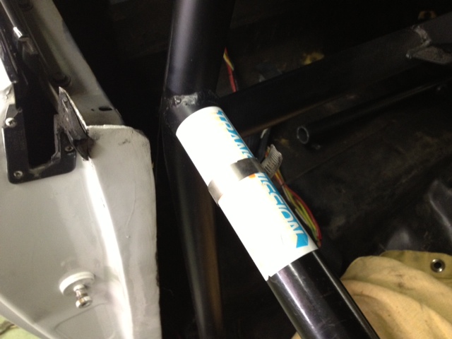

  • First I measured off per instructions to make sure I had plenty of room without dragging my back across the stubs after the bars are cut ... and then marked them w/a hose clamp to get the cut as straight as possible ...

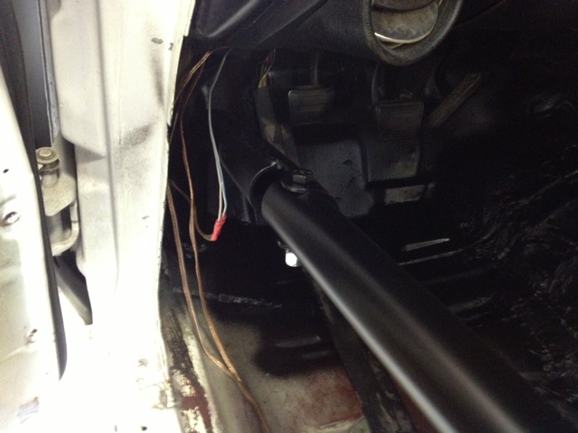

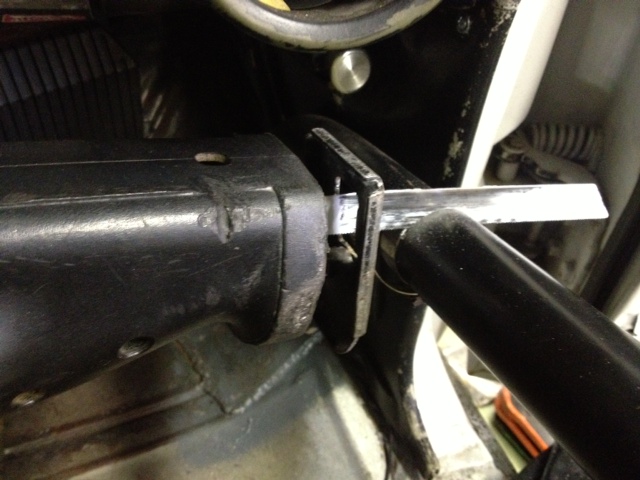

    Then out comes the trusty sawzall. It makes for a cleaner, less fiery cut ...
    And viola .... side bars are out ...

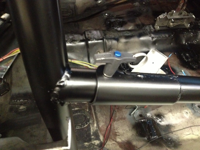

              Swing-outs are DONE! I re-painted the entire roll bar w/VHT epoxy chassis paint, it made it look brand new. Here is the pin side
              And the hinge side
              I should have some time tomorrow to start putting everything back together.

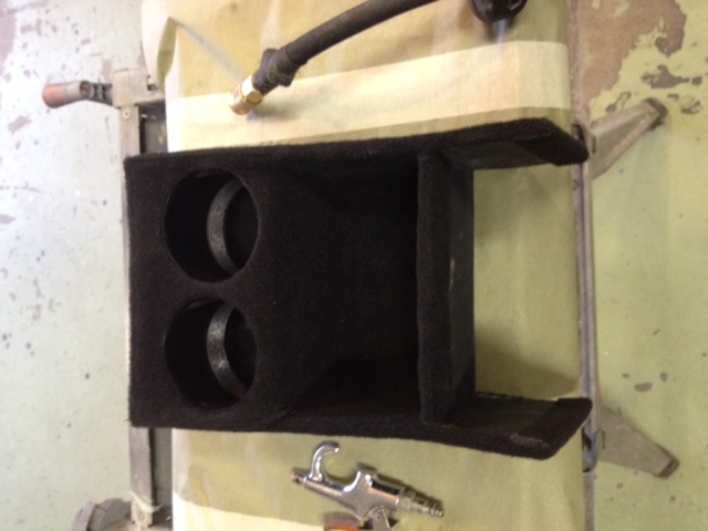

                      • Here it is after 2 coats/layers of 'glass, using a flannel bed sheet as the material. I did use a coat of bondo too, just to smooth out the rough spots so the carpet will glue down smooth.

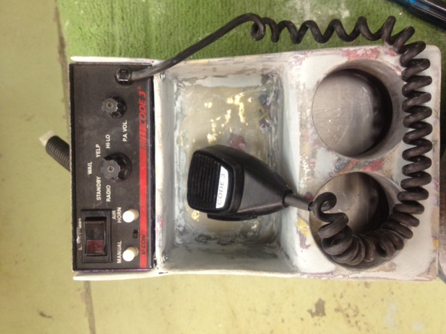

                        • Mmmmm CB radio.
                          • I'm jealous already.
                            • Originally posted by Scott Liggett View Post
                              Mmmmm CB radio.
                              That's actually the emergency lights controller and siren/air horn/PA driver.... left over from the car's Race-A-Cop days.
                              No need to be jealous Randal, it's actually quite easy. I might also try making a form out of PVC, and glassing over it .... my son turned me on to that since he started sword fighting. These kids use PVC for everything and then glass over it .... pretty cool IMO. Shields, swords, armor .... you name it and they can come up with a way to make it.

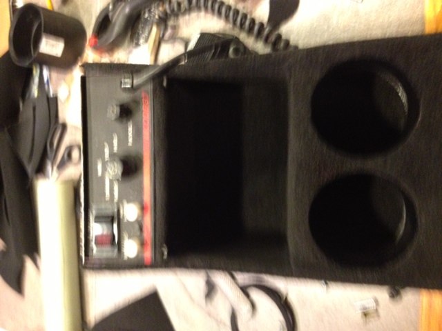

                              • Almost there ..... all of the material is cut/stitched and glued on. I won't lie and say it was a breeze. It took 2 attempts at making cardboard templates for the material, and once those were where I liked them I started cutting material. Well, I actually had to cut the material 3 times before I was able to get a decent fit that I liked. Anyway, on to the pics ... last one is a bit outta focus ... dam iphone
                                I'll get it installed in the car today and wrap this thing up.
