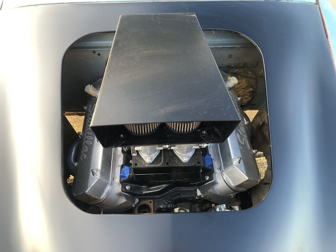

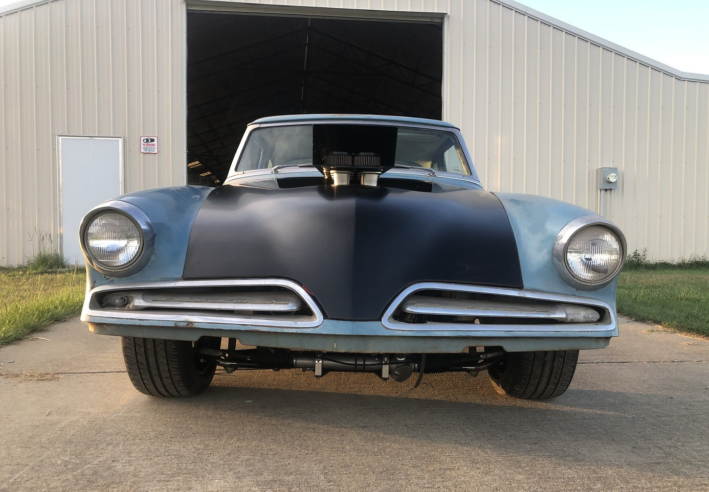

ID:	1320956 I've made a lot of progress on the suspension and figured out a few things I did wrong the last time. I just got home from being gone for 4 weeks and I worked on suspension design for 2-3 hours almost every night. I will get into details of that later, but for now wanted to share some pics. It's so hot in MS these days that it's going to be difficult to spend time in the shop for the next couple months. My wife helped me get the front cap and hood set in place for these pics before it was all blown apart again. I have sold the Cadillac engine and am at a crossroads. We are leaning toward something more dependable. My heart is being pulled all over the place, but I have some ideas. Could it really not be a Studillac? More on that later as well. It was now or a ways into the future on getting pics with the engine. These are the first ones I have with the hood and engine fully together! We worked into the night and it's all blown back apart and the engine is ready for transport. It's headed to Kansas.

                    Here's a stance comparison. Doesn't look 2" lower but it is in the front! I'm really liking how she sits now. The updated suspension is about 1/4" narrower on each side to help with fender clearance while turning. If need the fender lip could be dropped just a hair and flared to get the fit to perfectly match the rear but I can't see it being much better!
                    I could slightly raise the rear but am already at 2.6-degree rake. I love the hot rod stance but don't want to go too far.
