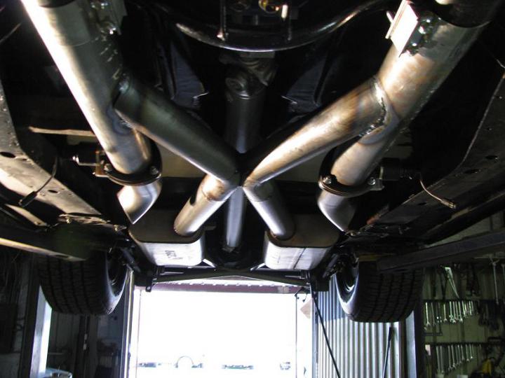

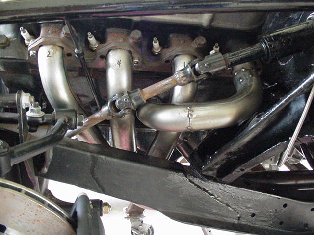

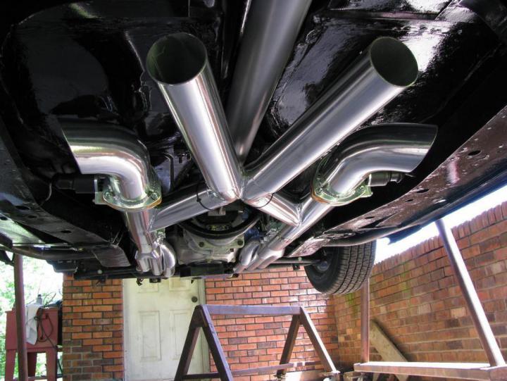

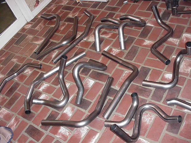

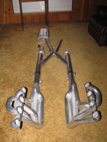

              After the suspension was finished and the mock-up engine in place, it was time to figure out what
              to do about headers. The car had Sanderson block hugger headers with 1 7/8" tubes, but these
              short headers probably didn't do much for horsepower. The car also had a full 3" crush-bent exhaust
              to the bumper with a crossover pipe and Flowmaster mufflers. This system was ok, but there was
              a lot of resonance at highway speeds. Potter thought I needed to build a set of 2" or even some that
              stepped up to 2 1/8" mid way to the collectors. I had read all I could find on the net and purchased
              a header guide from Headers by Ed. Ultimately I decided to build a set of 2" x 2 1/8" stepped headers
              with a 3 1/2" collector. I purchased some J bends and a box of bend mistakes from Stahl headers to
              see what I could come up with. My header flanges are 3/8" laser cut from Torque Inc., and are made
              so that the 2" pipes will slide right in with only a little corner work needed afterwards. I drug my feet
              for several months trying to get the courage to get started as I had never attempted anything quite
              as complicated as a set of headers on my own before. From early on I had wanted to have an exhaust
              cut-out at the back of the front fenders, but as much as I wanted that in the end I wasn't sure I would
              pull it off. There's another item to regret because it would have been just one more notch cooler. I
              also really want the car to cackle without being unbearable at cruising speeds. The overdrive trans
              and tall tires should make noticeable differences in the noise level. But I still wouldn?t mind if it made
              a baby cry when I drove by! (That's actually a goal of mine, lol) I started by locating my collectors
              even with the bottom of the frame rails so nothing would hang down to be seen or scrub. To do this
              I had to move the collectors back beside the transmission, which made for a couple long tubes but I
              figured they needed to fit more than they needed to be equal length! I went out 14"-15" from the
              flange with 2" and stepped up to 2 1/8" for the rest of the way to the collector. After a couple tubes
              I was in a groove and they kinda just went together. The hardest part was convincing myself to get
              started! The headers and complete exhaust turned out great and I'm pretty proud of that... One
              unique aspect of the headers is the way three tubes from each side are paralled to bottom of frame
              with one tube from each side looping up behind the flywheel housing and into the collector. That tube
              ended up about 42" long on each side but the rest are between 36" and 38" total. Potter asked me
              if I could change to 32" primaries, lol, wasn't gonna happen! I figured I had about 80 hours total in
              fitting, cutting, welding and grinding to make these headers.
              I them came straight off the collectors thru QTP 3 1/2" electric cutouts to dump the open exhaust
              when needed. The 3" exhaust system Y'd off the collector extensions into an X pipe configuration
              and then into a pair of Dynomax Ultra-Flows. In order to route the exhaust like I wanted and maximize
              ground clearance, the rear foot-wells were replaced with flat sheetmetal. Going over the rear axle
              with mandrel bends also required a little to be cut from the trunk floor. After finished I then carried
              the entire exhaust and headers to Jet Hot in Pascagoula, MS (they've since moved to the midwest)
              for some of their sterling silver ceramic coating. It all looks awesome and I can't wait to hear it fire
              up! I hope I like the mufflers because it'd just mess things up to change them now!
              I used copper gaskets with stainless nord-lock washers on the header bolts which should make for
              leak and trouble free system. I also used the wide band clamps at each connection on the exhaust.
              A friend of mine used them on his Camaro with great success. Was too easy with no flanges...

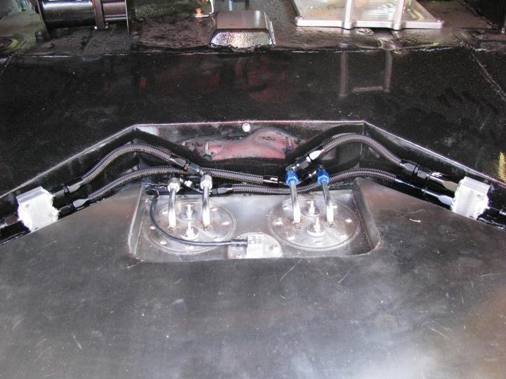

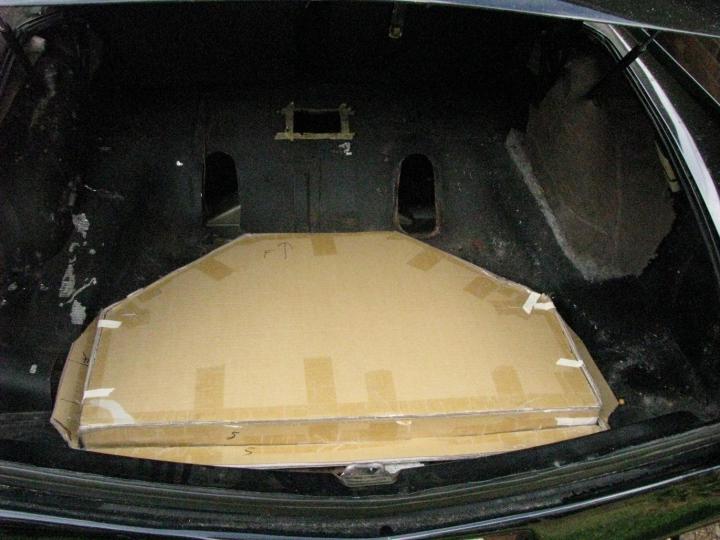

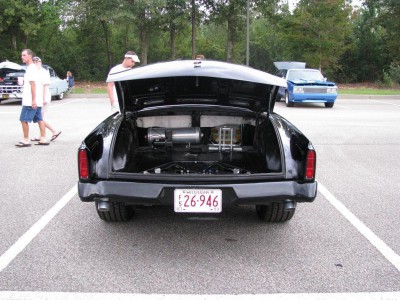

                        Yet another thing that drove me nuts about this car was the fuel tank. Supposedly the stock
                        pancake of a tank held 16 gallons. Funny that I could run out of gas and it only hold 10? And
                        it would stumble when going up a hill with less than a half tank. I think the pickup was broken
                        off inside the tank and the outlet was at the front so gas was always being push away... Well
                        that wasn't gonna be acceptable and I needed more fuel for cruising range. I had already went
                        the fuel cell in trunk route before and wanted something nicer for this car. But I didn't want the
                        tank hanging down and being too visible from the rear either. I have a friend into Mustangs
                        and noticed the way the tank bolted into the trunk floor so I devised a plan. I cut out the trunk
                        floor and made a cardboard mock up giving plenty of exhaust clearance and getting the proper
                        rear site line. Using that shape I determined how tall it needed to be to give me 20 gallons of
                        usable fuel. I also wanted to retain the stock filler location. I needed to protrude into the trunk
                        about 2" to satisfy my demands. With carpet the new tank will be easily hidden. I almost forgot
                        about the trunk floor. Since I cut away the center and needed some clearance for the exhaust a
                        new section of trunk floor was fabbed to fit around both. I also had to add a small bump to clear
                        the center link of the rear suspension when fully bottomed out.

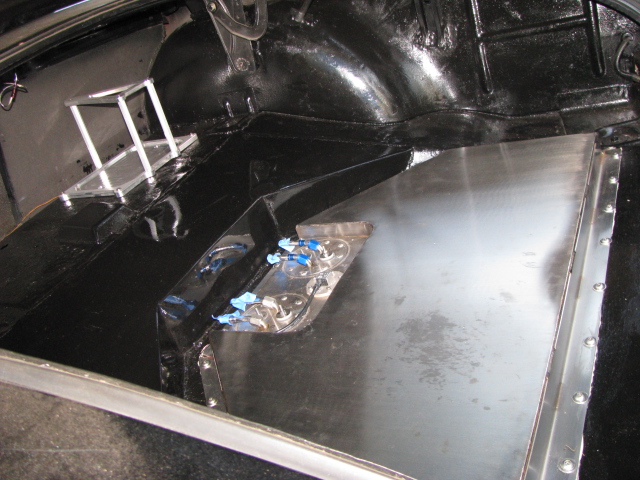

                        With the fuel tank shape taken care of I had to decide on what to do about a fuel pump. I was
                        intrigued with what I saw from Tanks...
                        Tanks, Inc. manufactures fuel system components and polyethylene, steel and stainless steel gas tanks for street rods and special interest vehicles.
                        I purchased a pair of them to try. Yes a pair because they are only rated at 500 hp each! After
                        I received them I tried to make them fit my design but ultimately decided not to use the complete
                        assembly but was going to use the pumps. The other option was perhaps one big Aeromotive
                        pump but am thinking that I can stage the second pump on with an RPM switch and if my primary
                        pump ever gives up the ghost I can just swap wires and still make it home on the secondary pump.

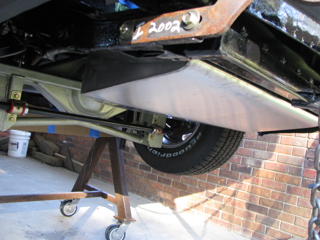

                        I let a guy talk me into building the tank out of aluminum. Big mistake, well it wouldn't have been
                        if he had followed thru with what he had told me. "Don't worry I will weld it" and about 3 months
                        later I gathered up my parts and tried to find another welder. For some reason TIG welders are
                        rare in rural MS. I ran across another fellow who said they could weld it and he made about 6" of
                        weld and it wasn't pretty. So I took the warped up pieces home, sucked up my pride and called
                        Ricks. I sent them drawings of my tank and even the fuel pumps I already had and they delivered.
                        The only thing they didn't do that I requested was a drain plug in the bottom. I'll manage without
                        that... One bad thing about the SS tank is that it weighs 70 lbs! At least the weight is in a good place.
                        Notice the receiver hitch, its there when I need it tucked behind the tag...

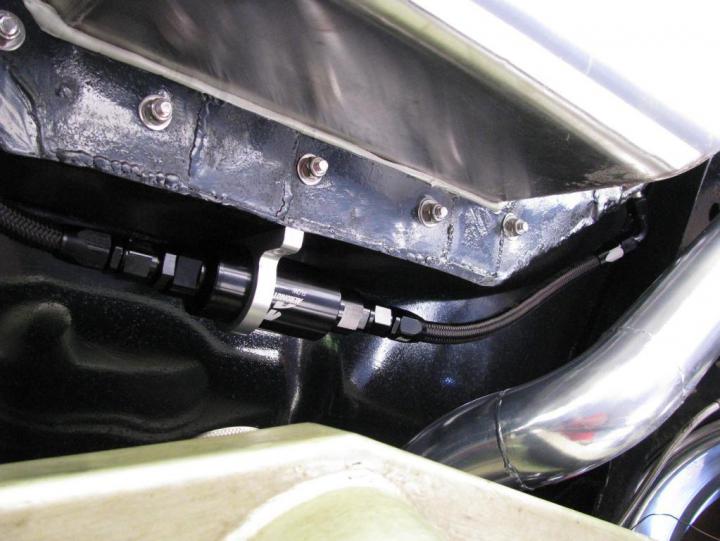

                        With two fuel pumps in my trunk, trying to keep the plumbing neat proved to be another challenge.
                        I needed to tee together the pressure and return lines at the tank and then split the line back to
                        each fuel rail at the engine. Yes she is fuel injected but that will be another post! The available Ys
                        just didn't fit my vision so I designed some fuel Ys that keep the lines parallel while using straight
                        hose ends and less angle than the 45 deg Ys offered. -6 lines come from the pumps and thru one of
                        my Ys into -8 lines to the engine. Just in front of the door on the driver side is another Y to split with
                        a pair of -8 lines to the fuel rail along with a pressure sensor the the gage. For filters each pump has
                        a sock on the suction and I have a 10 micron Aeromotive filter in the pressure line. One thing to note
                        is initially I purchased 20' of Earls Pro 350 black nylon braided hose. After using all of it, I decided to
                        try the Summit brand instead as it was considerably cheaper. Not saying it isn't good stuff but the
                        Summit hose is definitely lighter and more flexible. I'll stick with the Earls hose in the future, but I like
                        the Summit hose ends. Time will tell...

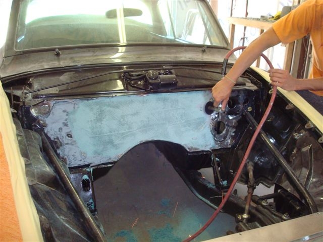

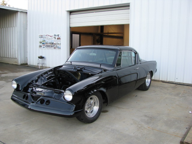

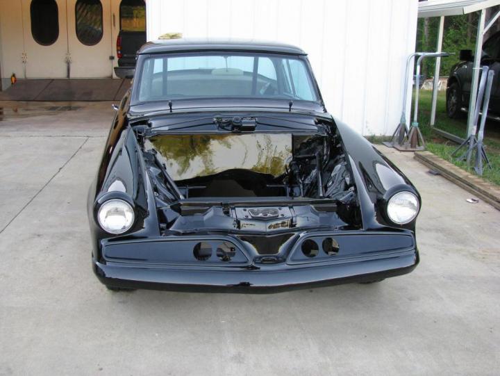

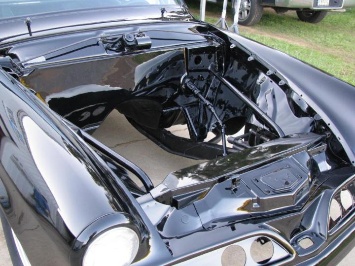

                            With the engine out a few unnecessary holes were welded shut and the firewall modified to properly
                            secure the steering column and hydroboost, the firewall needed some re-smoothing. A plate had
                            already been welded in to smooth the firewall by the previous builder but it wasn't very flat. I also
                            added some down tubes from the firewall to the front frame horns hoping to stiffen the frame some
                            and add a race car vibe to the build. I took the car to Mike Goldman Customs in Meridian, MS. They
                            re-smothed the firewall, made some custom aluminum inner fender covers and mounted the radiator.
                            And speaking of radiator, I went all out making the frame horns wider to accept a custom Ron Davis
                            dual pass radiator built to my specs with dual 14" Spal fans. After finishing some other details the car
                            was taken to Manning's Paint and Body in Noxapater, MS to spray some glossy black on the firewall
                            and repair the ramp damage on the front bumper.
                            Dwayne
