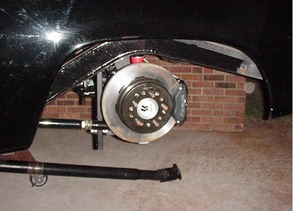

            The next item that needed changing was the rear suspension and tire combo. For the same reasons as
            not cutting the firewall I didnt want to chop on the wheeltubs or floors too much but I wanted as large
            a rear tire was would fit in the stock wheel wells. I also wanted a 3" exhaust to the back bumper so I had
            to keep that in mind while changing the suspension. Originally the dream was C4 suspension but the
            reality plan was to keep it simple. So after a lot of measuring and CAD time I developed a 3 link rear
            suspension that mounts 285-60-16 tires on 16x9.5 rims in the wheel wells with ample clearance. The
            rims I chose are appropriately American Racing Salt Flat Specials with 15x6 used on the front. I have
            retained the stock frame rails, just replacing the rear shock crossmember with a heavier shockwave
            crossmember. I decided on the shockwaves after seeing how much the car sagged in the back with
            passengers and having plans for pulling a small trailer and toting luggage on the Power Tour. I ordered
            the wheels and tires and positioned them in place to measure for the braced Strange 9". My suspension
            uses BMR adjustable lower control arms for the 4th gen Camaro along with a custom wishbone single
            top arm that should allow for axle pivot but retain the axle side to side so I won't need a panhard bar.
            I also built a rear adjustable anti-roll bar so the suspension can be pre-loaded as needed to keep the
            car going straight when I finally make it to a track. We'll just have to see how it works when I finally
            drive the car...
            And yes if you haven't noticed I am building this car with minimal tools under an open carport...
            Whatever it takes man!
            Dwayne
            ps. Thanks Sean, nice to be among friends over here already!

                          While I was reworking the axles I decided to go ahead and upgrade the brakes. The front set-up is a
                          4 piston Wilwood with an 11.75" rotor to clear the small front rims. Would have been nice to have some
                          17 or 18 choices in the Salt Flat Specials but I am pretty sure braking is gonna be nice. On the rear I may
                          have messed up! I put a 12.19" Wilwood rotor with internal parking brakes since I had the larger 16" rear
                          rims. I wasn't thinking ahead to running drag radials. I hope I can find some rims to clear these rotors in
                          15" so I can have a good choice in tires. I like a tall tire and all the larger rim options seem short... Maybe
                          if need be someone will trade me for some 11.75 rotors and caliper brackets? I wont race it much but
                          when I do I will definitely need a good sticky tire.
