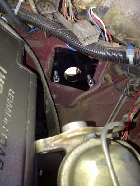

Started the manual brake conversion today. I pulled the booster out (had to remove the valve cover to get it out!) And bolted the adapter plate in. That's as far as I was able to get today. Looks like I will need to make all new lines from the mc because I do not think these will come close to reaching.
I decided to go ahead and replace the master cylinder since I was going to have to make new lines. The common swap is to put a manual brake master from a Ranger on it. This flips the lines to fender side keeping them well away from the headers. At $12.99 + core from OReilly I though it a wise investment.
