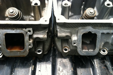

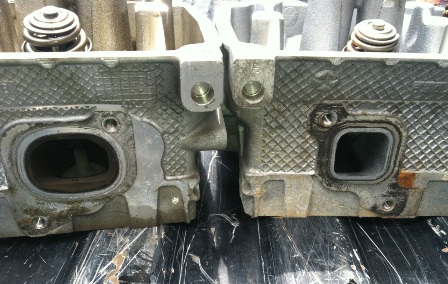

neat stuff. I can see why you want the later heads. Chrysler did something similar with the very early hemis, frist couple years they had round intake ports, then they widened them a lot. Looks like the Eagle has a lot more spring in it too

These are from a Car Craft article.
5.7 Hemi Flow Chart
Lift Intake CFM Exhaust CFM I/E Percentage
0.100 71 38 54
0.200 168 109 65
0.300 239 163 68
0.400 270 180 67
0.500 284 183 64
0.600 285 185 65
0.650 285 186 65
5.7L Eagle Flow Chart
0.100 82 45 55
0.200 175 110 63
0.300 243 160 66
0.400 300 180 60
0.500 323 181 56
0.600 331 183 55
0.650 331 186 56
Cleaned up ports on either can boost those numbers a bit. I have seen the small port heads right at 300cfm with very minimal work. For comparison, my TFS BB heads flow 344 at 0.600" and 350 at 0.700". The Eagles move A LOT more from 0.100"-0.400" and essentially the same at 0.500".Life is short. Be a do'er and not a shoulda done'er.

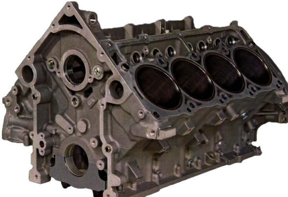

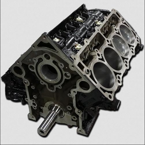

Really really really thinking about turboing this thing. That would allow me to build a pretty mild engine that encourages me to drive it around more and then unleash the PAH when I go to the track.
Early 5.7L block
Short intake Muscle Motors intake with efi or maybe the 6.1L intake so I can go back to a flat hood. <-- kinda like that idea.
PWR crank kit:
-Mopar 6.1L OEM Crankshaft
-Manley 6.240" H-Beam Rods
-ARP2000 Rod Bolts
-Wiseco Pistons (3.917, 3.922, 3.937)
-Wiseco GFX Steel Rings
*Some* camshaft, probably pretty mild because 10.00 is as fast as this thing can legally run, but would not mind being able to click off a 9 every now and again.
76 or 80mm turbo - Probably a CX Racing turbo.
air to air intercooler
4l80E - with manual shift conversion
My buddy John Turpen's 9.2x sec 76mm turbo Mustang really opened my eyes as to how you can have the best of both worlds with turbos. That car is about as unassuming as they get.Life is short. Be a do'er and not a shoulda done'er.
