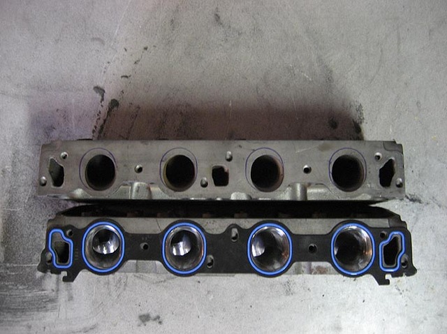

                        Going to pick up a machined 460 block this evening. It was bored 60 over (4.42" bore) by a reputable shop here in town. It popped up on craigslist for $100 with a timing cover and a set of rods. Guy had it done, then lost interest in the project. Figured if nothing else, I could use it to build an engine for the pickup. But, seeing that 2 replacement pistons for the 545 cost over half what a new set of 8 cost, I might just buy the new set and build a 552 to replace the 545. I'm working on a possible cylinder head change to a set of ported Cobra Jet A-429's too. A-429's are similar to the TFS heads I have now in that they use the same studs, springs, valves,rockers, guide plates, etc. However they have CJ/SCJ sized intake ports and are preferred by many for 500+ inch engines.
                        Standard port vs. CJ/SCJ
                        It's crazy how all these options and changes just started popping up. lol Now to see if they all pan out!
