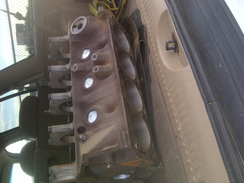

GoodOriginally posted by BBR View Post60 over, align honed, new cam bearings and corE plugs. Pretty much. Ready to clean up and start building. Came with a set of resized stock rods and a clean timing cover. Phone won't let me insert the image. Boo.

Might stick a good mic in it and see if they're close enough for the new pistons? When I had mine bored I took all the slugs down there so he measure them up and get the clearance right for them (forged).Last edited by Beagle; October 19, 2014, 09:56 AM.Flying south, with a flock of bird dogs.Comment
Haha I know. It was one of those CL ad's that didn't have a pic and just a few words and a phone number. Took a shot and called it.
