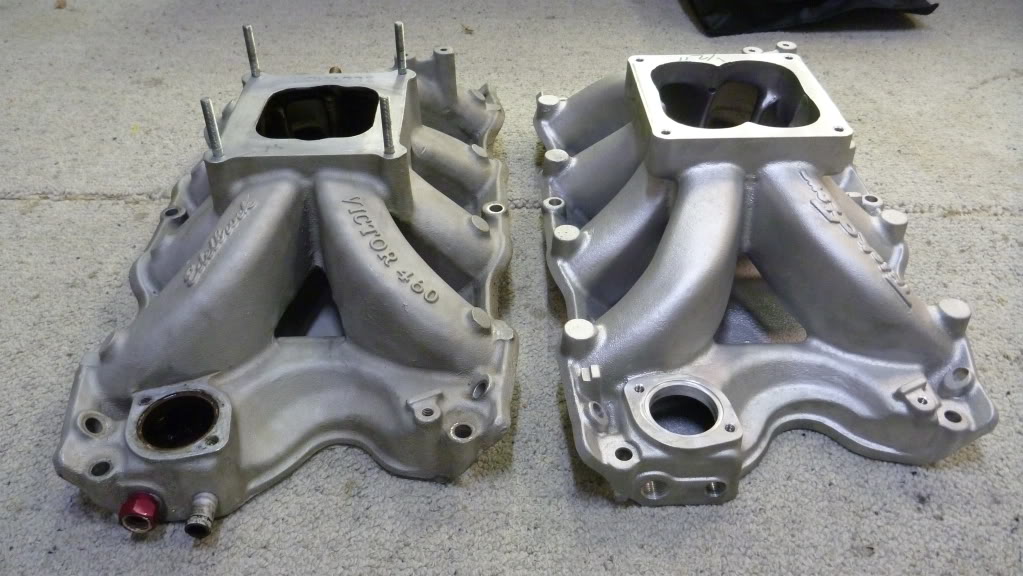

    #3031
    Bill, I ask because I want to learn, how else but from someone like you..
    Something was nigging me about mismatched ports and pretty sure it was better one way than the other..
    More of some interference that helps swirling effect, keeping fuel suspended for better burning of the fuel..
    Too much is not as good as a little.. Some locals claimed gasket matching both intake and heads made big differences, but I felt they lost a little driveability. Possibly they set their timing a tad differently on reassembly.. I don't know..
    I'll take your 2 cents to the bank any day!

      I am going to run it like it is for now mainly because:
      1.) It's what I have.
      2.) From what I have read recently, the TFS intakes are back ordered.
      3.) The TFS is taller than the Victor and clearance to the new cowl hood is still a big question mark.
      It would be a lot of fun to get some runs in with the Victor, then swap to the TFS and see if there is a marked difference.

        Only thing I really see as an issue (considering the intake/exhaust ratio) is port velocity.
        Some epoxy could address that. Works on 500 Cadillac heads.

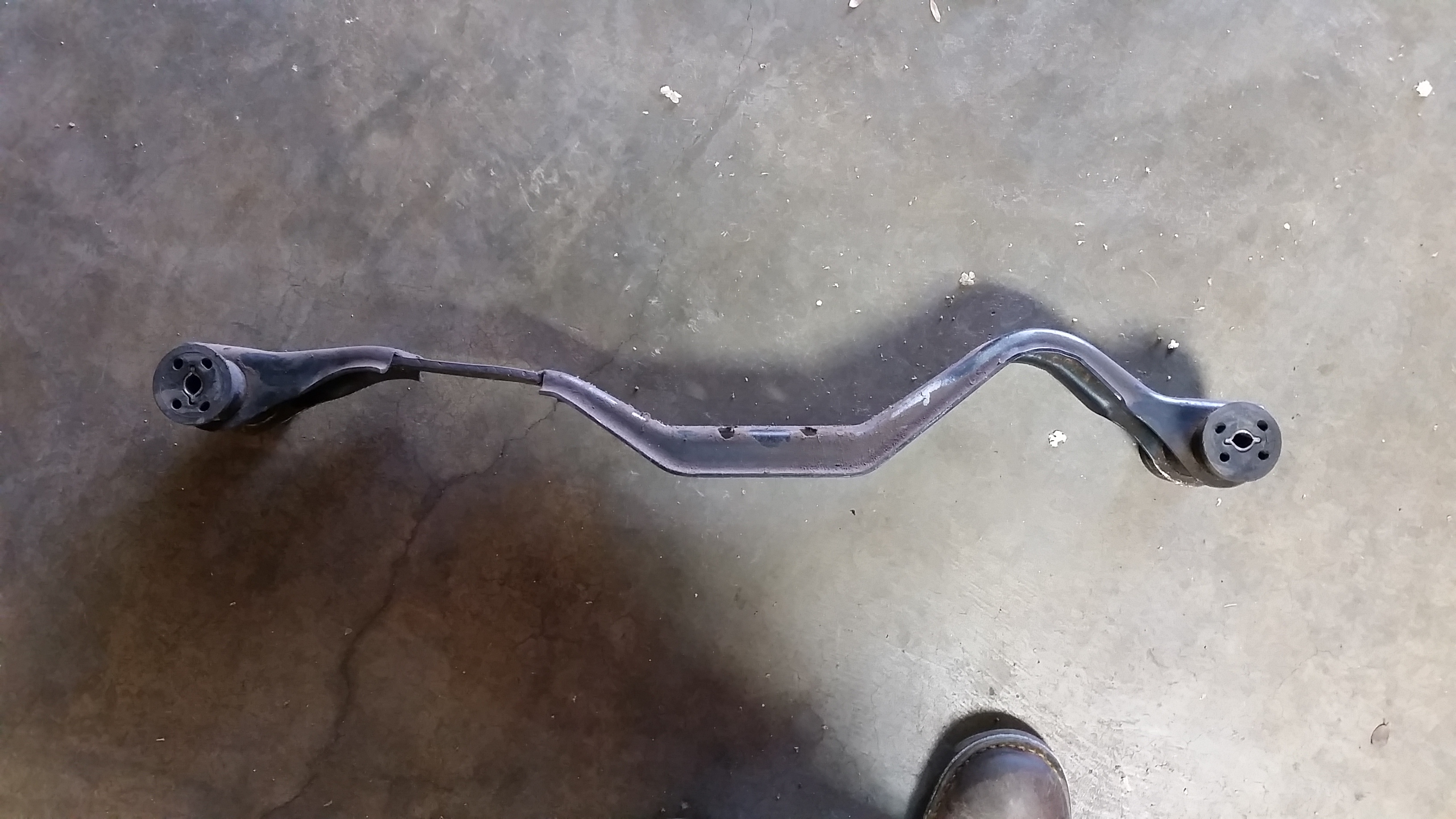

              So while it is wet outside, I am trying to get everything else done that does not actually involve the car. One of the major things has been a transmission mount. The old mount needed to be modified to clear the headers and subsequently I was never real happy with how I did it. I have played with bending some tubing to fabricate a new one.
              Old mount. It ended up being a little too flexible.

              Current thought process. I have a new bar bent up that mimics the old one, but it seems a little ridiculous to bend a bar 5 times when I could bend one twice and make some nice brackets that sandwich the floor pan near the stock mounts. The pic below is not my car, it is how another guy took 2 stock cross members and made one with 2 big humps.

                That's a lot of epoxy! Gasoline with ethanol not hurt it?
                Ummmm.....good question. This one was race gas only at 12.5-1 compression.

                On topic, I like the other thought. Mimic the teamz with a section of channel or such welded in the middle.
                Or find another single hump and make one of those high-hump custom models. That is slick!

                  Cleveland heads are famous for epoxy jobs too, or "port plates" which I guess work pretty good.
                  KISS applies - run with what you have - it's still going to be barrel of monkeys fun and fast, if the miss match was the other way, it would be a shame, as is - RUN IT.

                      I really like the 2=1 double hump trans crossmember idea. They can't be that hard to find, eh?
                        Me too. There's one for 20.00 south of Austin on CL ... maybe he'll ship?
                        Can you weld a couple angle iron or beam to the top of the old one and strengthen it up?
