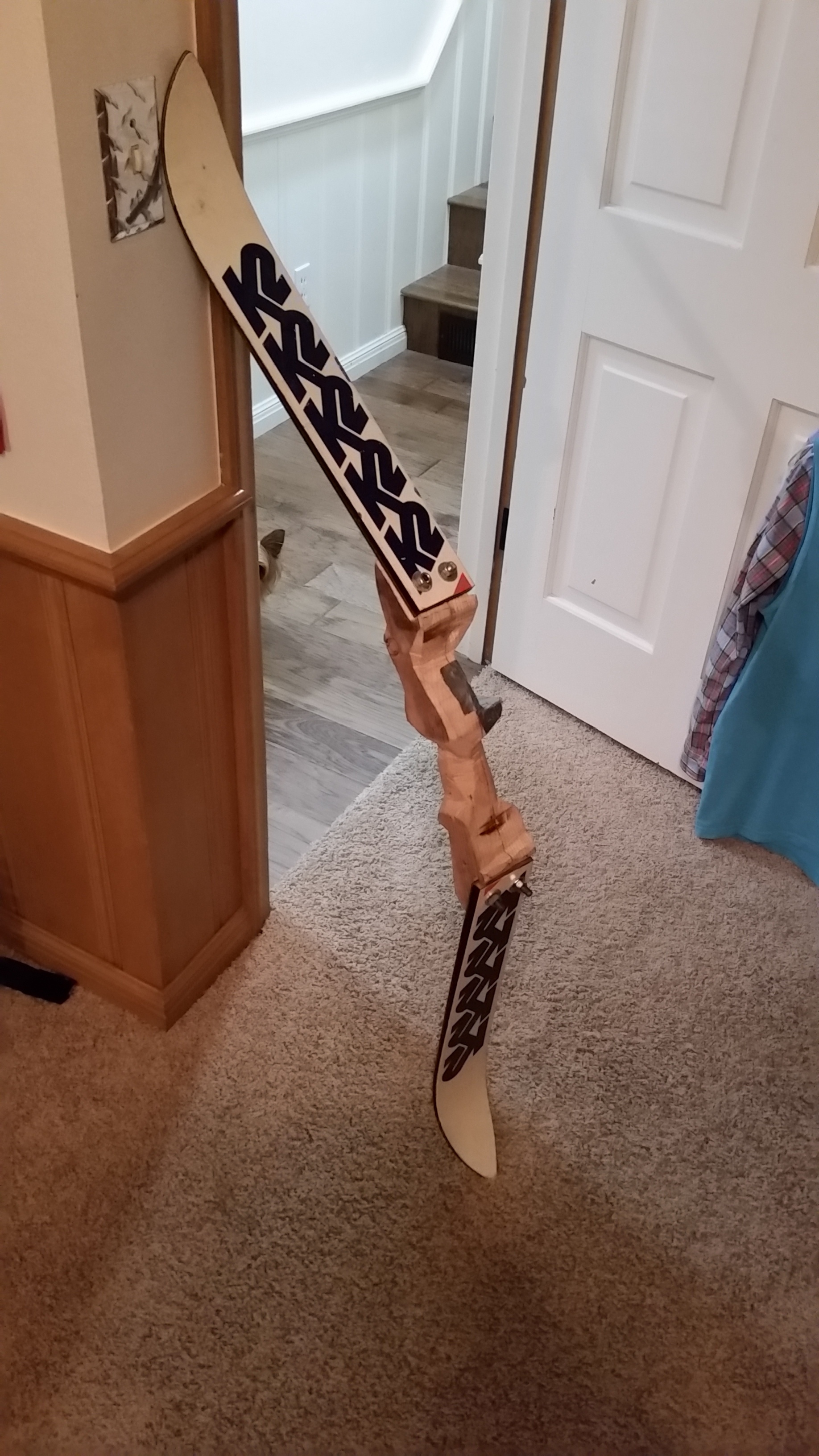

Now..... my other son. (14) Jake and Judd are completely different. Judd wants to do what I am doing, Jake wants me to do what he is doing. lol When Judd and I started working on the car, Jake decided to build a bow. lol His first attempt was good, but the 'wings' (part of an old wooden crutch) proved too weak and cracked. This spawned an internet search and ultimately, version 2.0. It is still a little rough, but he plans to work on it more today.
lol I knew the old K2 Hawks would come in handy some day, just never guessed they would become a bow.Last edited by BBR; July 2, 2015, 05:58 AM.Life is short. Be a do'er and not a shoulda done'er.

Passing on the knowledge, passion and busted knuckles to the next generation is as good as it gets. That bow will throw an arrow though a cinder block if he can draw it.Last edited by CDMBill; July 3, 2015, 07:40 PM. Reason: Because they should learn how to spell good twoDrag Week 2006 & 2012 - Winner Street Race Big Block Naturally Aspirated - R/U 2007 Broke DW '05 and Drag Weekend '15 Coincidence?Comment
Wonder of wonders, the bow actually works pretty good.
