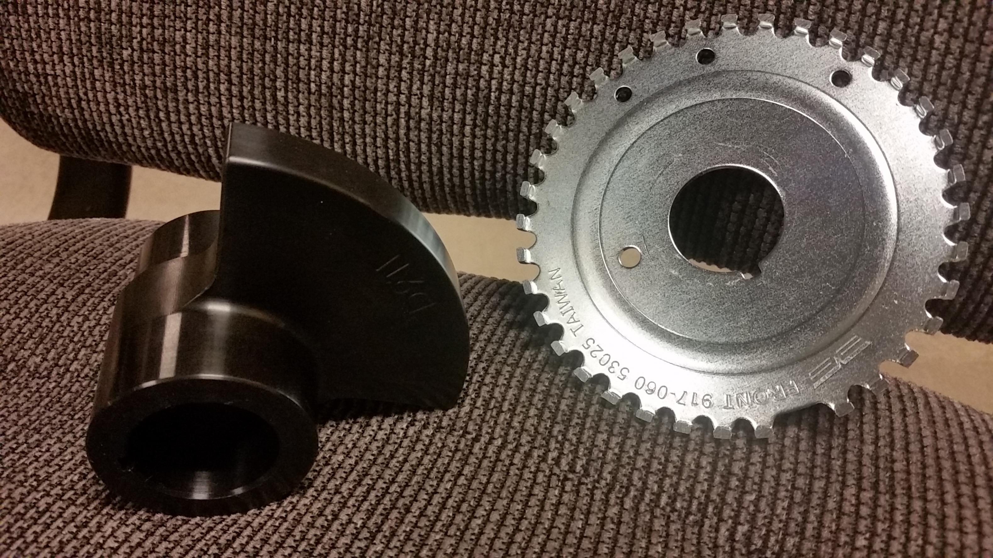

2 more pieces to the Megasquirt ignition puzzle. Ford 4.6L 36-1 wheel and a new billet hatchet weight/balancer spacer. I plan on attaching the wheel to the spacer to provide a crank signal for the ignition. The stock hatchet is rough cast and would most likely need to have some machine work done. This one should be good to go as is.
I had a little free time so I worked a little on the 36-1 wheel stuff this weekend. The hole in the wheel is 1.25" and the step on the balancer measured out to 1.908".

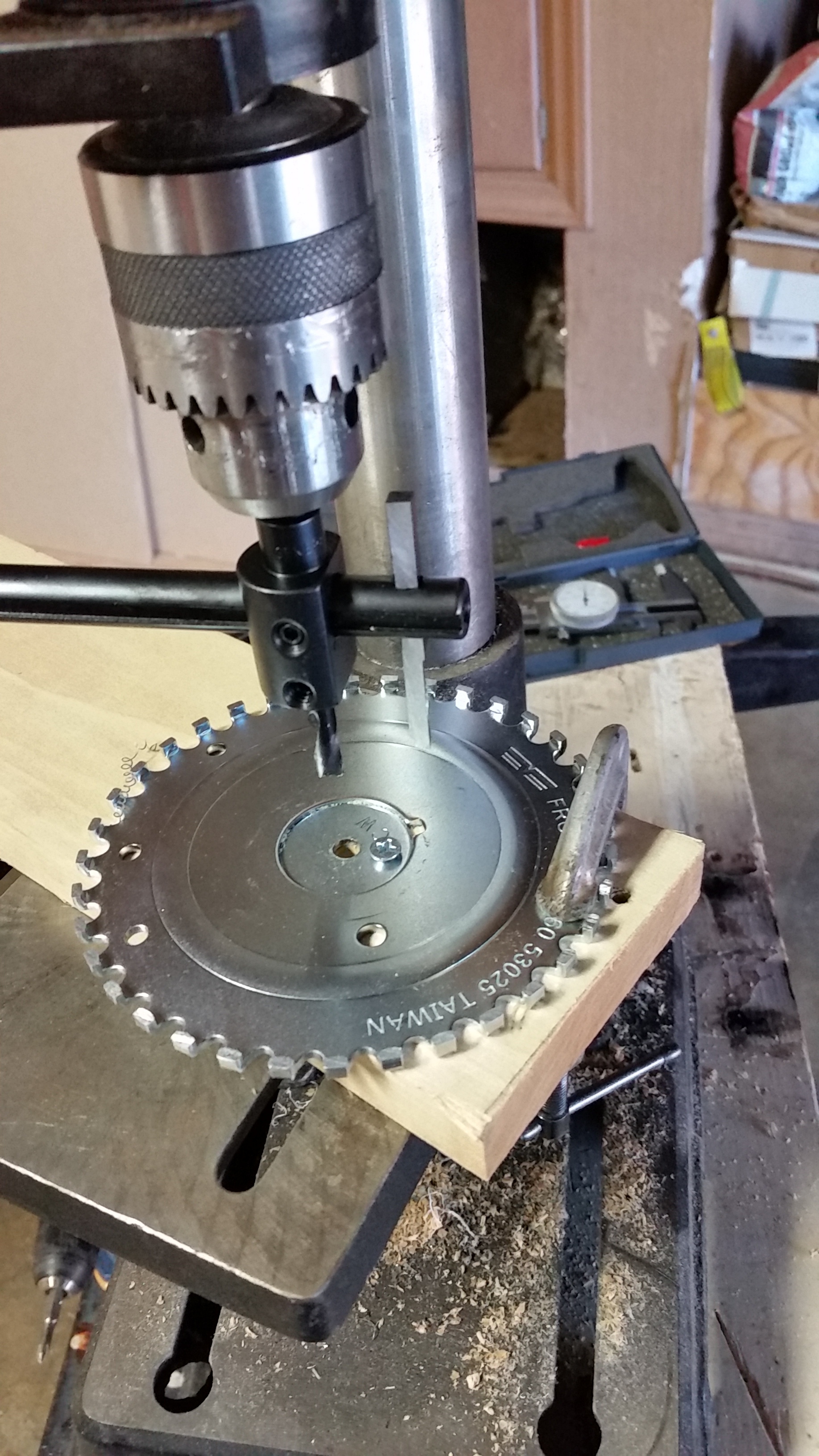

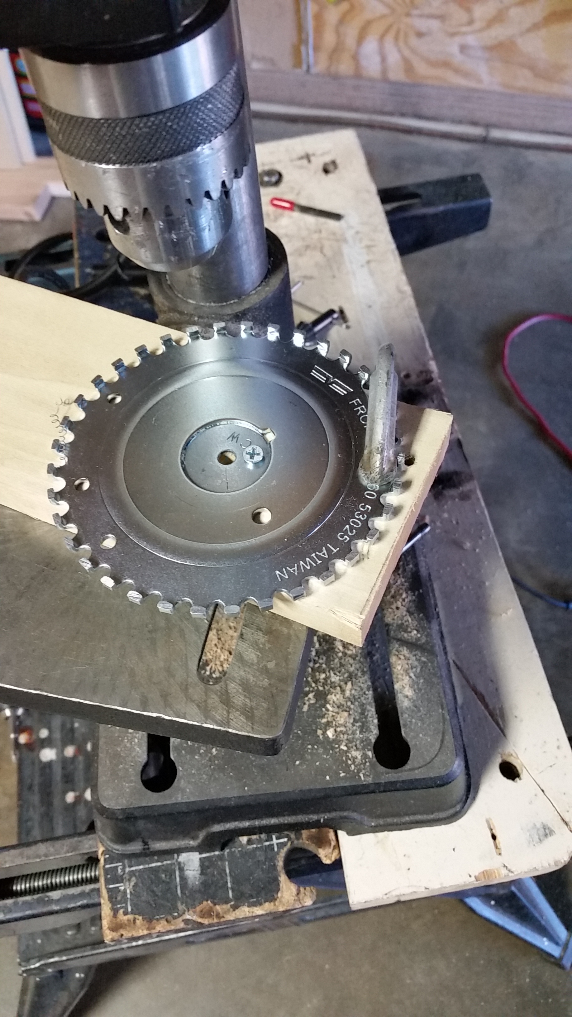

I needed a pilot so I took a 1.25" washer, drilled a hole in it and screwed it to a piece of wood. Then I clamped the wheel to the wood.
I thought a circle cutter would be the way to go. It said you could cut metal with it...... not so much. It scribed a nice groove then snapped the tip off.
Plan B was to go get a 1-7/8" hole saw at Lowes which worked great. I figured I would need to use the Dremel to open it up a little, but once I knocked the edge off the hole with a file, it fit the balancer perfectly.

It really turned out better that I imagined. I really kind of expected to hork up at least one 36-1 wheel in this whole process. haha
