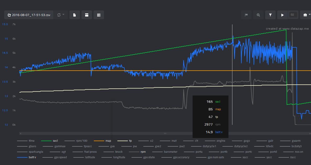

                                First I'm going to post a pic of the datalog.
                                First dip in battv (blue) is when I turned the electric fan on. It typically stays on all the time. Battv stays relatively stable, increasing with rpm, then it starts to get REALLY noisy. Starting to think maybe the 1-wire alternator's regulator is going bad or it is just mega-noisy by nature. SecL (green) continues to count up correctly and only resets right at the point the engine dies. Of note is the fact throttle position (white) continues to climb even though there is no TPS installed.
                                I'm going to post the msq and msl to the MS forum and see what those guys have to say.
