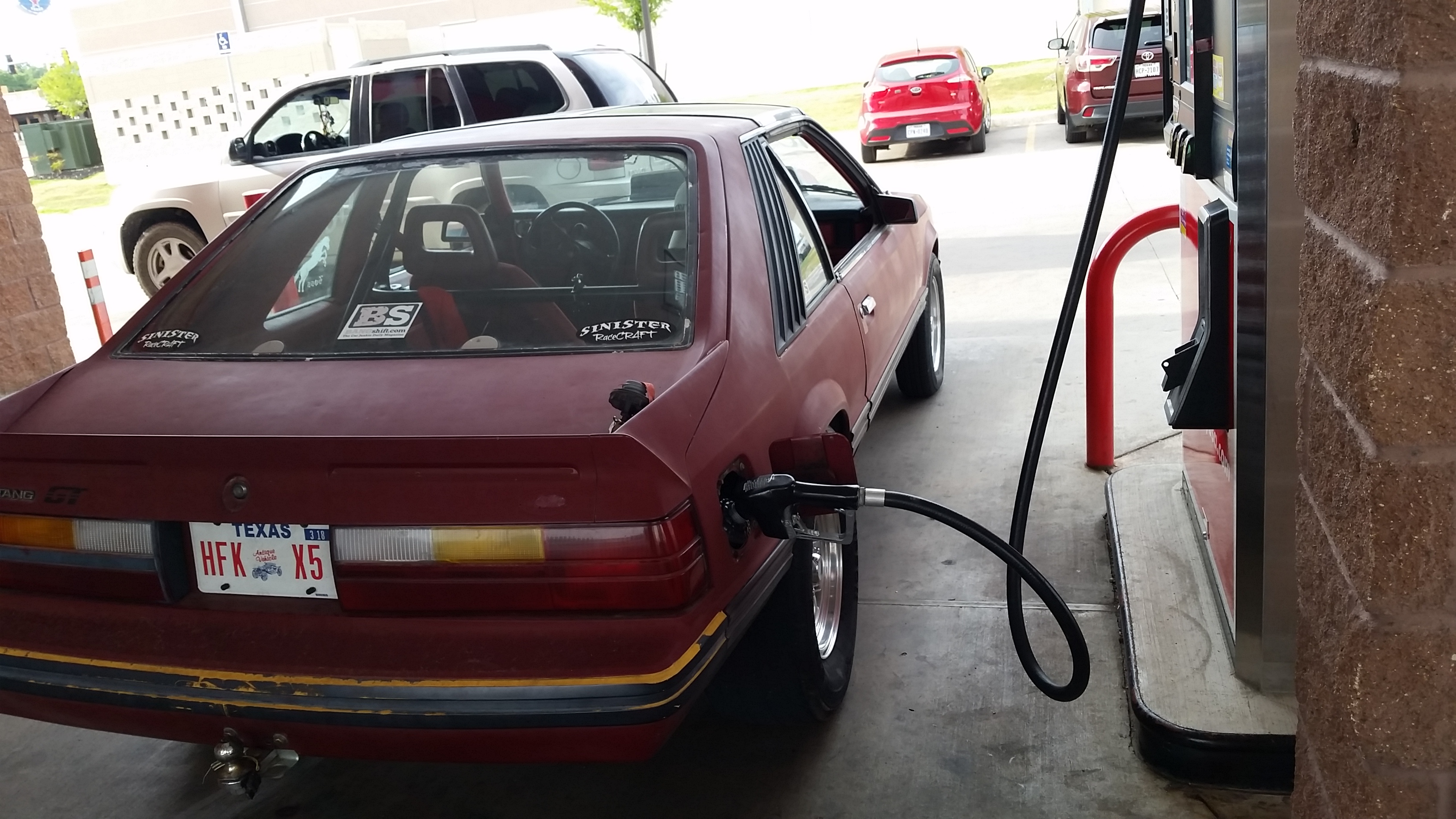

Yep, that was all. Took Jake for a ride yesterday to drop him off to meet some friends and it ended up being about 10 miles longer than I anticipated. A little further than I really wanted to go at this time, but it ran like a top. Seems to be running on the rich side, so it looks like I need to do some tweaking. Hammered on the throttle a few times and it really feels spunky.
Had to make a stop at the gas station because I wasn't 100% sure how much fuel I had.
