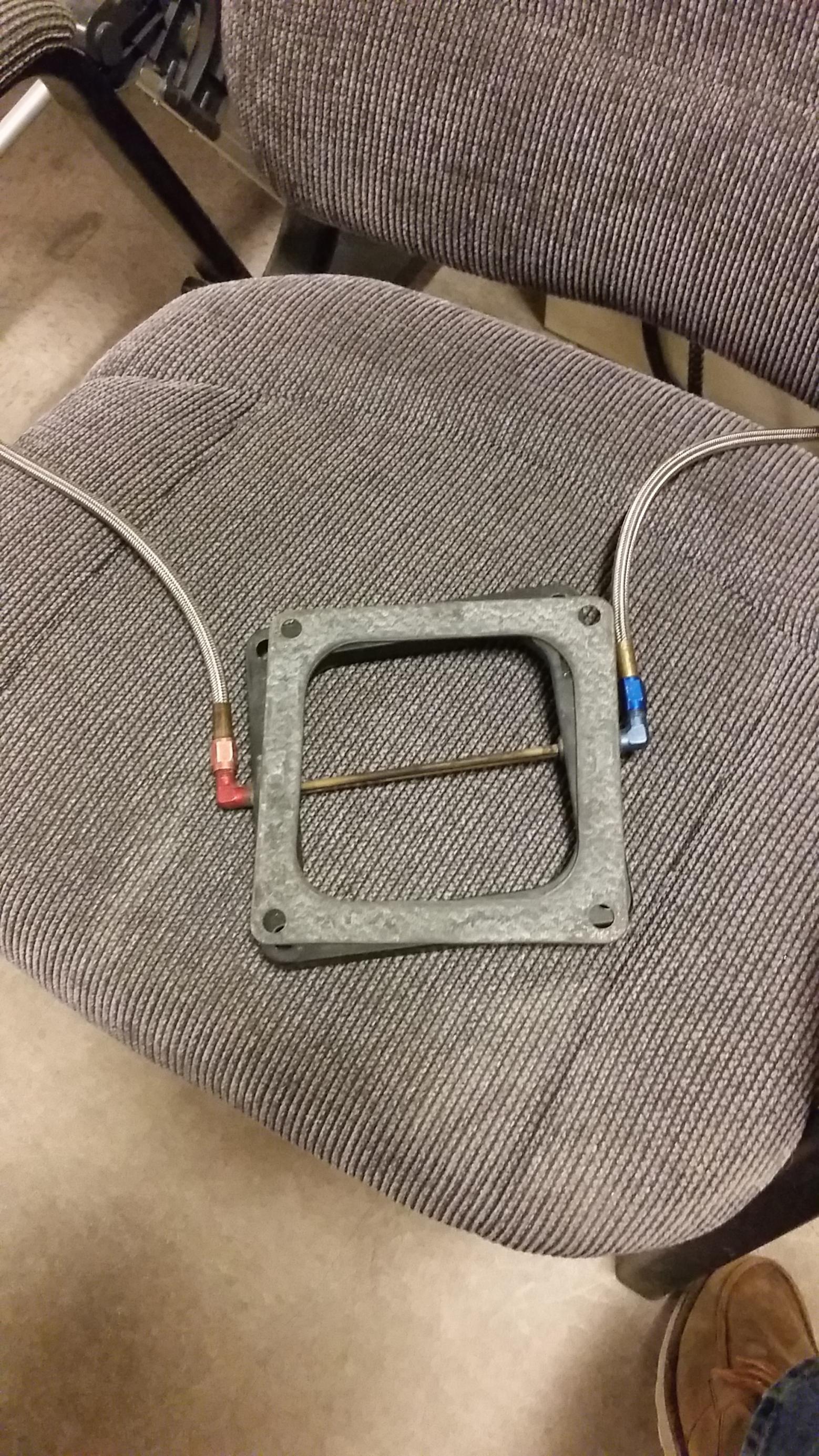

NX Stage 6 solenoids with purge (came with a mod motor nitrous plate) and a NOS plate for a Dominator......
now you'll need all that nine second safety stuff....
"If it don't go, chrome it!" --Stroker McGurkComment
Only if they check... Probably won't be something I use all the time. But would be nice to have if we start doing more 1/8th mile list racing here.Life is short. Be a do'er and not a shoulda done'er.
