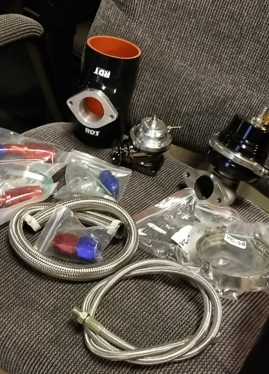

Some more bits showed up today. Wastegate, BOV with mount, oil lines, and v-band clamps.
First oopsie. There will probably be plenty of these as we go along...
The hot side wastegate flange is for an HKS style wastegate. My wastegate is a Tial style flange. Had to order a $20 adapter. I could have made it myself, but I will happily spend the $20 to not have to!Life is short. Be a do'er and not a shoulda done'er.

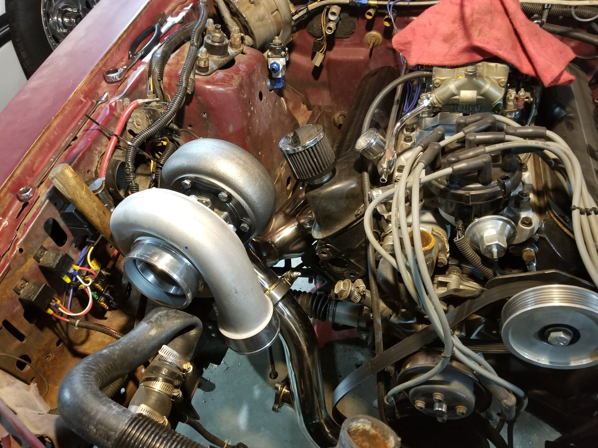

I couldn't stand it. I just had to mock up the header and turbo. The alternator may be a bit in the way, but I *might* have a trick to fix that. We'll just have to see.

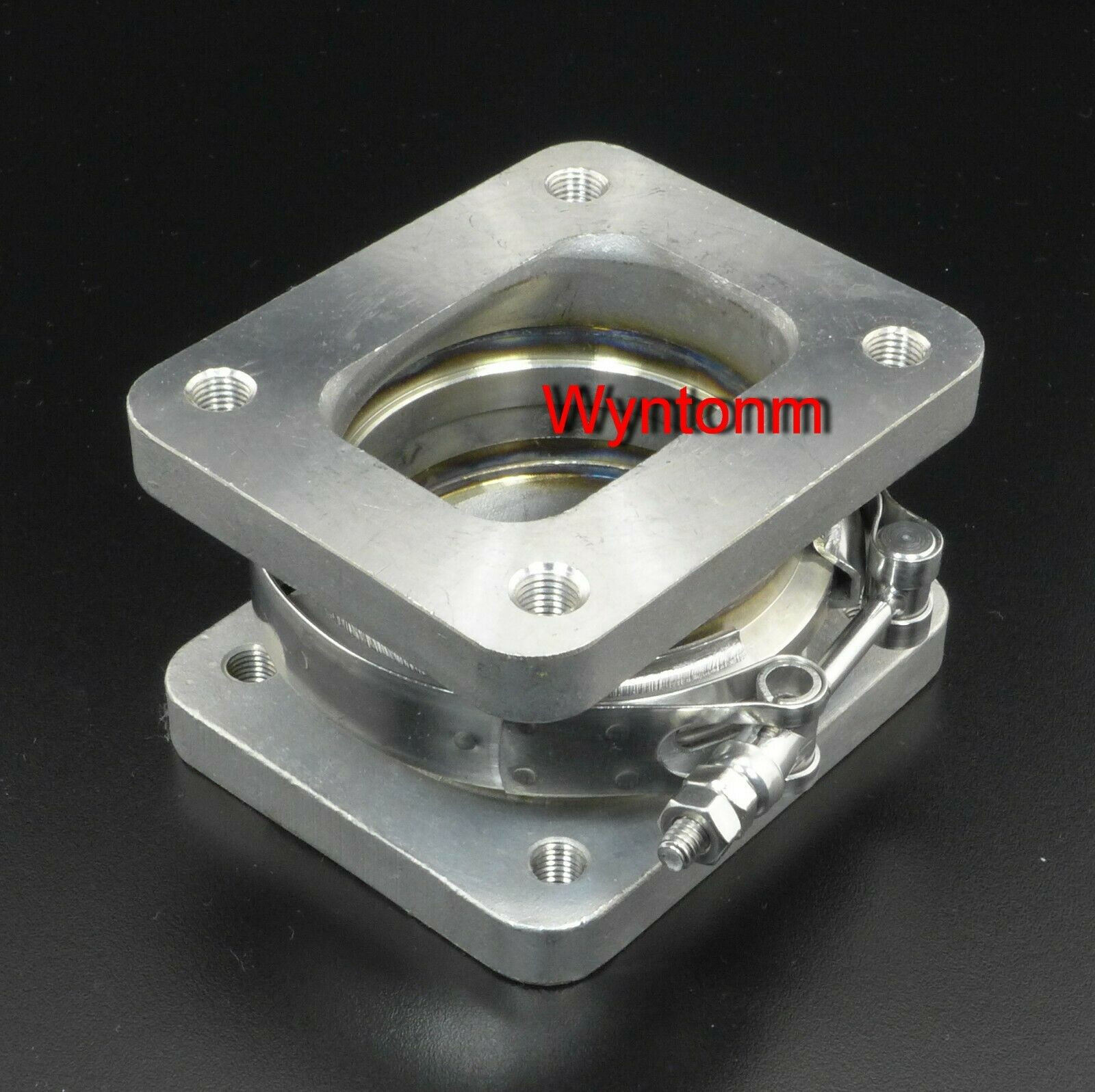

The trick for the alternator problem is this nifty rotatable T4 to T4 flange with a v-band in the middle. It will space the turbo up/over 1.5|" and allow me to rotate it a skosh.to clear stuff. I could have relocated the alternator, but I reallt like the serpentine setup as it is.
You don't think that will cause it to hit the hood? Flow restriction?Originally posted by BBR View PostThe trick for the alternator problem is this nifty rotatable T4 to T4 flange with a v-band in the middle. It will space the turbo up/over 1.5|" and allow me to rotate it a skosh.to clear stuff. I could have relocated the alternator, but I reallt like the serpentine setup as it is.
Hood clearance is something we may have to monkey with. And I don't think flow restriction will be an issue. Maybe if we were trying to make 25 psi and 700 HP, but not for this thing.Life is short. Be a do'er and not a shoulda done'er.
