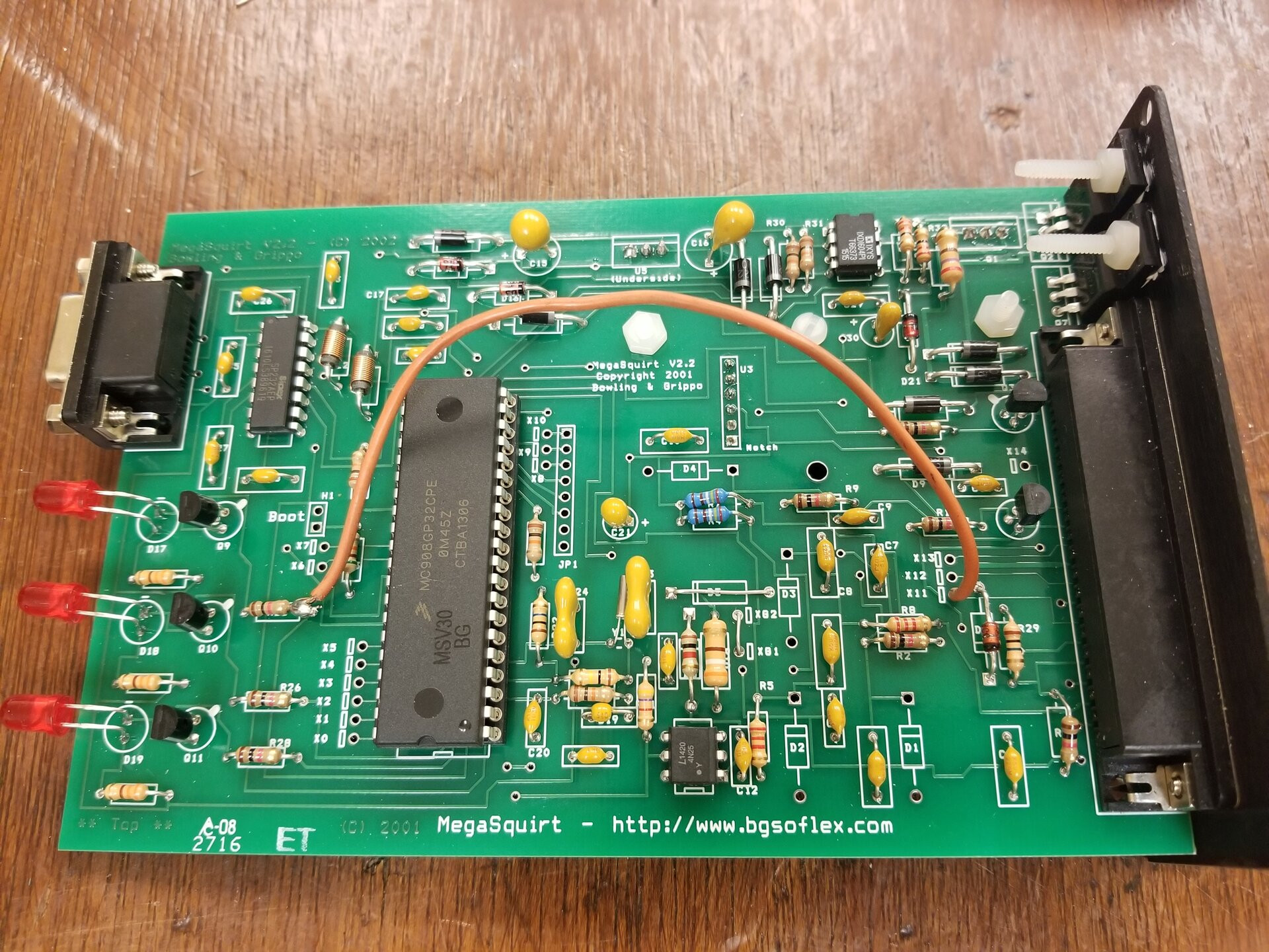

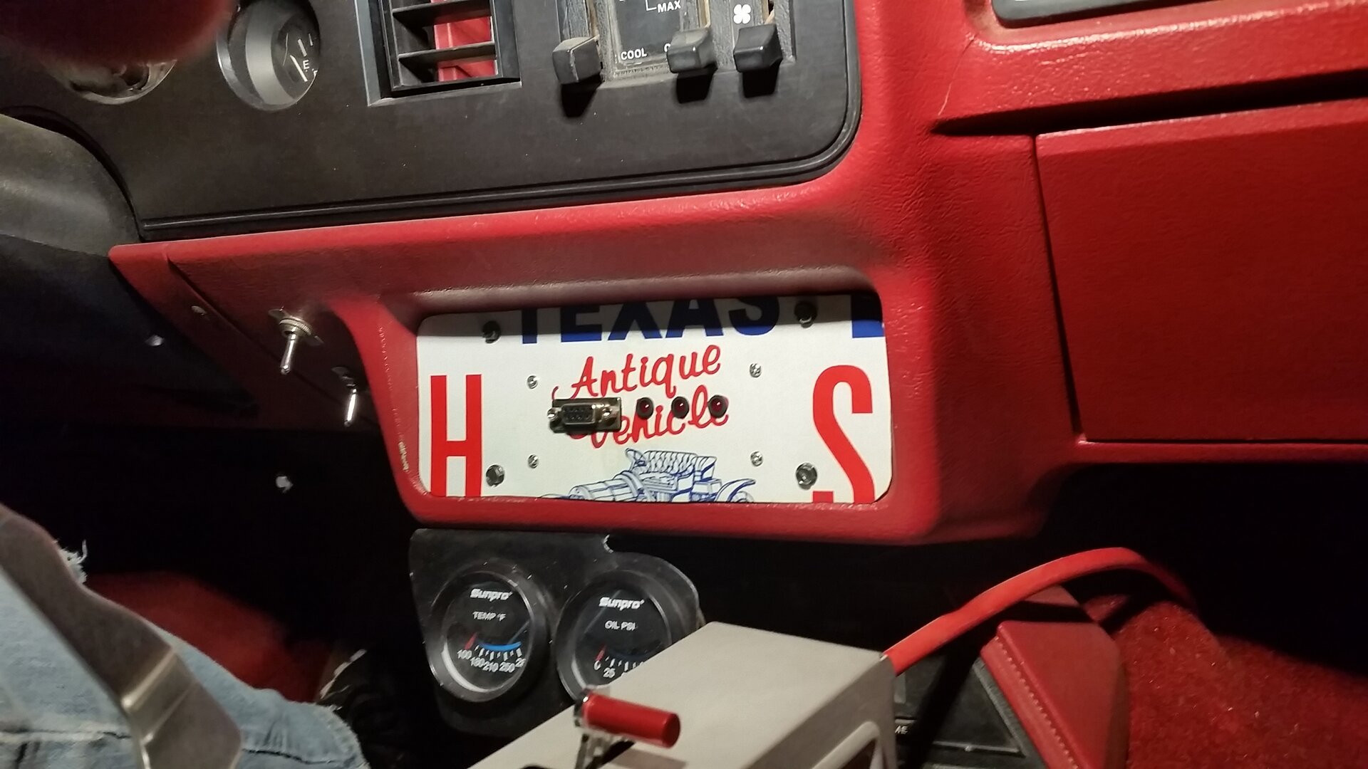

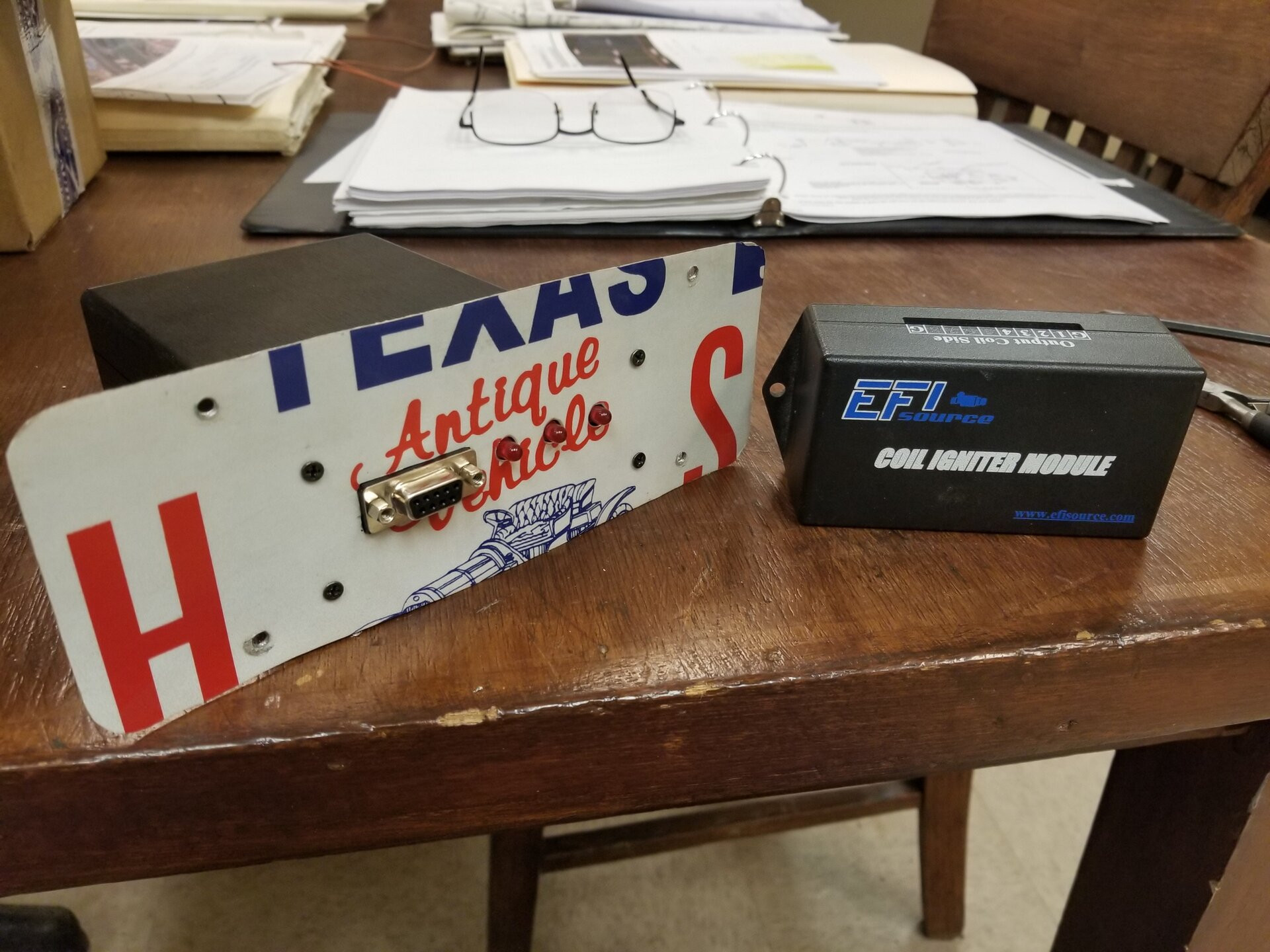

MS internal changes are done and I put the old mounting plate on it to mount it in the car. This is the same way I mounted the previous MS in this car.

- Igniter needed spark in, ground and a lead to the coil (-).

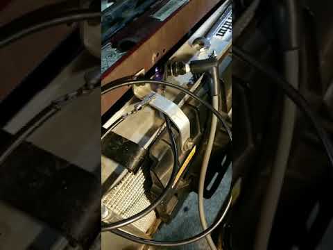

Everything under the hood is wired up and ready. I put a spade connector sticking out of the harness on the TFI's coil lead to run a jumper wire from it to the coil (-) so I can set the base timing. It will also serve as a way to make the engine run in the event of a MS failure.

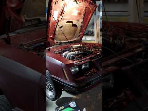

Whoo hoo!! It runs on the Megasquirt!!!
Turned it on, hit the key and it immediately lept to life! Meg Ryan levels of yes yes yes!!!
I also tested the rev limiters at 3000 (soft cut) and 3500 rpm (hard cut) and it worked just like it should.
