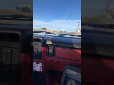

Oh boy this thing is fun. Judd and I went up to the shop today and did some driving and datalogging. First though, we had to put some gas in it because it literally had none. Drove it to the station and it ran like it was on 4 cylinders. Filled it up (15.7 gallons!) and went back to figure out why. We messed around with several things to no avail then decided to start pulling plugs. We did 5-8 first because they are easy and they looked fine. Went straight to #4 because it is the hardest and found that the plug boot was not on the plug good. Haha. Fixed that, still didn't run right. Came back, and to no surprise, 1 and 2 were the same situation. Lol. We feex.
Jumped in, started the laptop and went out to the access road to log some data. It went really well and we did a few short WOT pulls. Motor seems happy, oil pressure and water temps were stable. The IAT is interesting on a blowthru! Boost comes in and it starts dropping. Our cruise afr was around 13.5 and WOT was low 12's. I might drop the primaries a couple or four and up the secondaries 6 or so. Part throttle with boost coming in really goes lean, but that's understandable.
Took some vids snd will upload later.

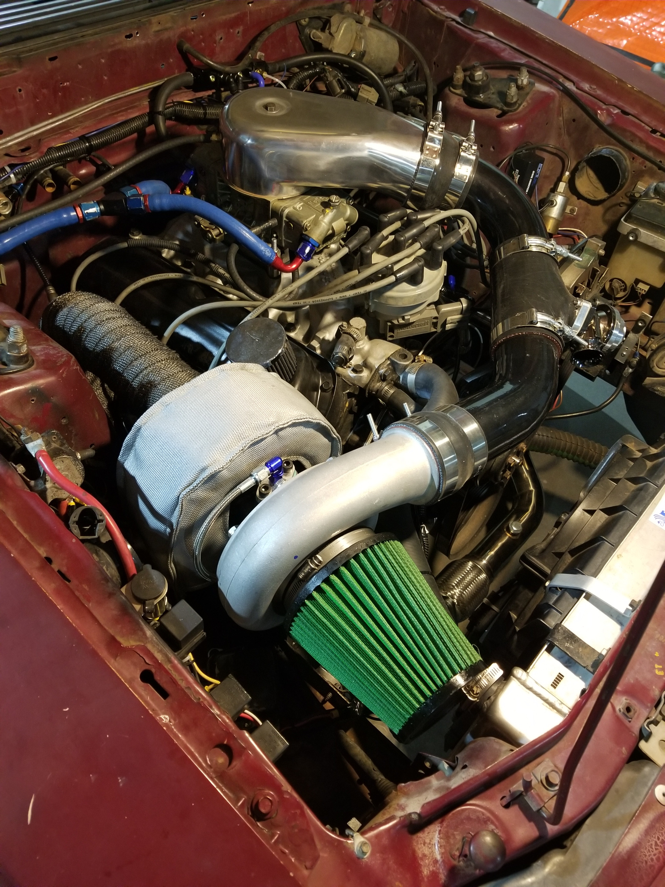

Air filter, and exhaust parts (bends, pipe, Y pipe for a cutout) showed up today so we can get busy finishing up the exhaust very soon.
Jammed the filter on it! The brand is Green Filter, which should be somewhat obvious.
