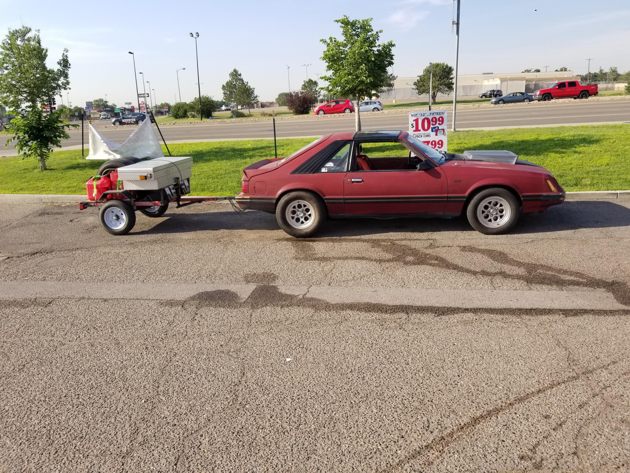

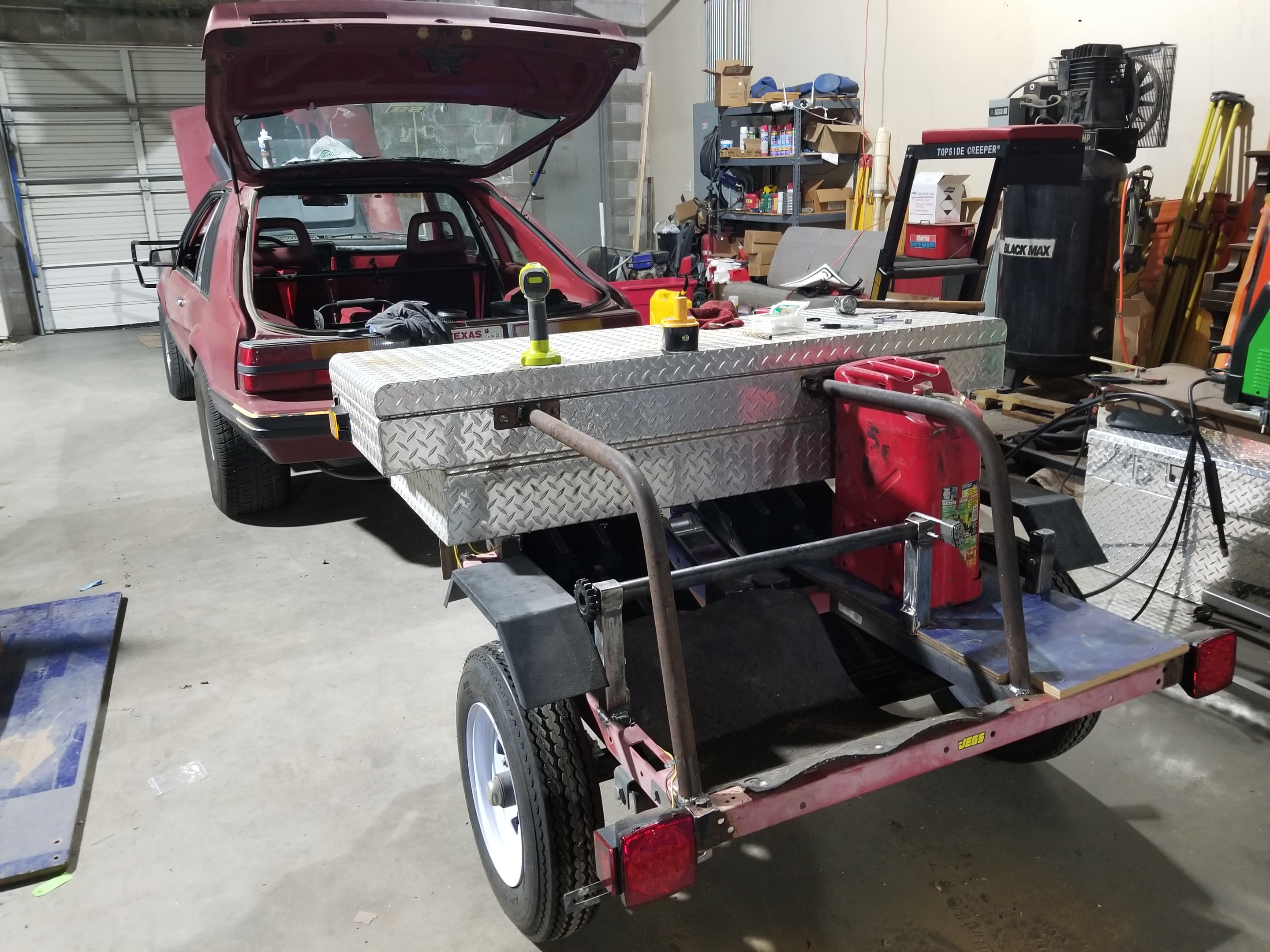

    Just about have everything ready for Rocky Mountain Race Week. The trailer just needs a few little details attended to and the car just needs an oil change and the submarine strap adjusted. Can't wait!

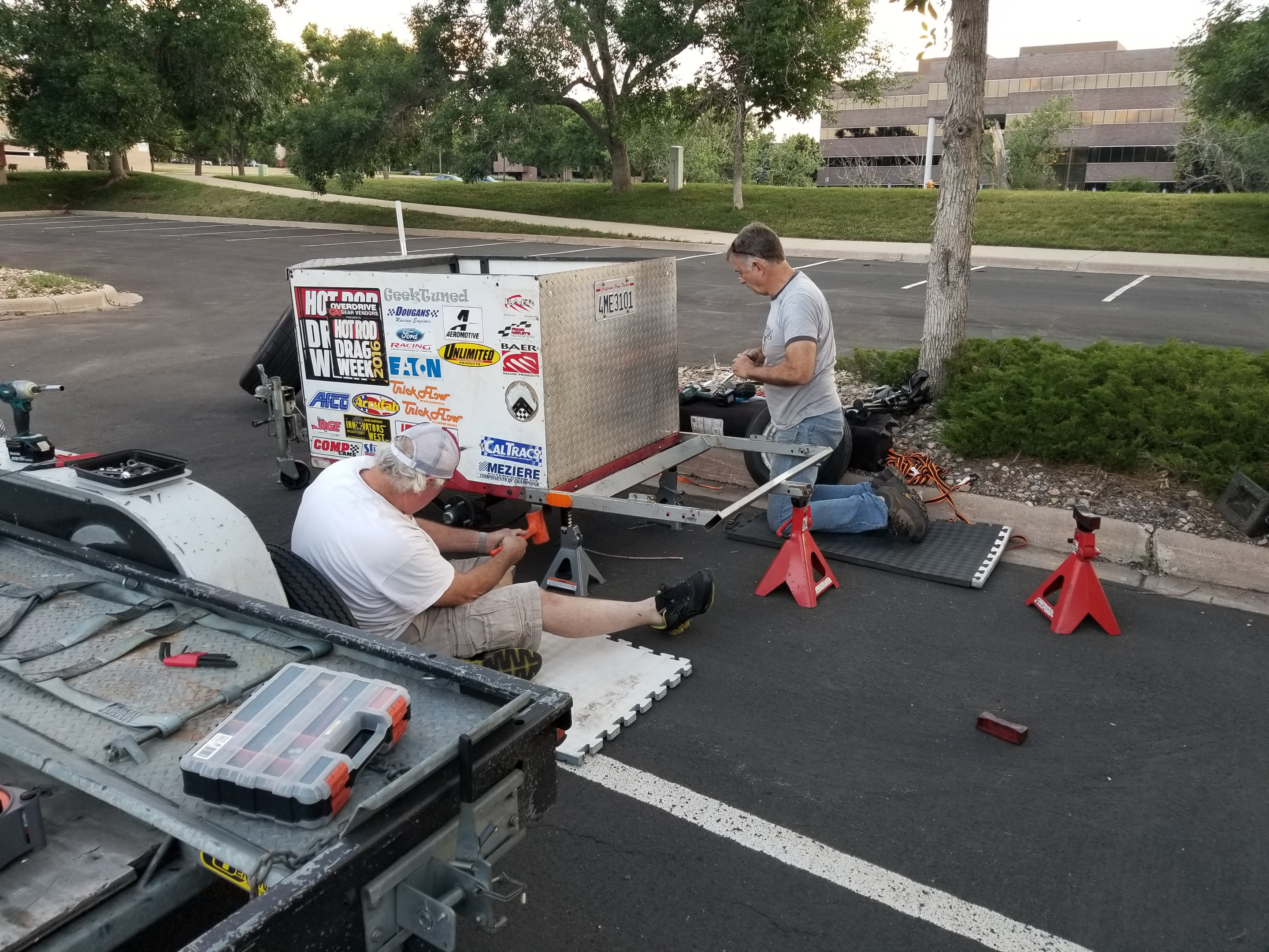

      My to do list got a few items longer and we knocked them out today along with doing multiple honey-do's at the house.

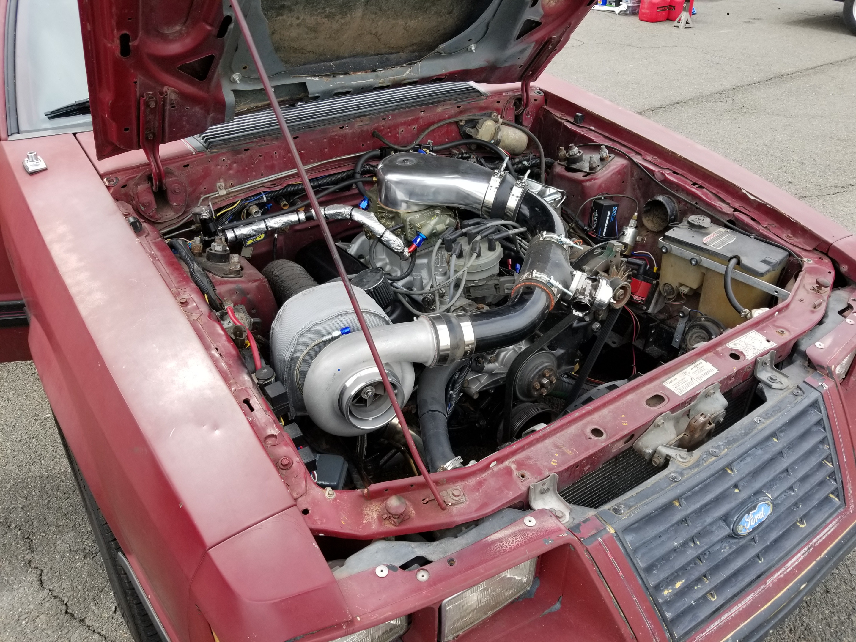

      I played with the timing a bit and after some research decided we are waaaay conservative for only 8 psi. We were runnjng a max of 18 degrees at full boost (on 94) but I have seen many people in the 26 range on 91. I upped it to 23 and still think it is a little on the low side considering the fact we will be at a higher elevation.
      Knock on wood but I feel better prepared for this trip than pretty much any other DW or RW I have done. Hope I am not overlooking something! Haha.

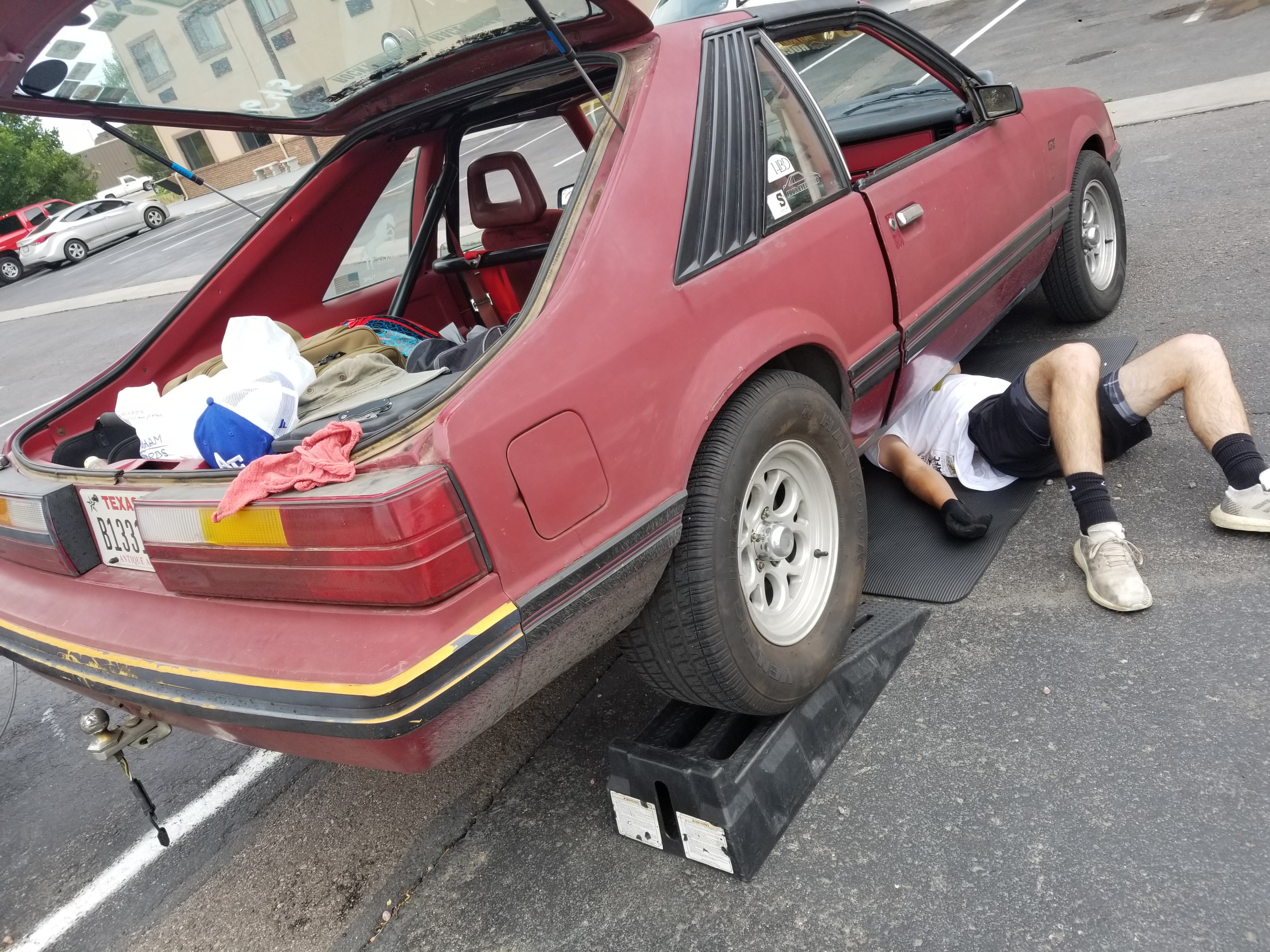

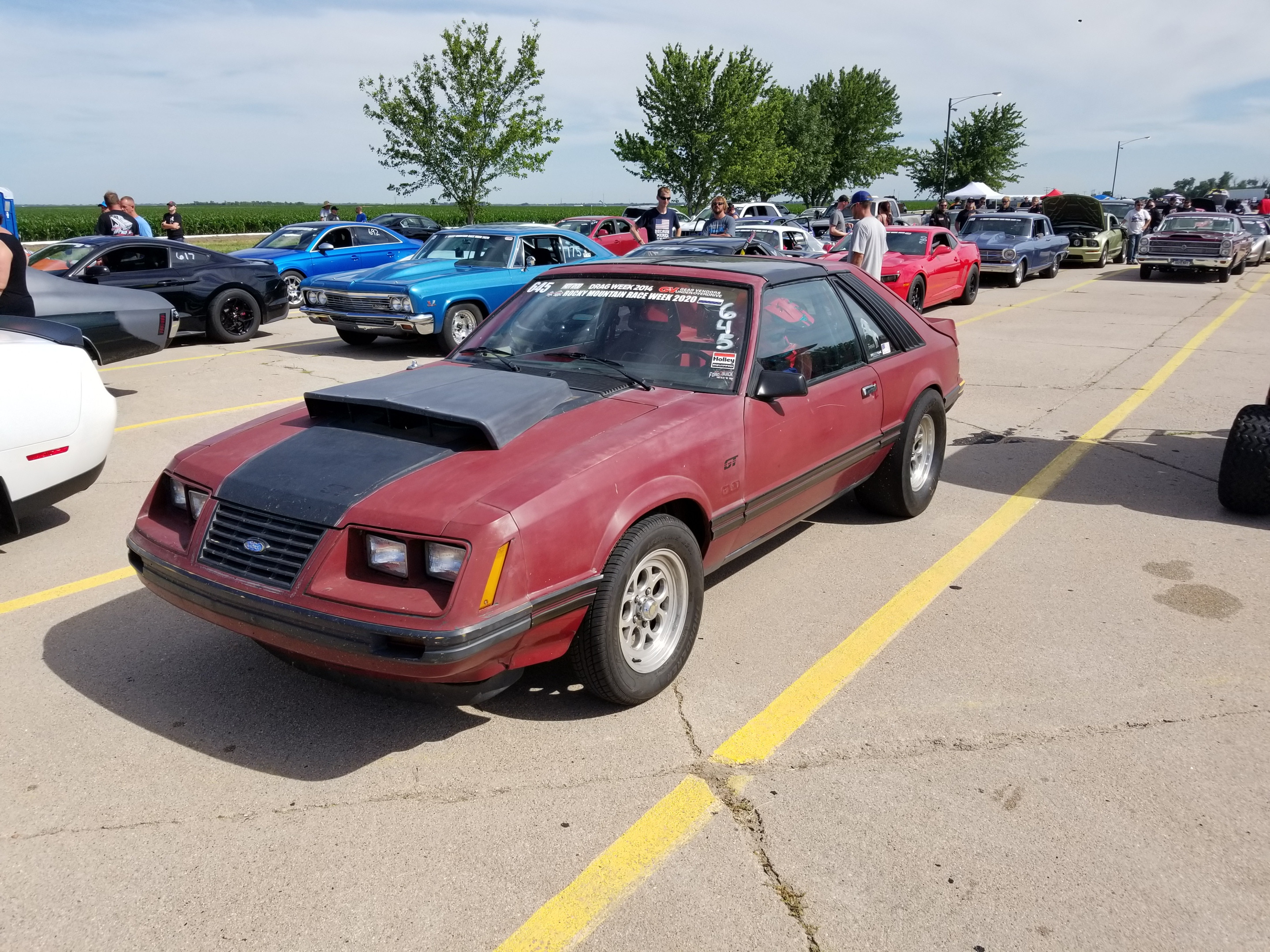

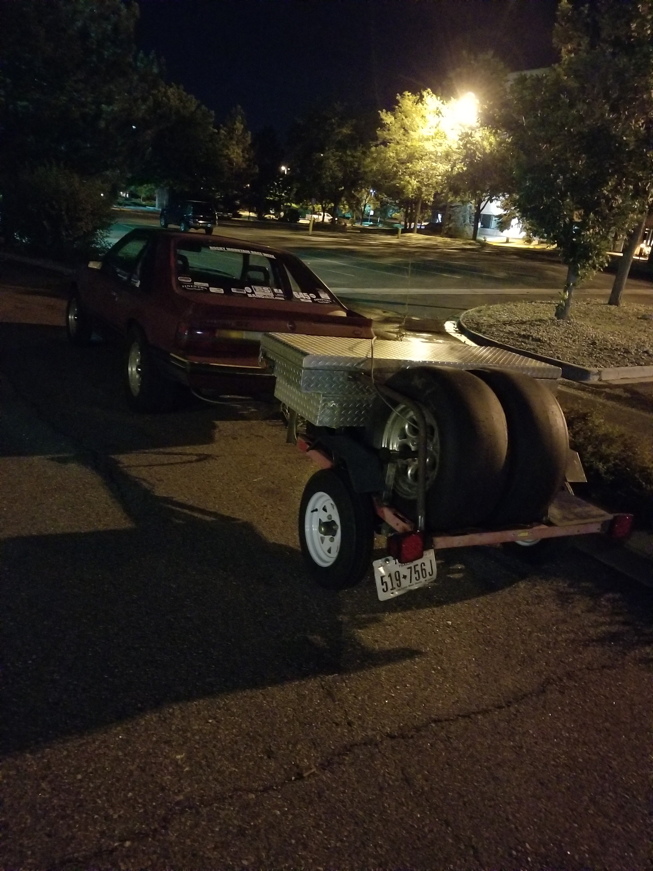

            ROCKY MOUNTAIN RACE WEEK 2020
            Judd and I headed North on Monday. The Jeep tows really really well. It was real easy to forget you were pulling an 18 foot trailer with a car and another trailer on it. We arrived in Lakewood later that day, got checked in at the hotel and then got some dinner at a nearby Denny's. We had to fix our small trailer's taillight/license plate bracket because it broke on the drive up. Then we had a minor panic when a thread on the Raceweeker's page on FB mentioned something about cracked windshields not passing tech. We walked to a convienence store and bought some superglue to put on the crack. I messaged Matthew Frost about it and later he assured me it would be fine. Wheew. More Raceweeker's arrived and we got to check out some of the cars and were happy to see Bill Fowler and his cohort, Karl were at our hotel. We hung out with them chatting and watching them assemble Bill's trailer and get their stuff organized.

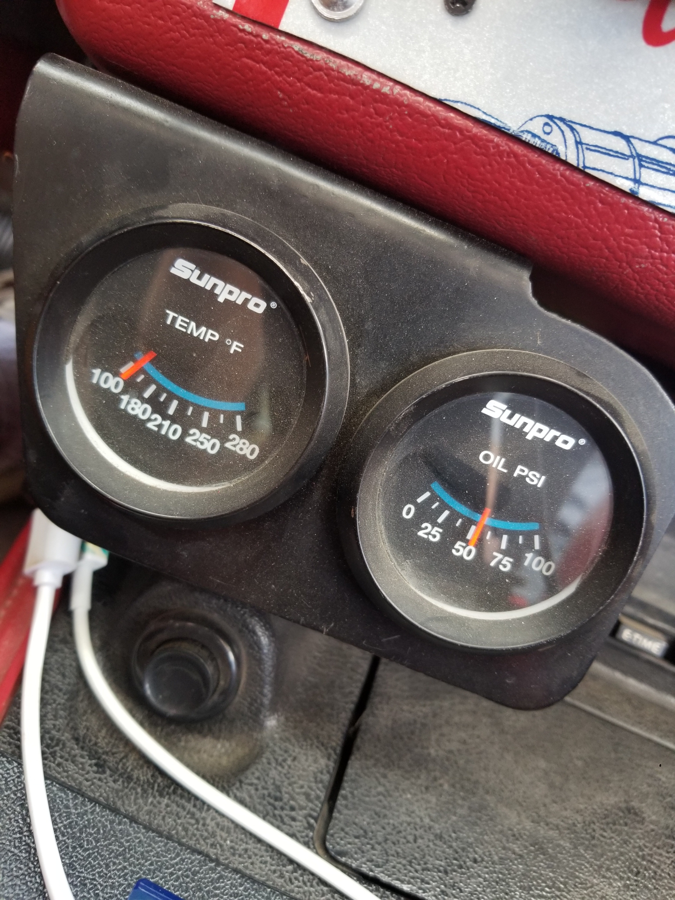

                  Day 3: Thursday - Race day in Kearney. Since we didn't race until 4pm, we slept in a little. The datalog indicated we were in the 12.5's at WOT so we decided to jet up the secondaries a bit to get that back down, particularly since we were now much much closer to sea level. We checked the oil and went to grab some lunch before heading out to the track. It was kinda hard to find a fast food place that actually had dine-in available, but we lucked out and ate at Freddy's Steakburger. Once at the track, we found a spot to pit and got the car prepped. It was hot and shade was sparce. With this "all evening racing" format, I am definitely taking an Easy-up next time! People were EVERYWHERE. The Cleetus pit area was mobbed from the time they arrived until the minute they left. It was packed and the concession stand line was a mile long. We made a couple of runs but Judd was having trouble hitting shifts. Weather was threatening and we were not sure if we were going to get another run. We waited and waited for them to call our class again, but with time running short, we realized that the staging lanes had devolved into a "all run" scenerio whether they wanted it to or not. So we got in the lanes behind another car in our class and Judd laid down his best pass of the day. He was among the last cars to go down the track that night. 13.64 @ 105. We'll take it. On to Great Bend!

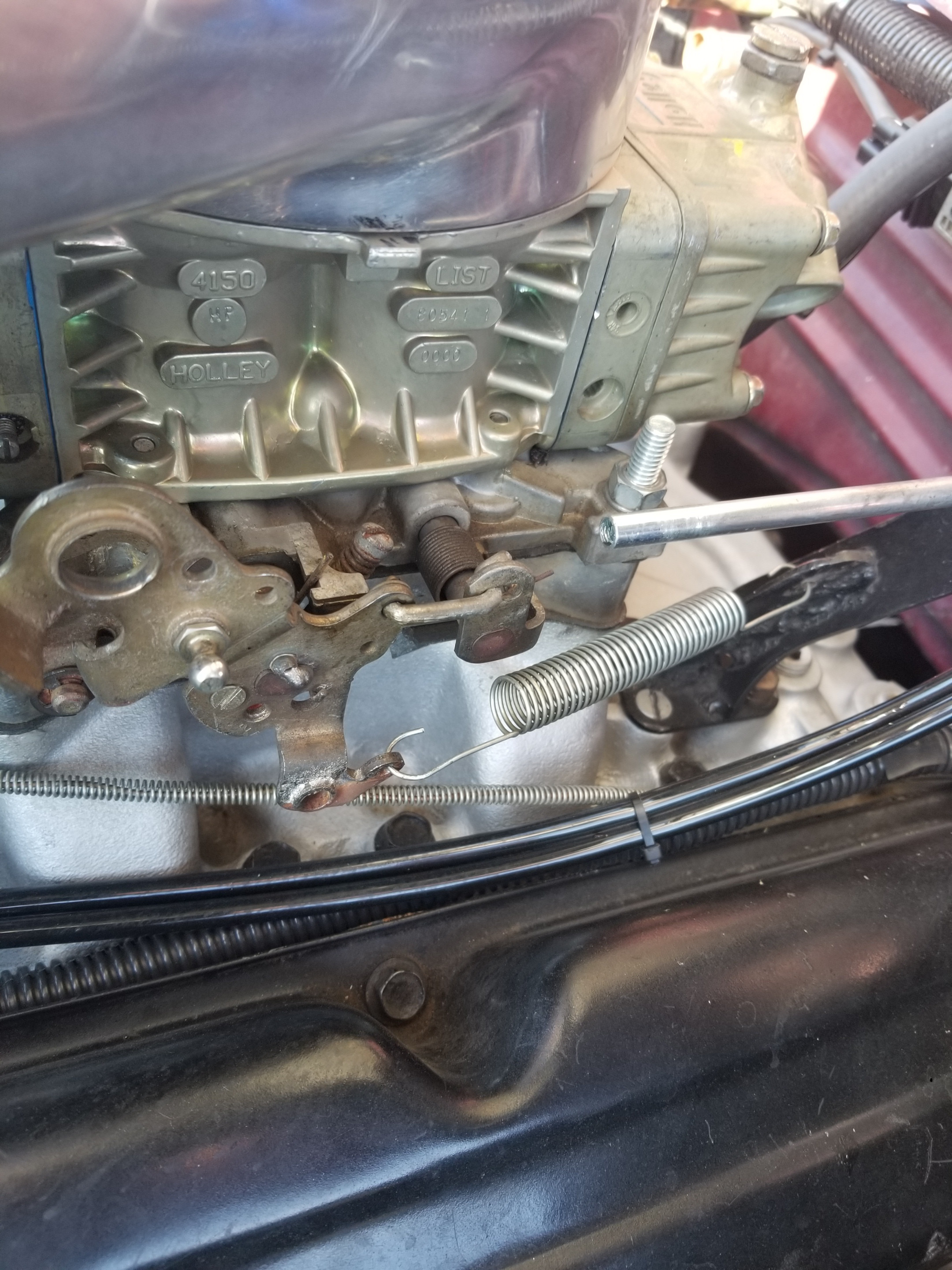

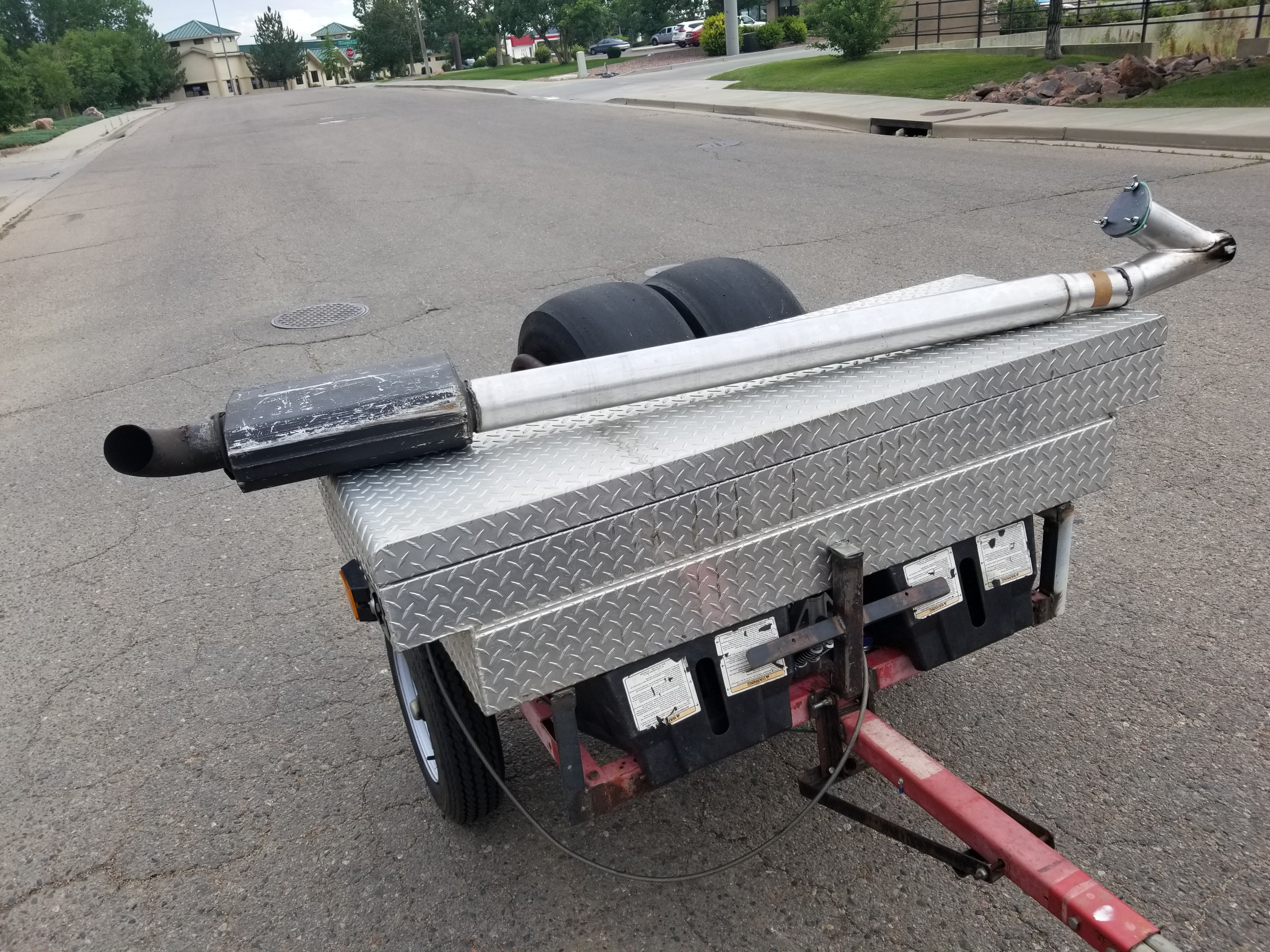

                      Day 5: Saturday - Drive to Pueblo. We get up and monkey with the car a little and need to run to O'Reilly's again for an allen wrench set to adjust the centering spring. I decide to look at the fuel pump and discover that the 5 bolts that hold the bottom of the pump were not exactly tight. Not leaking, but definitely not tight. We take off and the car continues to act funny when stopping but only if you were on the brakes hard. Gentle braking did not cause the stalling problem. We never figured it out but we think it was bad gas because it eventually stopped as we ran more fuel through it. Not far from Pueblo, we got our first taste of real rain on this trip. It was welcomed because it was hot and surprisingly, the wipers worked properly (unlike RMRW 2018!). We found our hotel, checked in and started to drive to the back side to park when we were startled by a huge *thunk*, loud exhaust noise and scraping noises. I tell Judd to shut it off and we bailed out to see what had happened. We look under the car to see the entire exhaust system from the down pipe back lying on the ground. It seems the bottom edge of the muffler caught the edge of a manhole and ripped it completely off the car. Yeah, completely off the car. Yowza. Luckily, it was attached by a rubber mount in the back and an exhaust band clamp in front. This amounted to a "breakaway" exhaust system and thus prevented us from damaging our down pipe or turbo. We throw the pipe on the trailer, go park and proceed to put our exhaust back on. We chill at the hotel for a little while and then go eat a steak at the Texas Roadhouse.

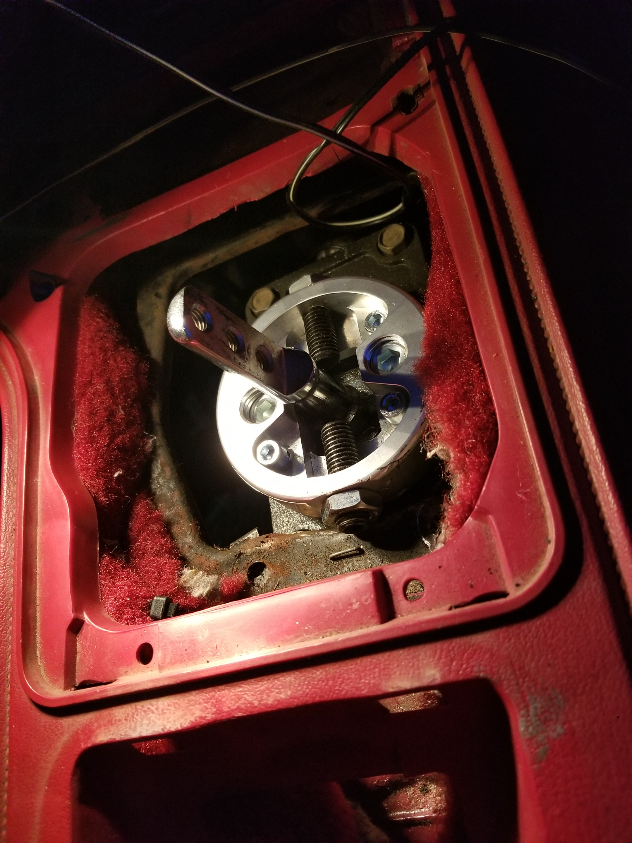

                          Day 7: Monday - Drive the Bandimere. The end is in sight! Even though our trans sounded like it was about to come apart, the drive today was my favorite of the whole week. Our one and only check point was in the Garden of the Gods and it was pretty darn cool. After that we drove on some really windy/steep mountain roads. We loved it and the car ran cool and never missed a beat, even with no 3rd gear. Other guys were not so lucky as we passed a lot of cars with their hoods up letting them cool off. As we approached Morrison, Judd could help but test our exhaust system repair one last time. There was "something" in the road. I though it looked like a thermos or maybe a Gatorade bottle. With cars next to us, he had little choice but to go over it. *Kablammo!!* Whatever it was, it was SOLID and it just managed to hit the front edge of the muffler. Nothing came off, but the muffler now has a significant dent in the bottom edge. Haha. We pull in the gates at Bandimere, crunchy transmission and all, and go find a pit spot on top.... mainly so it would be downhill all the way to the starting line. Haha. They called our class and Judd went up on street tires and laid down a 1,2,4 shifting 16.xx pass at 93 mph. Way faster than I would have wanted to drive it with that transmission! And with that, we finished Rocky Mountain Race Week 2020. Judd turned in his slip, we retrieved the Jeep, loaded everything up and went and watched the rest of the afternoon. The awards ceremony was later that evening and we got good seats up front with our friends Bill and Karl and right next to the Cleetus crew. Those guys were having a good time. Haha. Afterwards, we decided to beat the rush and hit the hotel. It had been a long day and we were exhausted.
                          So that was pretty much our week. The stuff I was concerned about worked perfectly and stuff I never expected to have trouble with, broke. I really didn't even expect to have T5 trouble. I think the shifter stop tower incident was the beginning of it's demise. But even with trouble, I loved every minute of it. There were laughs, stares of amazement, moments of mild panic, inside jokes, talk of changes and improvements and best of all, just spending a solid week with Judd. That guy is the best. Love him and love that we got to share this adventure. Can't wait to do this again!
