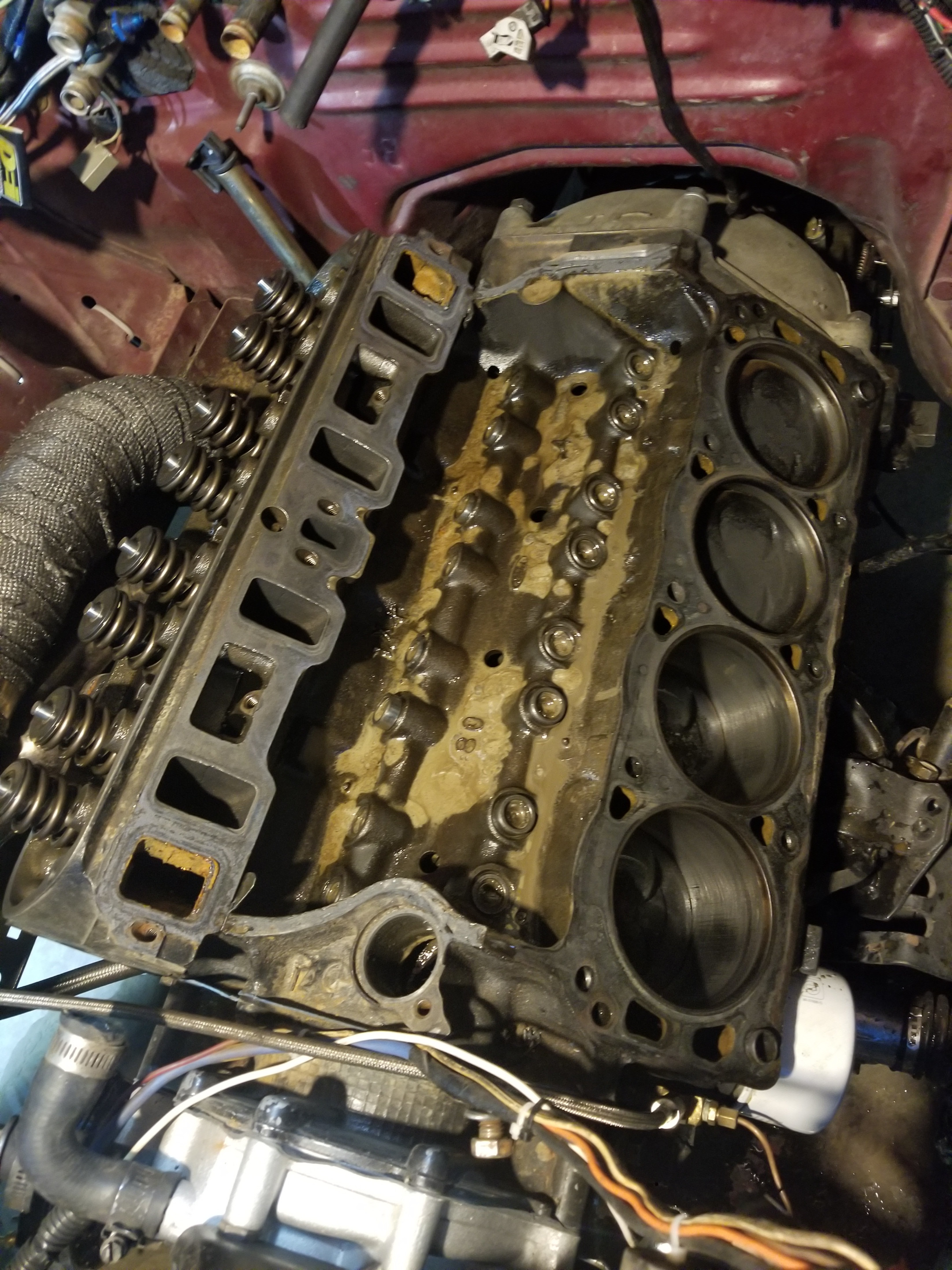

Me thinks we have a leak. Haha. Car still runs, but I think a head gasket is weeping into the valley. Not a whole lot, but enough to gunk it up. I think the problem might have been exacerbated by the fact we didn't have the cooling system completely full and by the fact our electric fan relay has been acting up. I know we got it hot once at Buick v. Ford when Judd let it idle for a very long time in the staging lanes. It's not leaking anywhere on the outside or out the exhaust, nor does it seem to be pressurizing the cooling system so it must not be too severe.
Heads in a Fox body is easy peasy. Maybe I can get Judd to do all the work..Life is short. Be a do'er and not a shoulda done'er.
Plugs out, rockers off, pushrods out, header bolts out, amd one header out.
Plugs 2 3 and 7, were really clean, almost too clean compared to the rest that were pretty black.
Also, I am totally going to move the engine to the front set (stock location) of engine mount slots when the heads are off. Doing so will make quite a few things fit and work better.

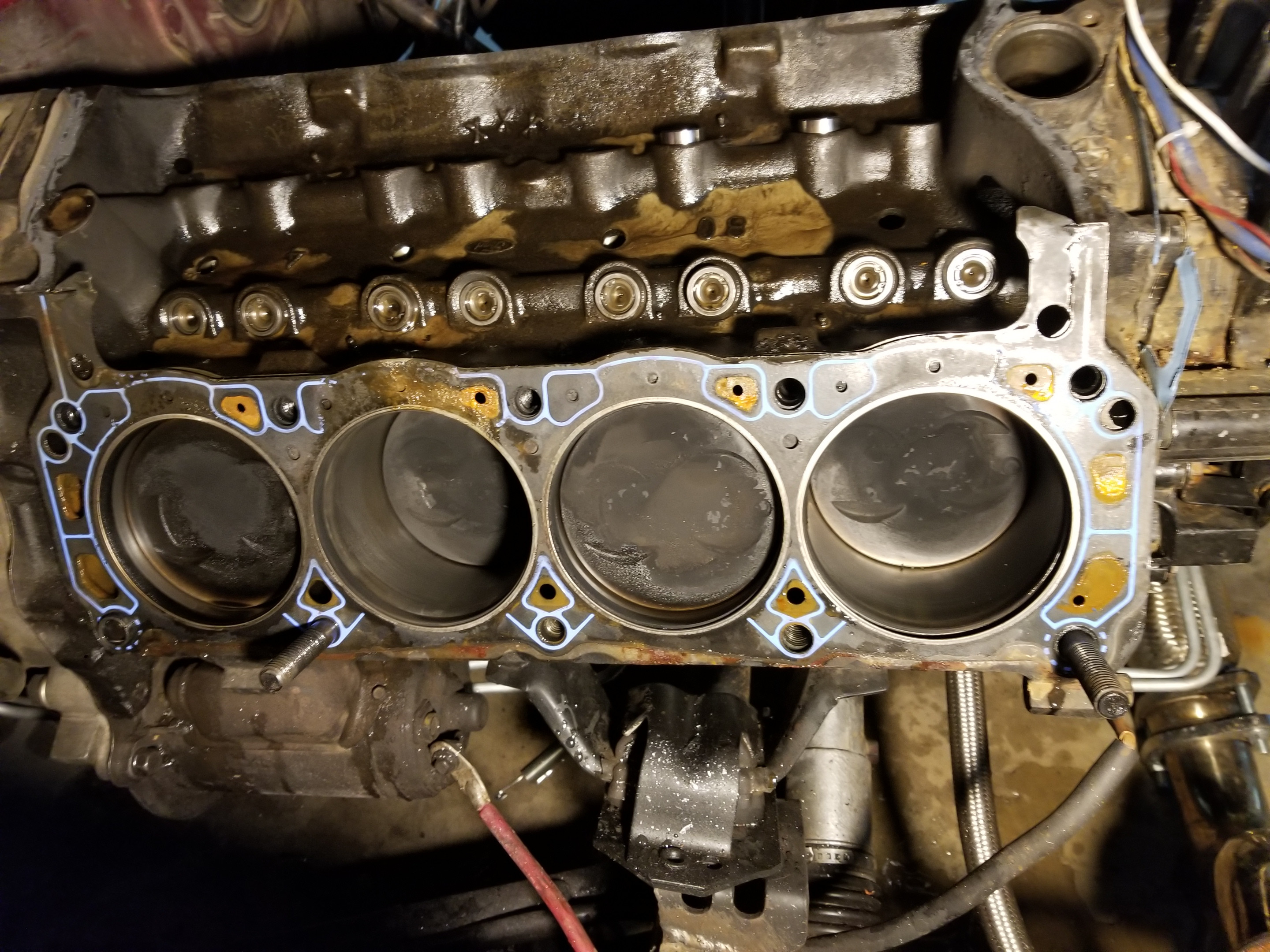

Intake off and one head off. No smoking gun except the fact the head bolts were not really as tight as I expected them to be.
Chambers are all consistently colored so nothing to see there.
To satisfy my curiosity, I pulled each lifter out and they look perfect.
Yep. #3 is definitely my culprit. I also moved the engine to the front (stock location) set of mounting slots in the kmember. Doing so will make quite a few things fit better.
I've been thinking about this for a bit. I think this time around, we will drop some shorty headers in temporarily, fire it up and heat cycle it a couple of times, then pull the shorty's and re-torque the heads. The headers block the lower set of head bolts so they have to come off anyway to re-torque.
