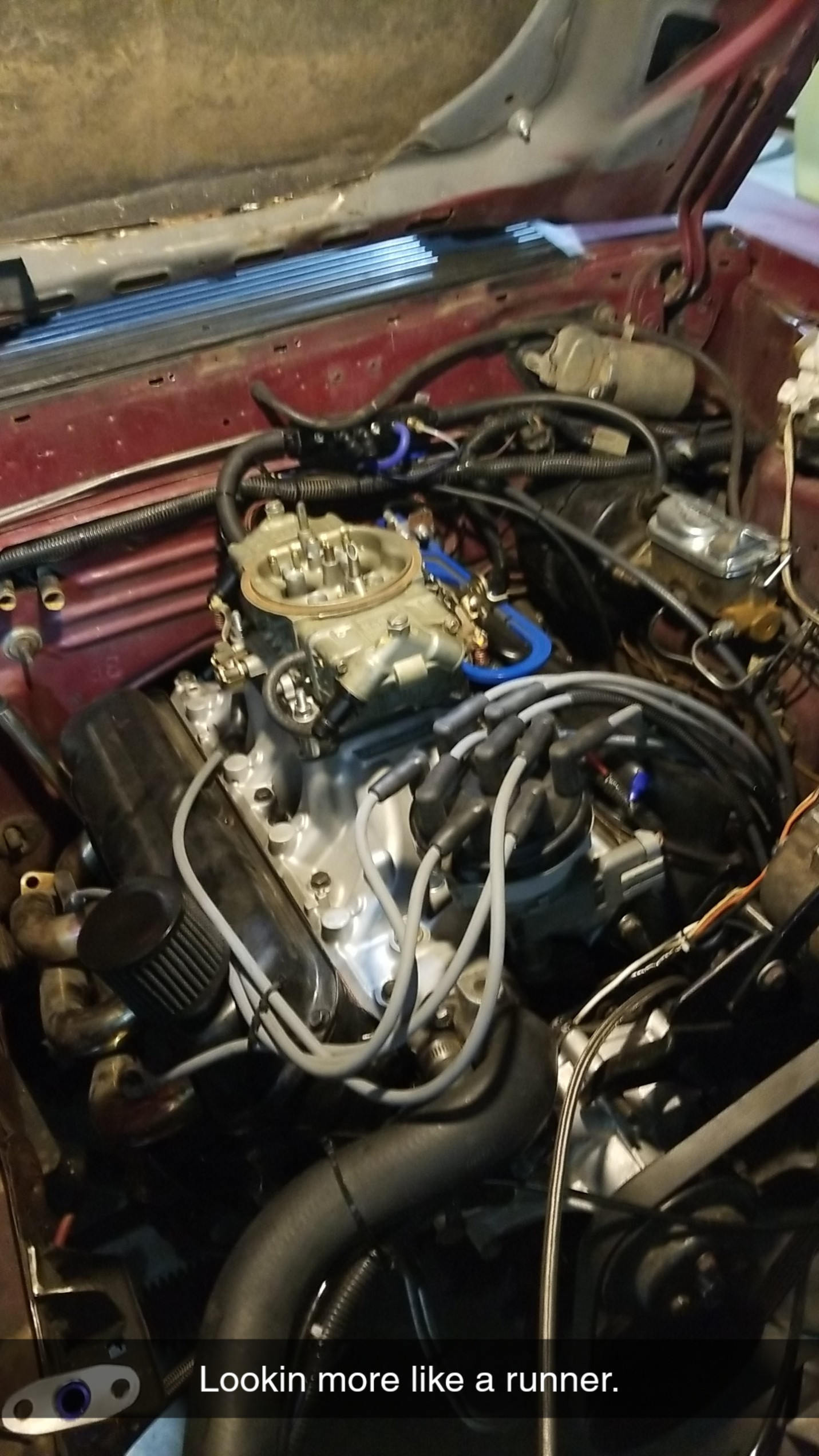

Mission accomplished. Carb back on, valve covers on and distributor stabbed!
Just add water and gasoline!
First heat cycle complete. Filled it with water, and after a couple of distributor tweaks, it barked to life!
I'll do it again and also set the timing properly. Then we can re-torque the heads and bolt up all the turbo goodies.Life is short. Be a do'er and not a shoulda done'er.

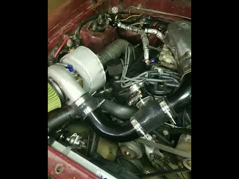

Choose your battles. Or, fix what you can fix. The Durango is wounded and we needed another car for Judd to drive, so I put the Mustang mostly back together last night and drove it home. Everything went great. I am just running it na right now to get the carb sorted out and running clean so I did not connect the turbo piping. It is stupid rich under accel right not a perfect on cruise. I think part of my issue with this carb is the fact I have the vacuum ports looped. Didn't think much of it but last night after I got home it dawned on me that by looping them, I just created a vacuum leak. lol Manifold vacuum port (below throttle plates) connected to ported vacuum port (above throttle plates).
Down pipe fit with a little massaging from a big hammer.
Last edited by BBR; December 15, 2020, 06:52 AM.Life is short. Be a do'er and not a shoulda done'er.
Monkeyed with the carb a little last night and I think I am moving in the right direction. Drove it to get gas and it is still rich, but it is much more responsive.
I've been playing with this carburetor quite a bit to improve it's drivability I did a lot of searching and reading over it racingfuelsystems.org. I discovered that I was quite a ways off on how this carburetor needed to be set up as far as air bleeds go. I also determined that my cruise timing was set considerably lower than it really should be. I have made significant improvements in the part-throttle acceleration richness and in the lean stumble it had on light acceleration from a cruise.Life is short. Be a do'er and not a shoulda done'er.
