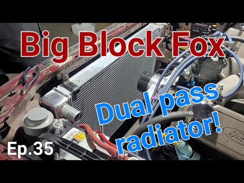

    It is an ebay no-name radiator. Just search Ford/Mopar dual pass radiator. There's a gazillion of them. It is a 19x31 and the hose is from a 2011-2018(?) Jeep Grand Cherokee with a 5.7L Hemi.
    Thanks! Stanger is up for sale but I don't want the buyers to have problems with him.

    Eagerly awaiting the road trip results!
    Did you get the dual pass from Speedway? If so, what size? Also, what year and model of Jeep for the hose? If this works out for you I intend to replicate your setup.

    replied
    Finished it up today. Filled it with water and set timing to 29 degrees. Fired it up and let it run. Made a quick lap around the parking lot and it is snappy!
    Water temp idling for quite a while and the lap was right at 160 degrees. It will need a longer drive to see if it has improved though.

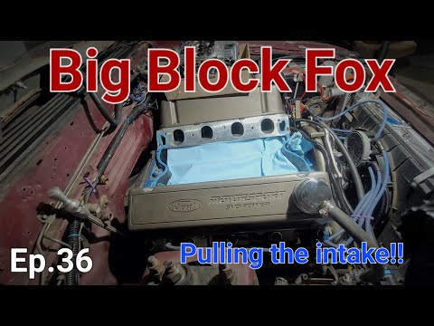

  • BBR
    replied

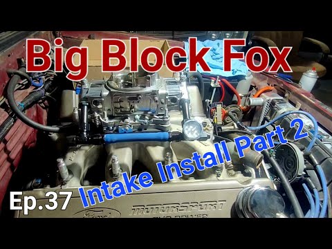

    Part 1&2 of fixing the leaky china wall!
    Also, I found that one of the plug wires got totally bar-b-qued on a header.

    replied
    Dual pass radiator? Check!
    I'm waiting to see how that goes. I'm in a similar situation with Stanger - OK but warmer that he ought to be.
    Leave a comment:
  • BBR
    replied
    Leave a comment:
