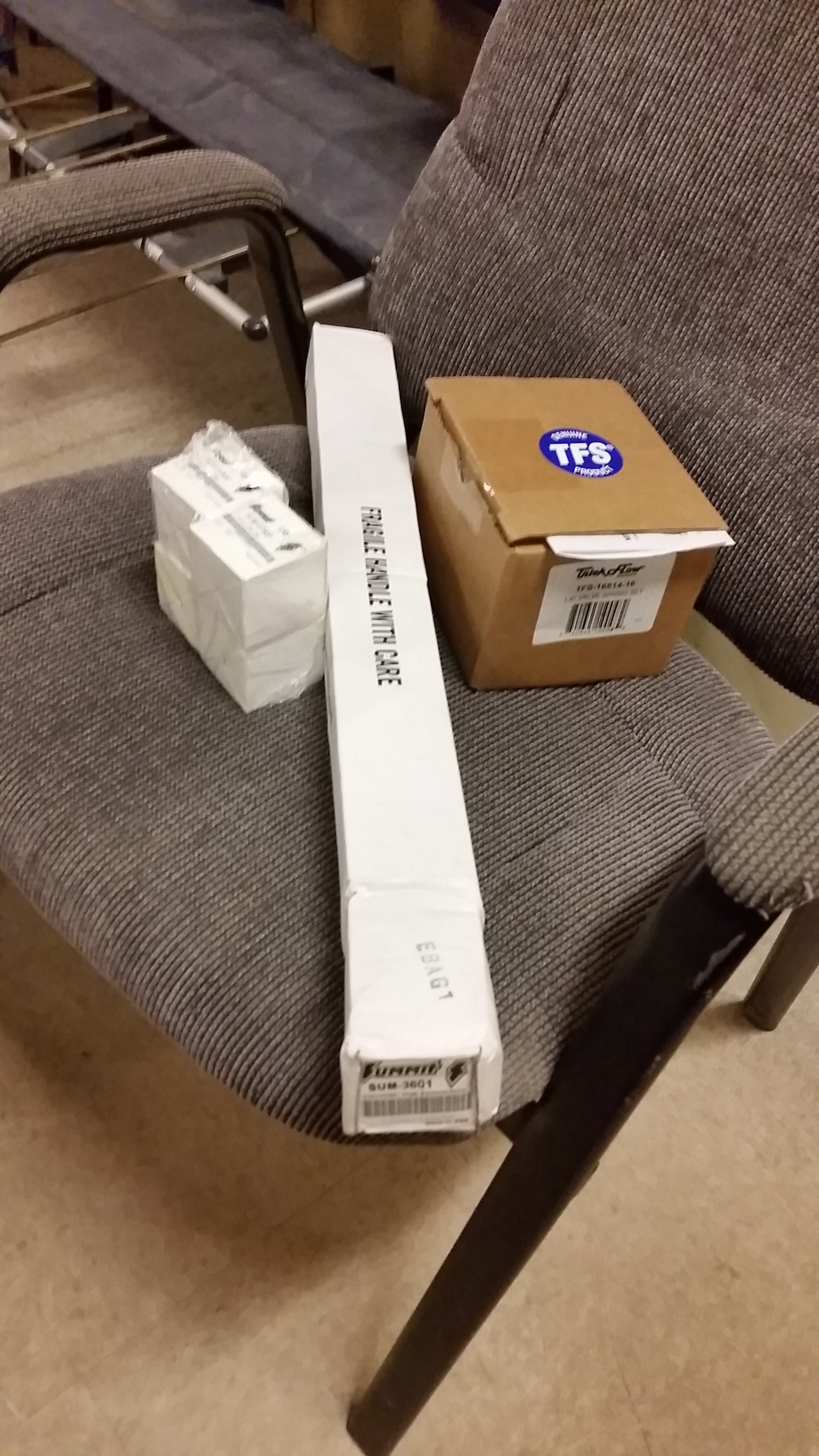

Cam (Summit 3601), lifters, valve springs (TFS 16514) and some chinese stainless shorty headers are on their way. That should pretty much wrap up all the motor stuff with the exception of a carburetor.
The heads have some new valve springs on them but nobody seems to know what they really are! So I felt the $60 spent was worth the peace of mind.
Total expenditure for this engine so far is just under $700.

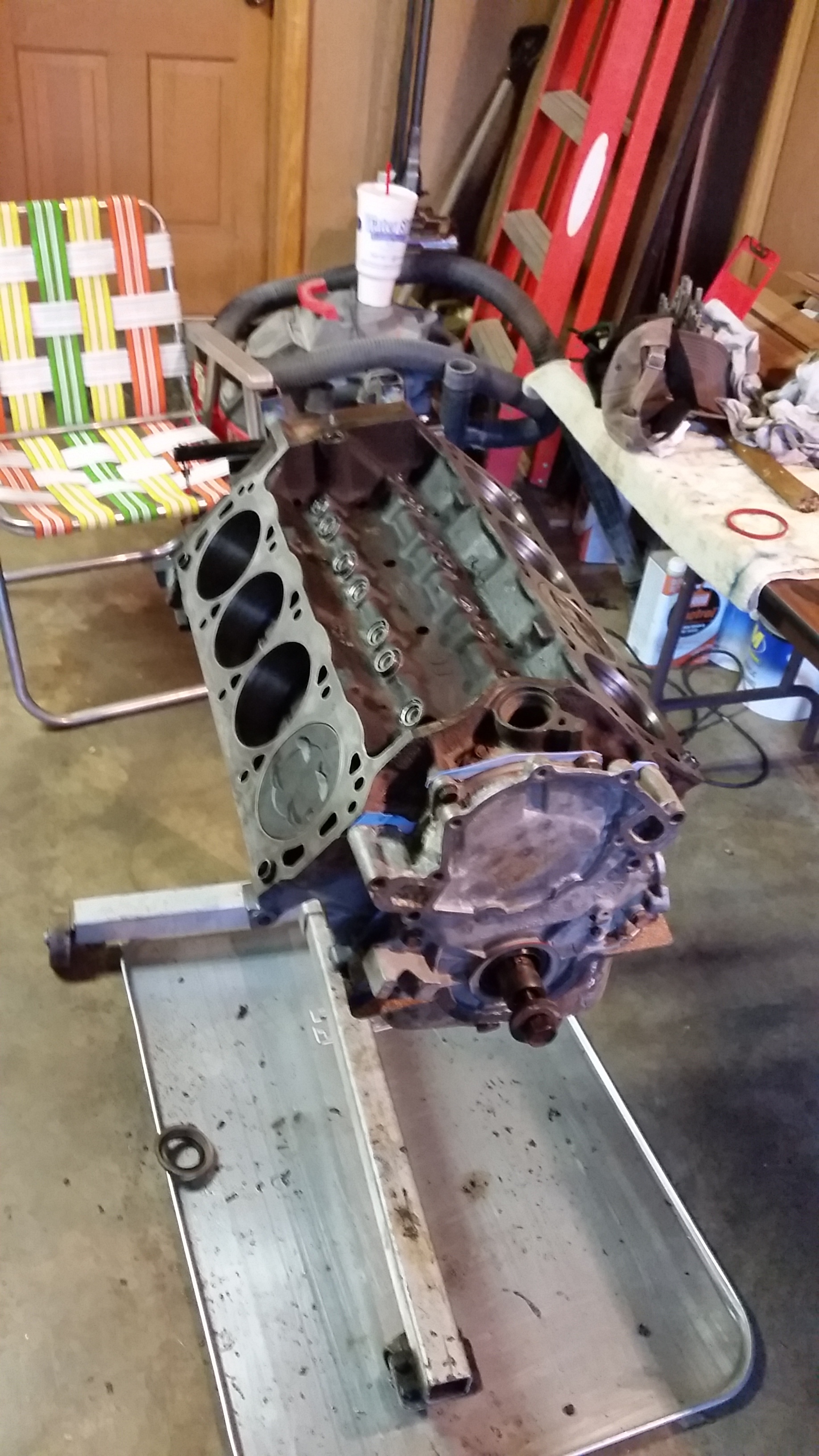

Motor build day! Jake got out there and finished cleaning stuff yesterday Then he started putting it all together. I helped and instructed. Short block looks good. Pistons are 0 deck which makes me happy. Everything went together smoothly except for the timing set. Apparently, I got one for an EFI engine. It has a raised section in the center that will not allow you to install a fuel pump eccentric. Not a big deal seeing that this car is set up for an electric pump, but I kinda wanted to have that option. Oh well.
He is dying to paint it. I just hope he does not choose a stupid color. Haha.
