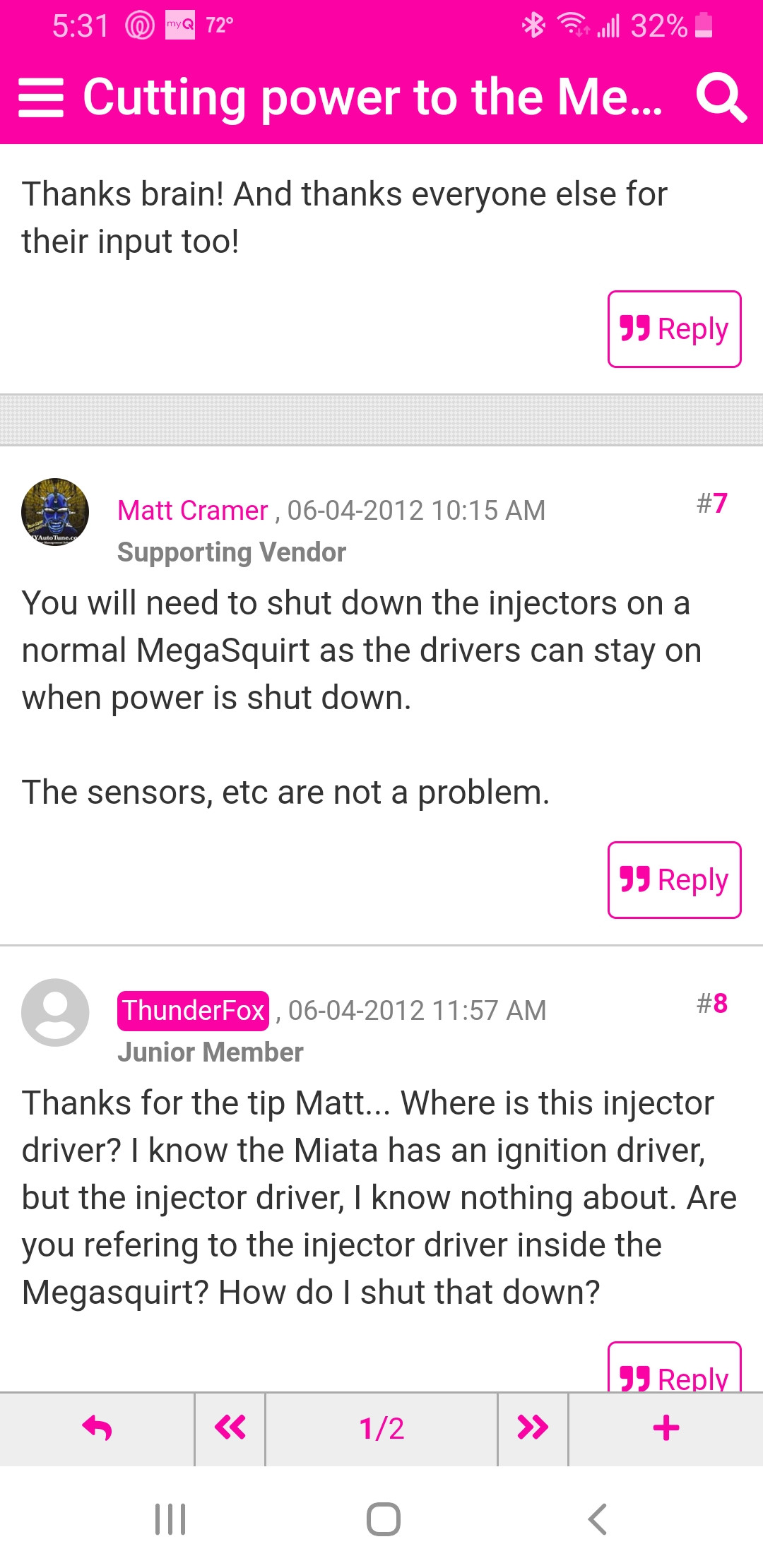

By having the injectors and fuel pump on a switch separate from the megasquirt, I think I have unwittingly created a scenerio where, if the pump is on and the MS is unpowered, one bank (or both) of the injectors can be "on". Injectors have a constant 12v to them and the MS just grounds them to fire. I may need to wire it so that the MS controls power to everything like it is supposed to.

All I need to do is run a wire from the existing switch to the fuel pump pin on the MS. That will let the MS control everything like it is supposed to.
Well, it ended up being more than just one little simple rewire. I ended up having to rewire three relays because I was having trouble with relays pulsating and latching and causing all kinds of electronic weirdness. The relays are all now wired like the MS schematics show and everything works as it should.
