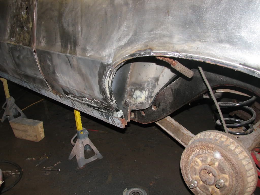

                            Finished the trunk lip seal area, kinda bumpy but I can make it work. Still need to do the filler panel to quarter right behind the C pillar, then this quarter is complete. The reason I havent done that spot is I need to rework under the filler so it sits lower, and I am procrastinating on it.
                            The quarter from the Tempest had some rust at the front edge of the wheel well, so I patched that with a piece from the front fender patches I didnt use.
                            The door lined up easy with the quarter, the gap is a bit wide, but I can live with it.

                                Todays work, finished the quarter panel, havent finished the grinding but the gaps are ok.

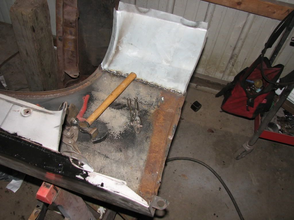

                                Got started on the drivers side fender too. There is an inner brace that was horribly bent and rusted on the replacement from the donor Tempest, so I needed to replace it.
                                Here is the brace, not welded in yet since I want to POR it first.
