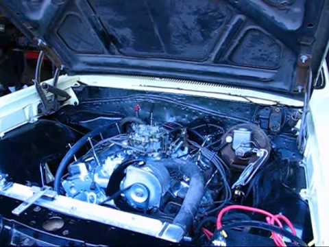

    Walt came by and shot some video after bleeding the brakes with me. Here it is, being driven for the first time in who knows how long.

  • Thumpin455
    replied
    MUAHAHAHAHAHAHAHAHAAHAHAAA!!! /evil laughter....
    It runs! IT RUNS! IT RUNS!
    Here is a pic after the first fire and the smoke was still rising off it.
    Leave a comment:
