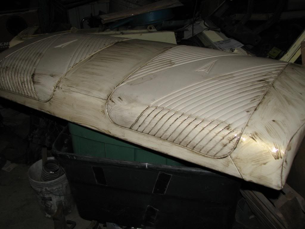

    Cleaning the back seat, it was nasty so some hand cleaner and a toothbrush were called into action.
    Still not great but lots better.

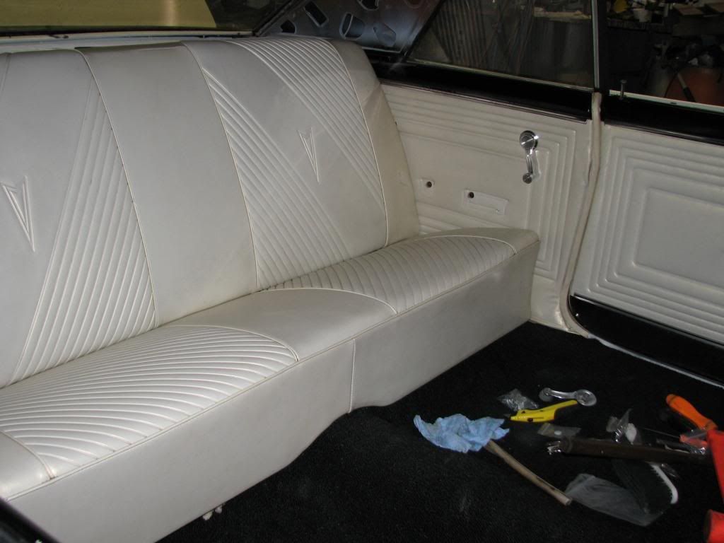

    Decided to just go ahead and get this done, even if I need to fix the rear window fitment. I can always tape off the interior or just yank the stuff out of the back if I need to reweld something. It looks damn near hospitable in there.
    Also got the rear door panels in, the fronts can go in tomorrow. The transmission is buttoned up except for the pan because I am waiting on the detent cable to show, might be in tomorrow (hopefully) and then I can put that thing in there and get the shifter connected. Then I wont worry about it rolling away or into things. I am leaving some things out because I want it running, the other small stuff can be done later once its drivable.
