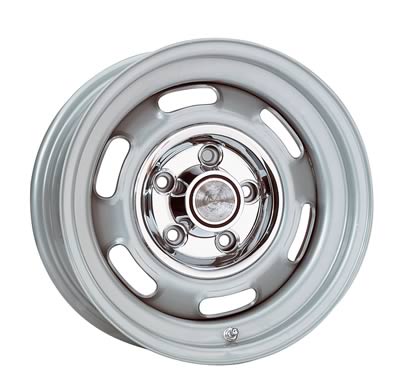

    The cheap wheels I ran on the 70 for ten years have an offset that puts them into the lip on the quarter. Even without the 275 tire it would still be set too far out in the well. So it needs a different set of wheels.
    So I ordered a set of these in 15x7 and it will probably get 225 or 235 tires depending on where the outer lip ends up in the rear.
