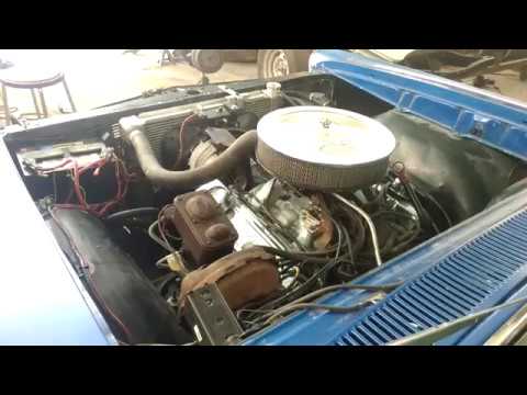

  • Thumpin455
    replied
    Turns out that fel pro head gaskets are not terribly fond of 13:1 compression. Had to swap my 670s on and lower the compression to 11.5:1 which killed some power, and dropped the mileage a bit, while making it quieter. The fix is cometic head gaskets, but at $86 a side, I decided to drop the squeeze for the rest of the summer.
    The paint is showing the miles, lots of spots on it. With light primer and the yellow under it, every chip stands out. Its still a fun car to drive, even if I am working on it more now than I want to. There are two others in the short time pipeline to be my summer daily drivers, so this one might end up getting some metal replaced, and massaged next year. For now though, Im running the valves again today and changing the oil on it after getting the street strip Formula driveable again.
    Leave a comment:

  • Thumpin455
    replied
    and to think, not to long ago that car was nothing but a VIN donar. Looks great!
    Thanks Joe. The GTO got an infusion of power this week, and yes it came out glorious.
    Leave a comment:
    replied
    Leave a comment:
  • Thumpin455
    replied
    Thank Jim, been a fun project. Hell of a grocery getter.
    Drove the Goat in around 4pm, had the 400 out by 6, and the 455 nestled in by 9. Finishing it off today. My hands are permanently dirty now.
    Leave a comment:

  • Thumpin455
    replied
    It's always SOMETHING, ain't it??!! Wish I lived close enough to come lend a hand but it looks like you've GOT this.
    Its a fun something. If I don't got it handled, it will not get done.. lol
    I feel like a 16 year old kid today, a kid who is sore from working out too much, but excited about MOAR POWAR going in my car. The 400/Th350 is almost out of the 65, and I have everything setup so it goes back together quickly. Doing some upgrades and improvements while the engine is out, mostly the fuel system, and checking everything under there again. might put the larger fuel pump on, it has a 225lph right now, and I have a new 255 in the box.
    I'm racing Ligget to see who can get the engine swap done first. Maybe next year we can see which is faster, the 390 or the 455... if I can make the Rocky Mountain Race Week.
