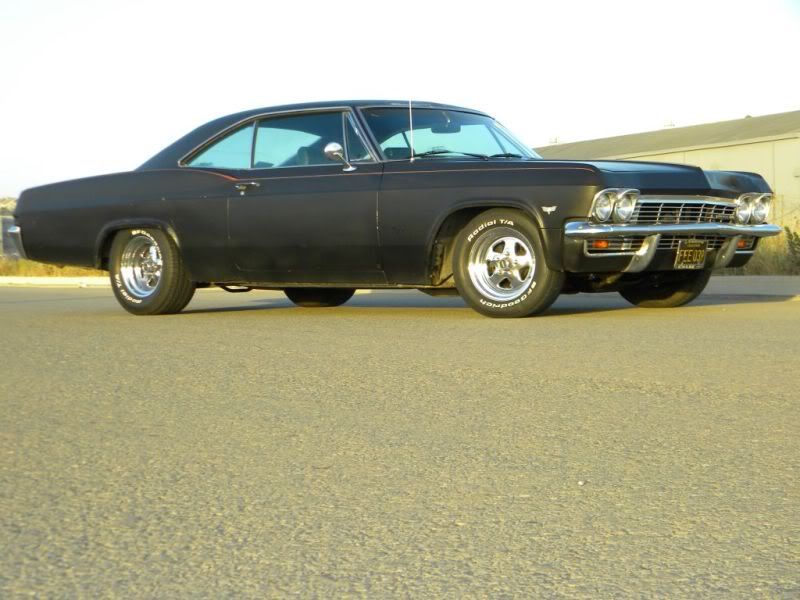

                #487
                Pic with nice morning light... Shows all the bad stuff quite well.
                  #488
                  I think it looks good.
                  Best time for taking pics is just before sunset, magic hour, where the sun is shining on the car. Even my car looks good in that light.
