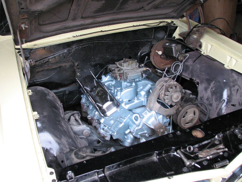

                  Its not "correct" but what on this car is? Painted the engine, added the valve covers from the 70, and had these silly T bolts laying around so I put them on it. Somewhere the alternator spacer was misplaced, its floating around here, but otherwise its getting ready to go back together and have a first start.
                  Sucks not being able to breathe and do much, but today and yesterday I felt a little better.
