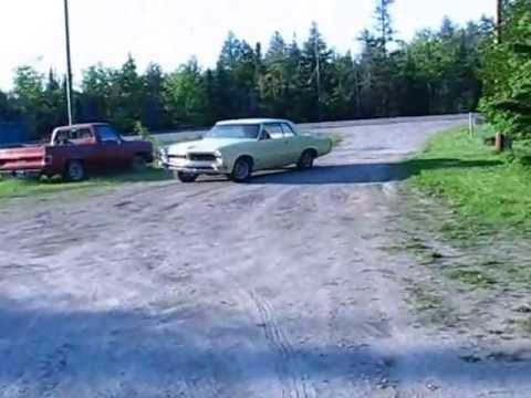

          Walt came by and shot some video after bleeding the brakes with me. Here it is, being driven for the first time in who knows how long.

            #635
            Motor sounds good, starter sounds a little in need of a shim or two.
            Awesome, by the way! Congrats on it's reincarnated maiden voyage!

              Pure mechanical music. Nice work and congratulations.
