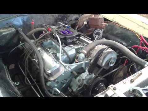

        It runs again, and that ticking is the bad header gasket on the drivers side. The O2 is in the passenger side header, and it is sealed up nice. So tomorrow I will fix the leak, and either get back to body work or pull the front springs and cut them to drop the nose a bit. Most likely both.

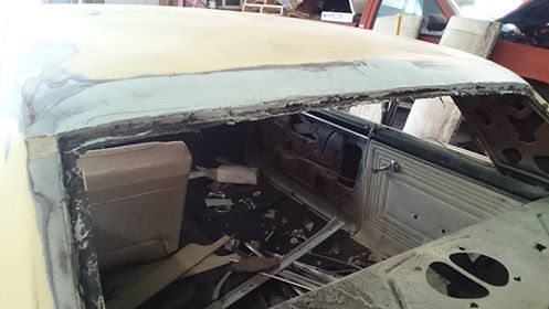

                  Well the car getting whacked was an annoyance more than a blessing, I had planned to redo the glass problem anyway. Since Dave decided to jerk me around last year, I decided that this was going to be my summer cruiser and parts chaser until I get a truck with a bed going. So I am doing it my way, for me, the way I want it to be.
                  Picked up the paint yesterday, man two stage gets pricey, but it should look freakin awesome. I used the lift to make the rear window fit, sliced along the channel to raise the roof panel high enough the trim will fit, and right now I am welding it back together. I get the welding done, grind it flat, throw some filler on there, smooth it out, seal it from the back side, and I can hit it with epoxy primer. As soon as that is dry enough to lightly sand, I can hit it with the base, then clear.

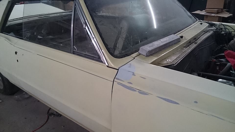

                        #761
                        Last of the body work is done, now to prep for primer and paint.
