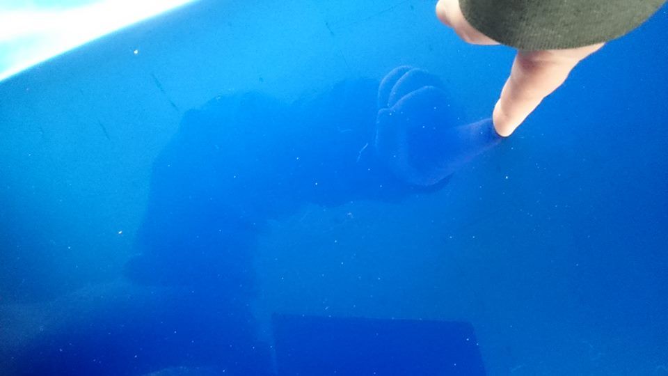

            The yellow was not for me, that is the second to last color I would ever paint something for myself. I think pink would be the absolute last I would paint for me. I like this blue, and it is looking great as I am cutting and buffing it. Found a neat trick for getting rid of runs. You slather some filler on the run, then sand all the filler off. The run goes with it. I was amazed that I didn't cut through the paint doing it, but damn was that easy to fix.
            Anyway, it is REALLY REALLY ugly right now, but damn if that hood doesn't look SWEEEET. My heavy cutting compound isn't very heavy, so I have to keep sanding with 2000 grit to get all the scratches out from the cut, damn lot of work let me tell ya.. It has to look like shit before it looks great. This car has looked like shit most of the last 30 years.

                The heavy stuff is done, found lots of little things wrong, but ya know what? Its a freakin driver, not a show car. I'll deal with them later, but it is annoying having something messed up.
                And its deep too! My friend I am doing the Cutlass for said its a nod to Michelangelo, "Touched by the hand of Todd"
                  #788
                  Could shave using that as a mirror!

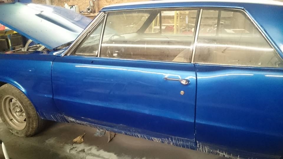

                    More sanding, more buffing, more buffing, and then more buffing, then some assembly. Gotta be careful how I take pics of you will see my ugly mug and break your monitors. This is the worst panel on the car, missed some dents and feather edges. Oh well, its a driver.

                      #790
                      Yeah I need to wash it now. In time....
