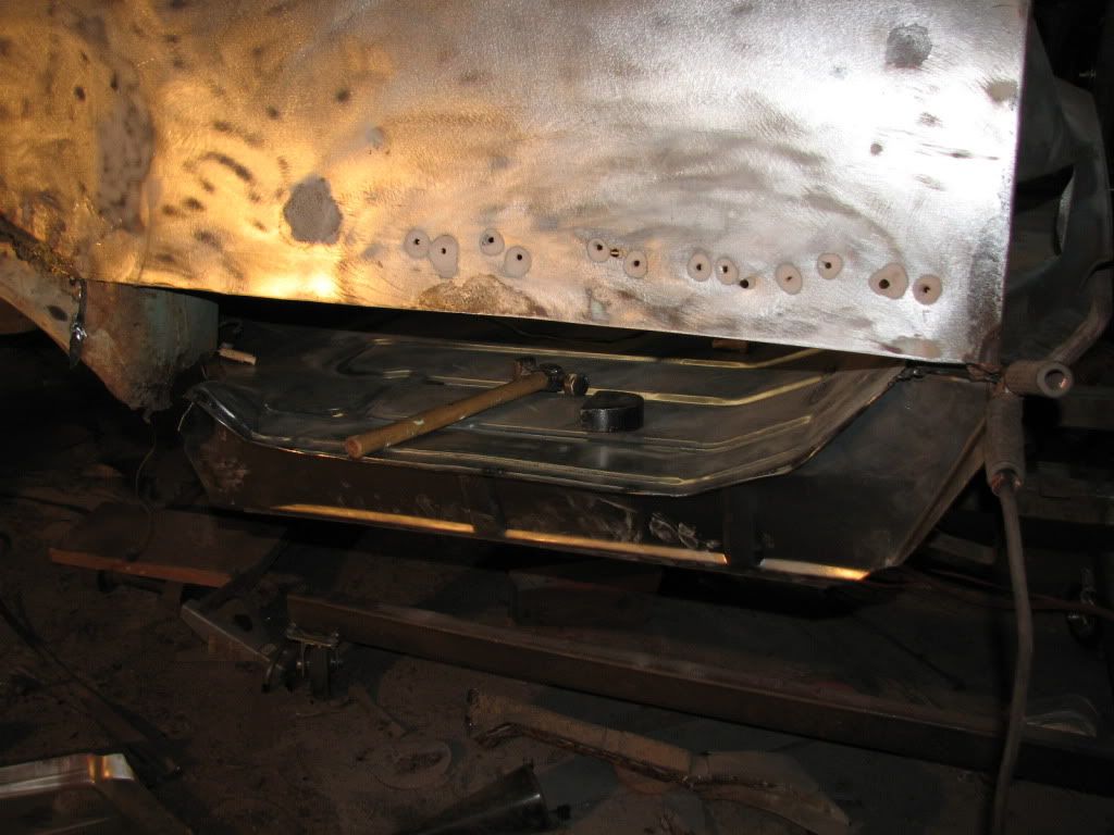

                      I got a bit more done today, yesterday all I did was bang metal around trying to get the quarter flat. To get the rear part in the right spot I figured why not weld the patch and drop in. Seems to have worked out good and the quarter isnt oil canned, so thats good. I measured the passenger side to the fender lip and the difference between the sides was almost two inches. Therefore I decided to make some adjustments to the wheel house and ended up cutting a wrinkled part out. I'll replace it with a patch from the hood. The second drop and rear patch went so much smoother than the first, since I had never done those before it makes sense the second one would go better.
                      The drop tacked in to fit everything.
                      The chunk of wheel house I sectioned out to replace tomorrow.
                      Before and after the patch.

                                Here's the latest, bumping dents doesnt show much so here are the welds I did. Also did some other stuff with the rotisserie.
                                A rust hole on top of the quarter cut out and patched, it was pitted around it pretty bad. Doesnt look as nice as it will, I didnt grind on it much.
                                And the patches in the wheel well.
