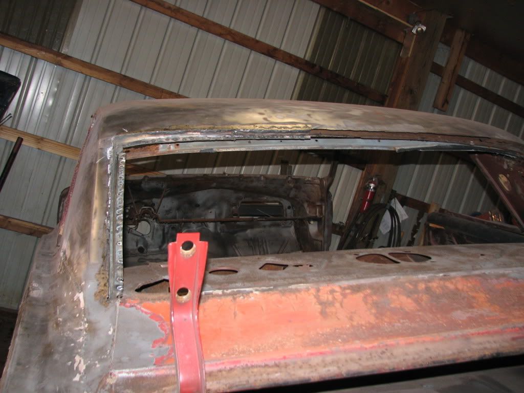

      Got some work done today that will show in pics, started on the rear window. Had to resurface my anvil first so I could get a nice straight angle first. Yesterday I cut some strips from another hood that had a nice body line through them, it made a very nice curved angle I could section and use for the window channels. I think the first part came out ok, needs some work but its nice and solid now.

        Do you have the glass for a template? Seems like that would help assure a proper fit when you're doing such a BIG repair.

            I dont have the rear glass, but only the outer channel was rusted away, so I am forming the new one to the inner. It should be pretty close and besides the windows in these cars use urethane or the cat poop sealer stuff and that takes up any large gaps pretty well. Also the trim can be used to cover up anything that I dont get exactly right, so I just need to get it close. I wish I had the back glass, it was gone when I got the car. I havent ordered one because I have no place to keep it until I am ready for it.

              Just need the part that has been on back orde for the bottom and the rear window is done. Well just a bit of grinding to do on the drivers side where I made it a tad thin. It will still take some filler but at least the windows wont leak water anymore.
              Also drilled holes in the floor pans so I can finish welding them tomorrow, after that and a bit of grinding/trimming on the seams then I will finish the drivers side quarter repairs. After that its on to the door jambs and the front window.
