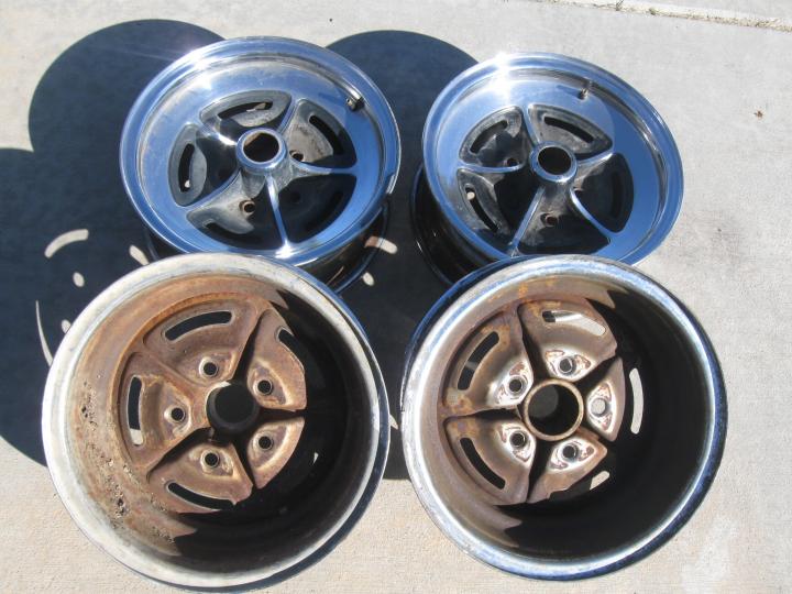

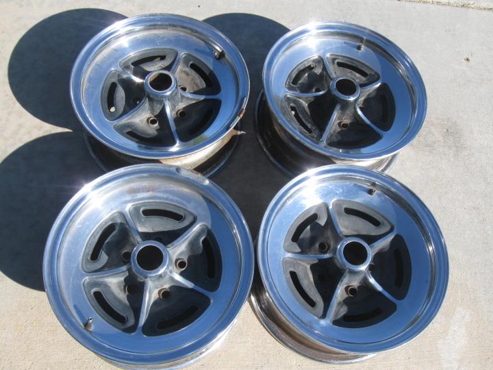

                    Just scored some '69 Riviera road wheels (15x6) which are mainly a stylistic upgrade however 68-69 road wheels are arched, like a Torque Thrust D, for 4 piston brake caliper clearance that the earlier wheels aren't. While this still might require spacers to fit, it's practically guaranteed to clear the F-body calipers and might clear the R32 Skyline 4 piston units. Either way happy to get them. Picking them up on Saturday and will get the brake caliper brackets made quickly so I can get the tires swapped over and the wheels on the car.

                    • No work done or pictures of the car sitting in the driveway but I did snap some of the wheels before I put them in the garage. Major score for $60 and 2 have already had the centering rings knocked out like I needed to do.

                      • Nice! I need to pick up two more for my drag radials. Currently the Centurion's rear wheels are two different tire sized steelies until I get the drag radials off it's rims.

                          Do you have the 15x6's or the Estate Wagon 15x7's? Not that the 15x7's are easy to find but they are out there.

                          Finally on the wheels.... HUGE SCORE!!! F-body calipers clear without a hitch, the 4 piston R32 calipers barely drag on the wheel and clear with a 0.125in spacer which will also take care of the tires rubbing on the frame. I'll be ordering the spacers once I finalize the list of parts I need to save on Summit shipping. I also have an early prototype caliper mount for the R32 calipers vs nothing at all for the F-body units. I am probably going to redo the hydroboost mounting since the pedal is very flaky and wants to bind with the short pushrod needed to mount the hydroboost directly to the firewall like the stock booster.

                          • I think they are 15x6". They all came off Centurions.
