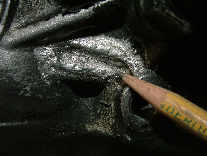

                                Back to the track, yeah but not for long...After the first easy check out pass and then a second balls out run I noticed a puddle of red fluid under the car. Turns out that Ka-Boom and brutal shudder also cracked the case of my beloved C4 trans. So out it came and over to my buddy Tim's shop to get tigged up....
                                V it out...
                                Weld it up...
                                NOW we were ready....
                                Stay tuned, more stories and photos coming soon......
