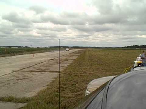

                #2 the track is ruff but the cheap flip cam and gps mount on the loose back hatch did not help any. (a guy from Drexel University got a video of this run from out side hopefully I can get it)
                #3 I am sure by now you can see the driver needs work as well.
