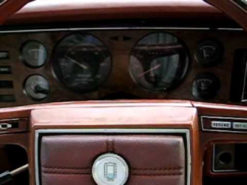

                        • Not a very good video but I will share anyway.
