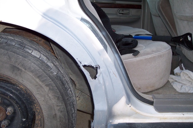

                well today i decided to touch up a tiny little rust spot on the dog leg of the merc as you can see in the top pictures
                well this is what it turned into
                actually is what it was was a bondo shoved into the hole (what is it with me and these half ass body repairs??)
                luckily it is not that bad and it was the only rust on the main body of the car. i also have a binch of metal from the GTX so going to my uncles tomorrow and see what we can get done

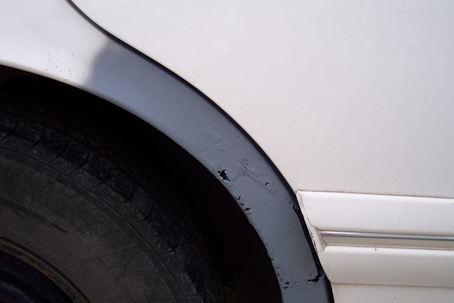

                  i decided to give it a go at trying to weld in a patch. figured the best way is to make sections instead of one giant piece.
Name:	merc rust2.jpg
Name:	merc rust3.jpg
                  this is what i have so far. i can;t weld and it kept blowing though the cars existing metal may not be the correct way but i will just cover it with a layer of synthetic lead filler
                    Its hard to say from this distance, but it actually looks like you are doing a pretty decent job of welding.......considering that it appears to be that you are welding to rust.
                    I hate to say it, but you may need to cut back further in order to get to some better/thicker metal. MIGs DO NOT like to weld rusty metal, it can be done, but you will experience what you are experiencing. A good welder can gas weld rust back into steel with lots of filler rod, but nothing will be flat anymore.
                    Overall, considering that there is likely thin metal with rust on the backside and inbetween double walled panels, I say you are doing a great job!
                    Keep 'em coming.

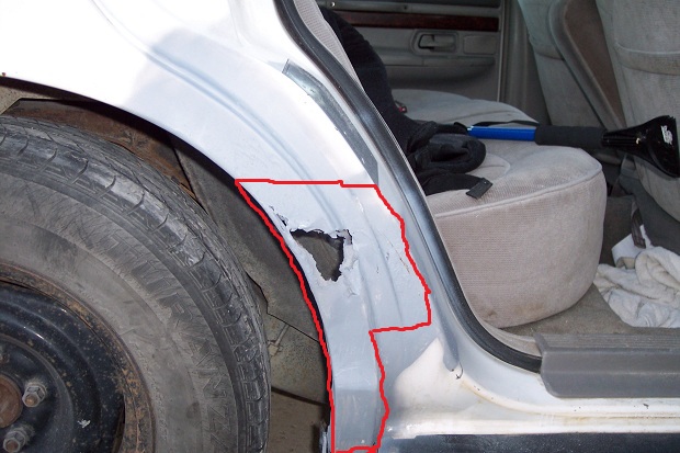

                      you are correct i am.
                      i am trying to find a dog leg from a parts car i can weld in but havinf a hard time finding a non-rusted car here in michigan
                      good news is i can use one form a 2011 vic or 2010 merc becuase they used the same body as the aero mercs. the aero vics had a diffrent tail end
                      • tardis454
                        • 3594
                        What side & how much do you need? I can see if we have anything...
                        • Mater
                          • 2347
                          passenger side
                          top of the wheel arch to the bottom the car. might not need that mutch but it's easer to remove then add
                          here is a pic.
Name:	merc rust section.jpg

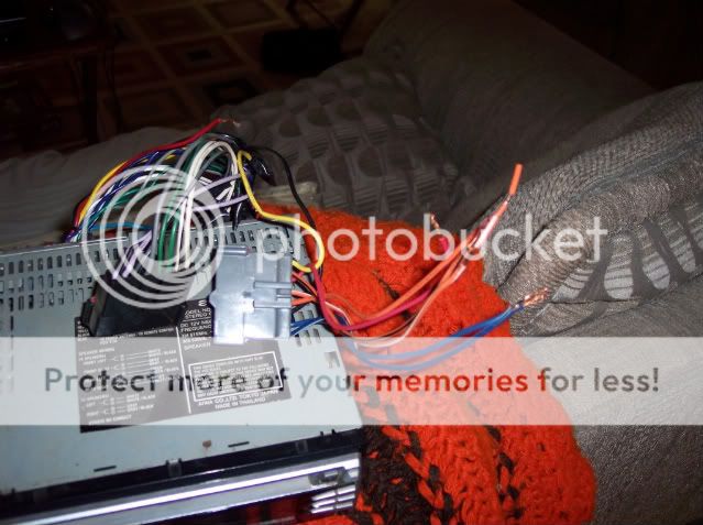

                            for the last 10 months the radio has not worked in the car. when i bought it i pulled this out it was not even wired in just though in the hole
                            the wood was the mounting "bracket"
                            the radio was not getting power and a bunch of electiral items in the car have never worked sense i owned it so today i decided to tackel the hacked up wiring harness left to me by Dade county florda police department
                            after 10 hrs of soldering, cutting, crimping, taping, and putting a kink in my neck fixing the hacked to hell and back harness i now have
                            1) funtioning automatic headlights i was not even aware the car had them becuase they where an option lol
                            2) the power out side mirrors now move
                            3) the digital clock works
                            4) the power door locks work
                            5) the keypad now works
                            6) the dome light now comes on
                            7) the factory security system works
                            8) i now have an actualy radio in the car!!!!
                            9) the strobes are now re-wired (still need a controler but they left the wiring and strobes)
                            10) got the siron rewired (agian still need the controler)
                            11) the wig wags hooked up
                            i now share Remy-Z's hatered twards wiring though and ex-police cars that have hacked up wiring they could of taken a bit more care in ripping there junk out
