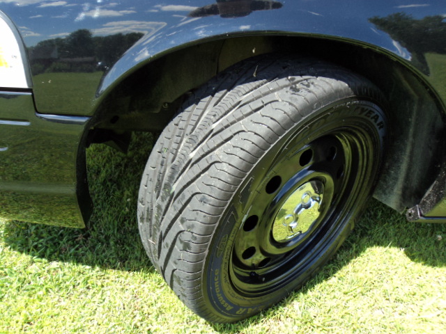

    The kid I bought it from took great care of it, as you can see. He just put four brand new GoodYear Police spec. tires on it a month ago-WIN!

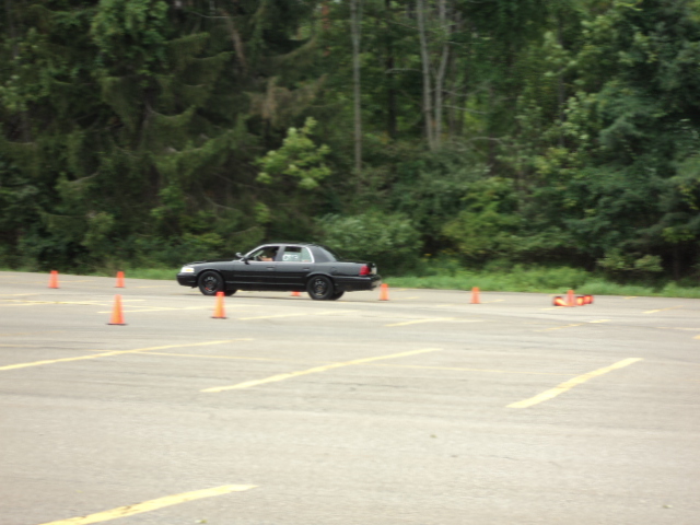

        And the best part, I already ran an SCCA Autocross with it today, running in G Stock, which had four cars in class, and I took second. Myself as well as a few guys that rode along on a couple of runs, were all shocked at how well this thing handles stops, and GOES. Tomorrow is day two of our regions 2 day event that we have every year, so I hope to take first with a little more seat time (then just driving it to work one day, and to the AutoX event today, only been 117ml behind the wheel since this Thursday when I got it.)

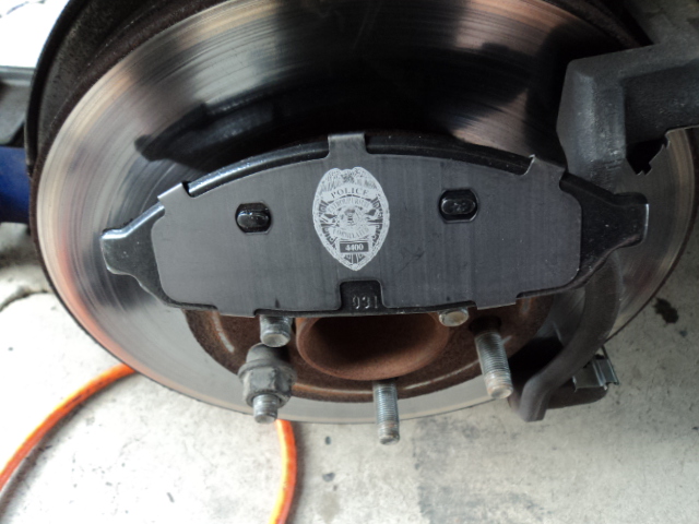

              I bought the Raybestos factory spec police car brake pads for it. This most have been what Elwood Blues was taking about when he said it had "cop brakes".
              The rear disc brakes are something I'm looking at to install on the rear of the Pace car, they're much bigger in everyway than 95 GT Mustang parts, and should bolt to the 8.8 Mustang axle without issue.

                        The Crown Vic rear brakes are a different style than the Mustang, with the park brake done as small shoes inside the hat of the rotor. An easier upgrade for the Mustang is this kit from FRPP for $190 that upgrades the base 94-04 rear brakes to the Cobra 11.65" ... brackets and rotors as needed for $189 all in, the calipers are the same.
                        Mustangs don't really need a lot of rear brake, because of the front-heavy weight bias. Do you have the 13" Cobra brakes on the front already? If not, I wouldn't suggest upsizing the rear until you do.

                            The 03+ cars are really nice and your '05 looks like it's in great shape. How did the car feel through the autocross course? I only have experience with my '02 and its outdated suspension, it understeers/plows pretty hard, lol.

                              only diffrence in brakes fromt he factory are the intercepotrs got full ceramic pads and the rear caliper piston is plastic instead or steel
