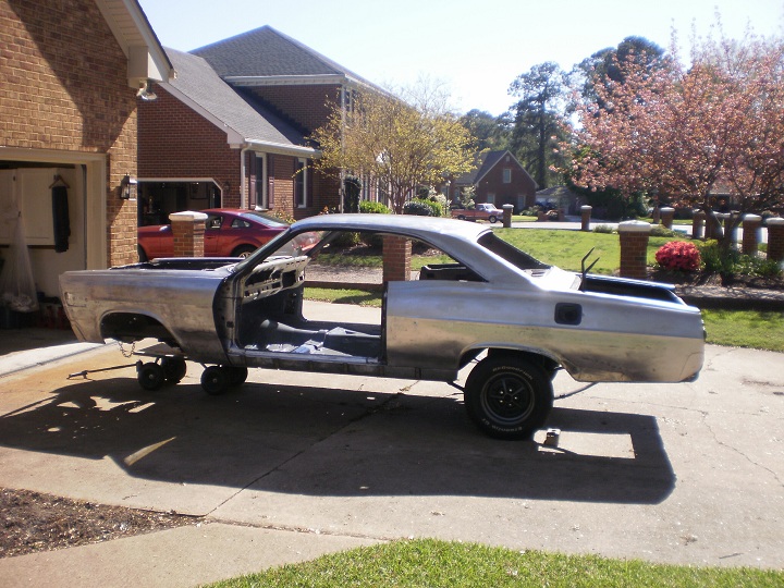

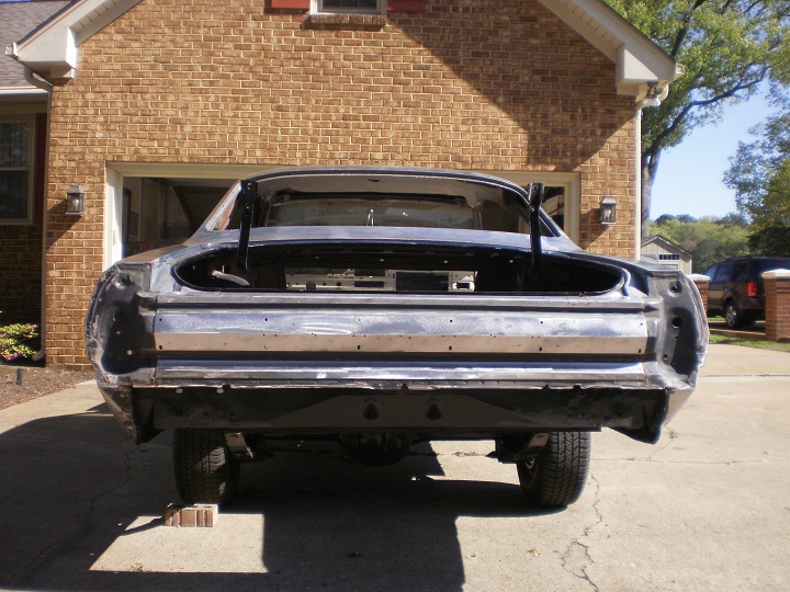

        • Shiny
          Just the doors to strip now. Neighborhood gentlemen are keenly interested, I spend a deal of time listening to 'back in the day' car stories in my driveway. Had three fellows here at once at one stage this afternoon. Nice, but disrupts the momentum.
          Michael from Hampton Roads

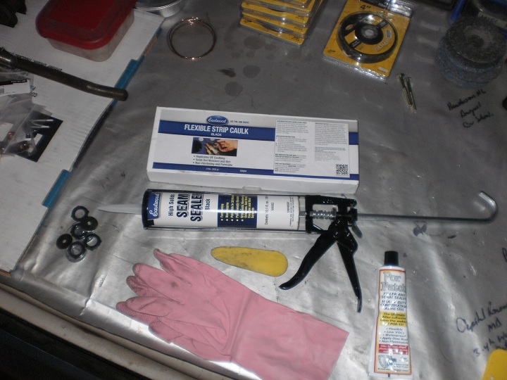

              • Seam Sealing
                Another chore I'd been subconciously avoiding but decided to tackle this morning. I started with three tubes of Eastwood Seam Sealer, two boxes of strip caulk and a tube of POR Patch. After two hours I'm down to 1 tube of seam sealer, three quarters of a tube of POR Patch and most of two boxes of strip caulk (only used the top layer in the first box; I'm thinking I bought way too much).
                Pressed one of the wife's oil painting pallette knives into service for spreading and shaping, a great little tool. Certainly better than my custom-shaped bondo spreader in the same role, which was pretty much a flop.
                Couldn't find latex gloves in a nice manly blue..maybe it's where I'm shopping?

                        • Seam Sealing Part 2
                          Now down to zero cartirdges of seam sealer, half a tube of POR patch, and one box of strip caulk. I am determined...THIS THING IS NOT GOING TO LEAK!
