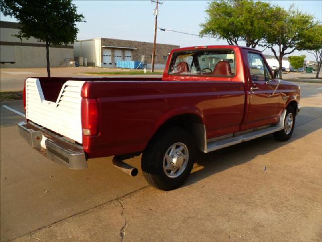

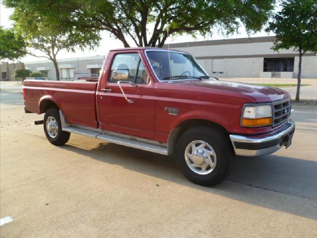

    It drives about like any 250,000 mile truck, maybe a little better. It got a gooseneck and brake controller. I'm thinking about trading my trailer for a lowboy gooseneck. What do y'all think?

    nice looking truck. best part is you can rebuild it down to its lug nuts and still be in it less than 25% of a similar new truck.

        In the most best kind of way of course - good lord - where's the rust?

                Like Milner said, where's the rust? Really nice looking truck, straight and shiny. Put a new seat and replace the rubber mat with carpet and you'll have a really sweet truck. How's it run?

                  The bed has some rust, I think it had a mat in it at some point. I'll get around to sand blasting it and rhino lining it maybe this winter if I don't sell it after doing my junk moving. I'm sort of looking for a Super Duty with a six speed.

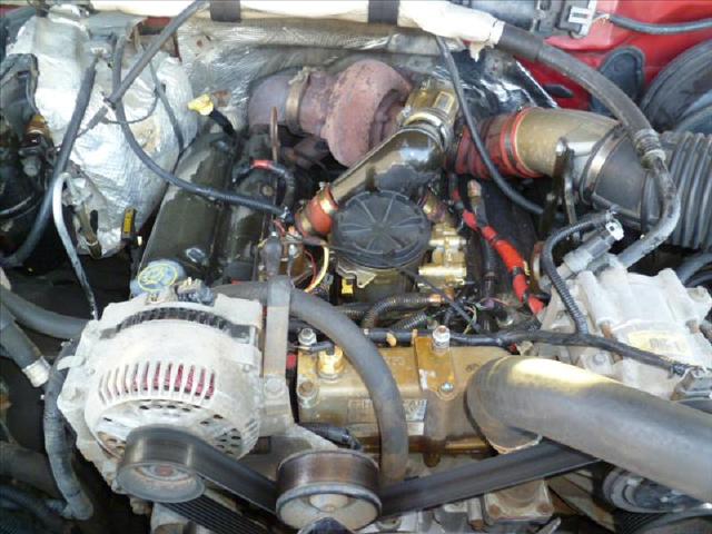

                              Ah, the joy of it all. Put the vacuum pump on, no drama. Bearings fall out of pump when I pulled the pulley off. Reman 100.00 pump, few minutes to get it back on. Clackety clackety, all is well. Run to the car camp, stop for fuel. MPG is down. Huge puddle under truck when I get though filling it up. Looks like a rear main blowout. F*.
                              Check oil, it's full. Check ATF, it's full. What the hell? The stuff is dumping out from the inspection cover / tranny. Oily feeling, but doesn't smell like diesel. Hard to tell though since I just filled it and everything at the moment smells like diesel.
                              I'm guessing High pressure pump. Nice. It's as good a time as any to hotrod it, right? I was in for a shock when I started pricing juiced up pumps.
                              Oh, the other thing I found this weekend that should have been a clue to buy a newer truck? Hypermax chip in the glove compartment. I apparently didn't see that when I was looking at it. I crawled under it before I bought it, it was pretty clean. Not super clean, but now I'm suspecting the low price came with prior knowledge that this bitch was about to eat itself.
                              I'll get a better look at it next weekend if I can keep from buying the bigger injectors and fat pump. (riiighhhht, or trading it in. )
                              At least the BRB didn't want a ride home this time, but mpg dropped to 18.5 pulling a trailer with the Fiat on it and spraying down everything under and behind it with diesel.
