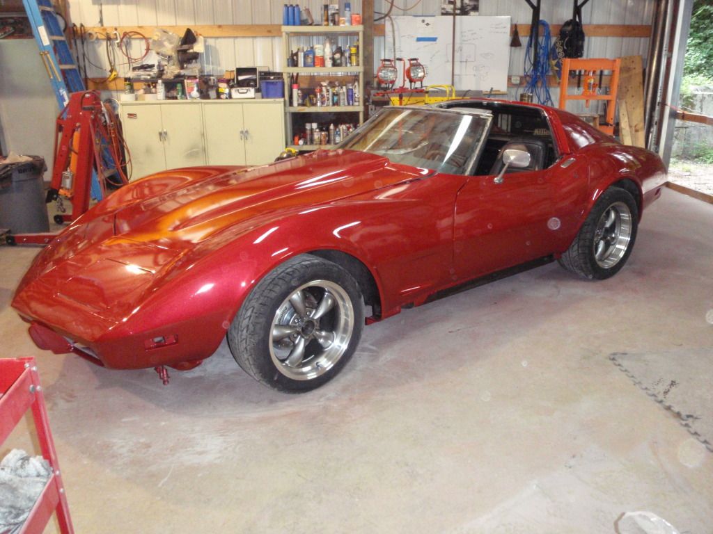

  • Correction John, in a painted Corvette
    • Wow! have you seen any judges lately?
        this morning - I did the spray at lunch
        • Looks great! amazing amount of work in a short period of time.
          • Man have you been busy. Looks great.
            • Nice!!

                Lunch break paint job! ... Damn!
                • dents in a fiberglass hood that's a new one lol

                      • so how do you like the summit paint? how does it compair to others?
                          I am NOT a pro, or even really think I've raised to the level of hack... but the paint went on okay - I made a mistake of not letting the car body warm up to 70* and having a crappy gun (more runs then a sailor with dysentary).... but, the paint was easy to mix, it looks good - although, the color needs to settle on its final form before I declare a success - last night it had a nice purple hue, this am, it seemed to have darkened a bit.... in short, ask me again in a week. In any case, I believe it was good value (comparable PPG was 4x more expensive).

                              my dad and I were talking about this stuff this morning, and he made a good point - the way to get the budget is to do it yourself. The paint job would have cost 800 in labor alone to have a shop do it. I could have been a bit smarter by renting a booth for 2 hours to paint it, but that still would have been $250.00..... plus, it's just a run or four - it's not rocket science shaving them down, color sanding, then buffing it back. Even if I pay someone to do it (not likely) it won't cost what the booth would have cost had I rented it myself....
                              also, when my dad was racing at Lyons, he painted his dragster (37 Chevrolet coupe) behind our house in, gasp, the great outdoors (granted, Lakewood California does not have the natural impediment of many places). he did the same thing when we moved to Oregon. It was 5 years after we got there before he actually had an indoor shop.... you struck a nerve because I get really tired of reading magazine articles, listening to "the experts" say it's impossible to do anything without a million dollars in shop equipment, or even having a "hired team" to build a car.
                              so, as the commercial says, just do it
                              • From here it looks great . When you painted it did you do the usual , drape the shop in plastic , big fan and filter at one end of the booth and wet the floor ? , tell us your secrets !
