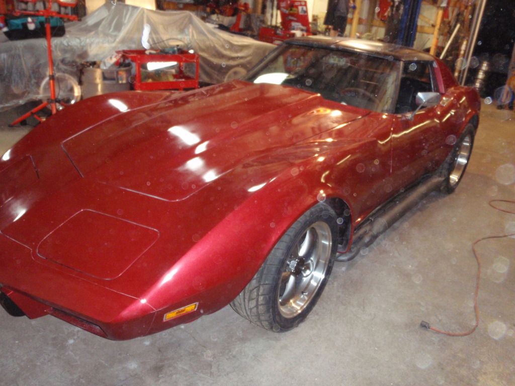

                okay, so first up, I'm a rank amateur at this - seriously, first time from prep to buff... however, I have good help from my local wesco paint store (expensive, but worth it)... anyway, a few things I learned
                1) you don't need to start with wet sanding. 400 grit on a DA will save your arms - WITH THAT SAID, AND IN CAPS, WHILE I'M AN AMATEUR I'VE SPENT DECADES BUILDING, AND FINISHING STAINLESS STEEL KITCHEN EQUIPMENT so please, it's not easy - but it's also something I've been doing since I was knee high to a grasshopper.... and it helps with touch and using power tools
                So I started with 400 grit on a DA and knocked the tops off the orange peel.
                down the center of the hood is what the 3000 grit looks like after a pass or two
                I learned the hard way that if you try corners, the edge of the sandpaper digs into the paint and leaves glue that's exceptionally difficult to remove.... ug... that said, as it doesn't leave the mess of cutting and buffing, it could be a real time saver if you're part of the "let the clear breath cut" finisher and the car you're working on has large, flat surfaces....
                then I used 3000 grit on a polisher (yes, 3000 grit and good lord is it spendy - $10.00 per pad) mostly because I don't have a hook pad on any of my DAs (remedied soon).
                A warning about 3000, use only on flat surfaces - but on flat surfaces, when finished, it seriously looks like the first cut of a cut n buff
                and where it sits now
                it's not perfect, I could spend a lot more quality time with 2000 grit and water to completely flatten it out... but I simply don't care, the paint job was another learning process, and if I make the clear coat perfect, it'll simply draw attention to the paint job (not good)
                hopefully tomorrow night I'll finish the top then I can get busy with 500 and up on the sides

                              • well, that hurts, a lot, but it's now color sanded, and cut and polished.... will remove the swirls and wax it later... much, much later
