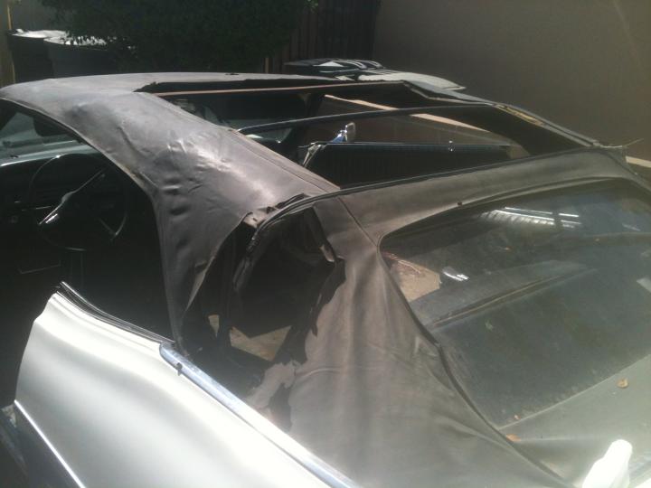

                            Hey hey!!... New carpeting and a new convertible top have arrived via the brown truck! I love that guy... I've got stuff to work on now for Saturday. Oh, I'm not gonna attempt the top install, I've got somebody lined up that knows what they are doing, but not sure yet when he can do that... Pictures on Saturday..

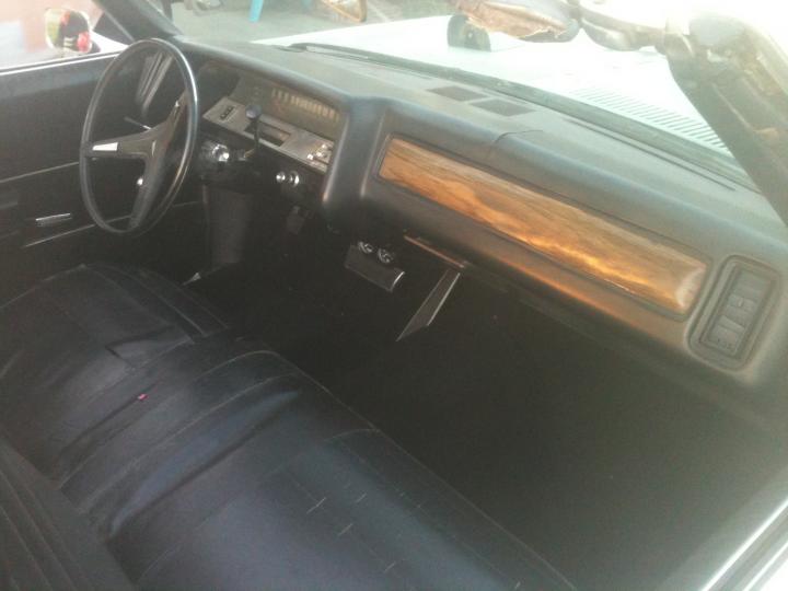

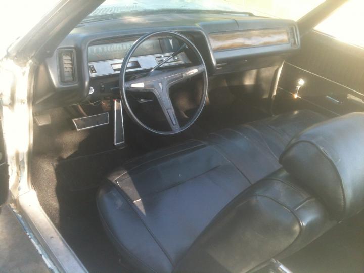

                                Alright, the new carpet is in. Makes the interior feel and look a lot nicer. The removal of the back seat was fun, another treasure trove of acorns and mouse turds. At least I'm working towards making this car a "turd free" zone. I think that was the last hiding place. Unfortunately, there was a hole in the floor back there, so I hit it with some rust buster stuff and patched it. No, not the right way. I couldn't get my welder out of the garage since the Mustang is up on jackstands with no rear end in it. So, I fiberglassed it. It fixes the hole for now. Then, after the carpet install I went to get 2 new Radial TA's put on the front so they match the back tires. I hate mismatched tires. Tomorrow I have an appt to get the new top installed, so I'm gonna have to call in "sick" ;) I can't afford paint right now so I'm going to have to touch it up in the drive way myself. I think I'll get rid of the blue and just make it all white for now, save money for paint next year I hope.
