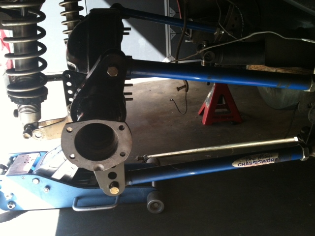

                      I've been driving the Catalina around quite a bit now, to work several times (70 mile round trip) and it's a great driver, although gas milage is pretty horrible, around 10-11 mpg. However, I can live with it. The master cylinder started to fail though so I needed to take care of that this Saturday. Pretty painless overall, only required 1 return trip to the parts store (apparently there are 2 different types of boosters that were used). Cheap too, only about $20 for a rebuilt unit. Cool deal. That gave me time to get to work on the Mustang. It's not really a project car, so I don't think it needs a separate thread. I've been slowly building a narrowed 9 inch rear to replace the blown up 8 inch unit, and got the housing bolted into the car yesterday. Everything fits fine, and I threw in the old axles temporarily just to get the car rolling. The only issue I ran across is a problem with the bolt holes on the 4 link brackets. They are larger than the holes on the old brackets so the bolts flop around. No good. I didn't notice this until now. So, I guess my fix is going to be to get some thick steel washers the proper size and weld them to the bracket on both sides to reduce the bolt hole size. Anybody see anything wrong with that?

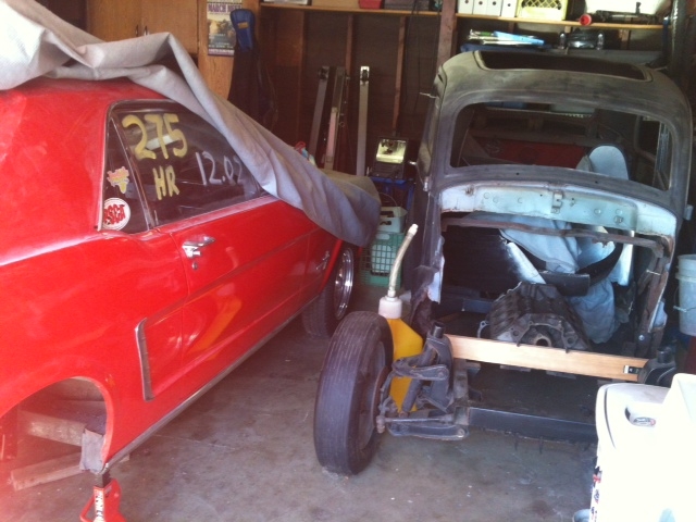

                      Anyway, heres a couple of photos from yesterday. The Mustang sees the light of day for the first time in about 7 months!

                        Lookin' good! Were you happy with the job Sutton did on the rear end?
                        Cool that the Catalina's getting some use. Now what's the story on the Anglia? in the garage

                          Sutton did a fine job on the housing. No complaints. Just don't be in a hurry, Lol! Took 3 weeks, and I had to push for that. Now, the Anglia is the next project car in line. I acquired it 2-3 years ago and I'm hoping to start doing some work on it next year. It has a narrowed Olds/Pontiac rear with ladder bars in the back and what appears to be an Opel front suspension. I have a fiberglass front end and rear fenders for it. Plans are to run it at Nostalgia events.

                            anyway you could get some stepped bushings made up you could weld into the holes?
                                Hmmm stepped bushings are a good idea. Wonder where I'd get some of those?
